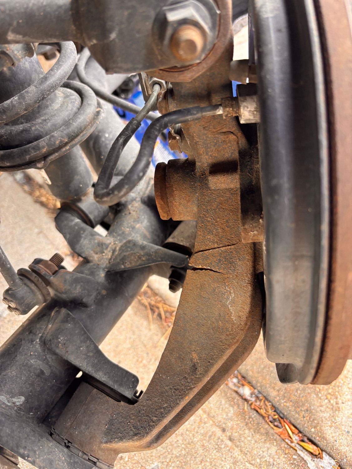

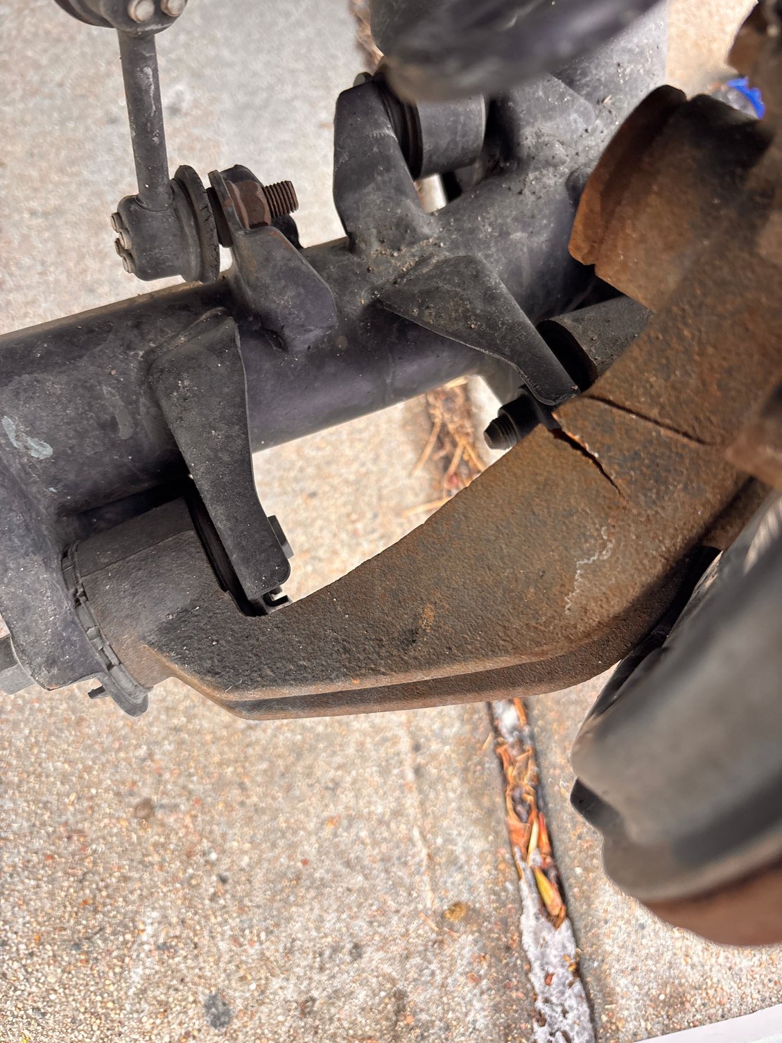

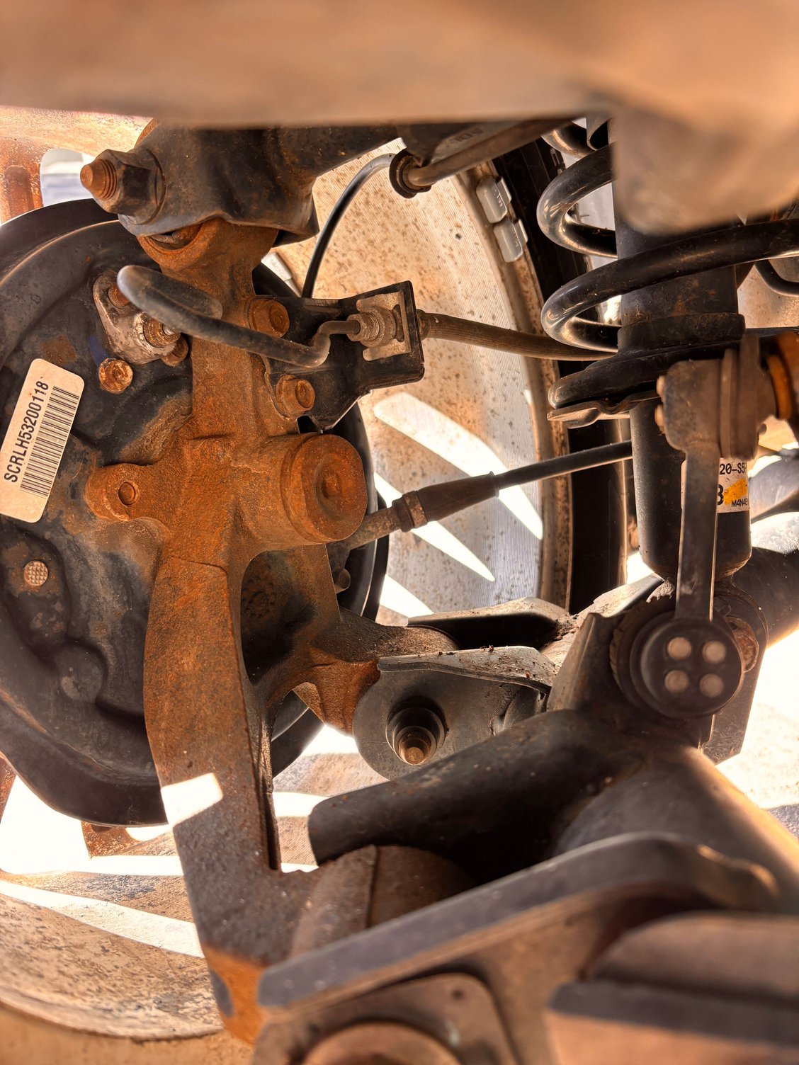

Good morning. My son was drifting in the snow, slid into curb and busted this piece (passenger rear) on our 05 civic EX coupe. I went to Honda parts and they couldn't tell me what it is, which is odd because that is what they do. I have been told it is a rear lower control arm, or a knuckle assembly, or something having to do with a spindle. Anyway, I wanted to replace it myself, but I cannot find this part ANYWHERE. Rock Auto and autozone dont have it. Can anyone clearly identify this piece and then direct me to where I could purchase one? Don't know why I'm having such a hard time, seems like it should be a common part of a very common car. Thanks for any guidance you can give

Junkyard or dealer. Not something that is typically available aftermarket.

knuckle.
https://honda.oempartsonline.com/v-2...ear-suspension
