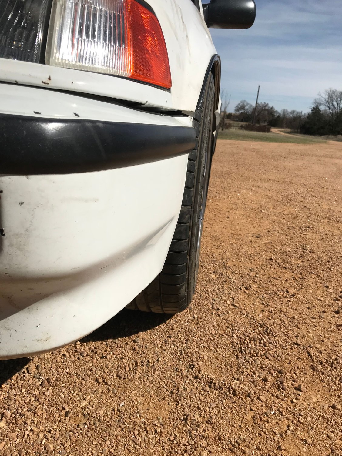

Front driver side with how the tire is suppose to sit
Hard to tell but it has a lean to it.
Had a small accident ended up hitting a ditch on a dirt road avoiding to hit something lost control. Went to get my car aligned today they said my trailing arm had a dent in it and my drum bent in. I am trying to find a decent set so I can just replace it because it’s OEM and OLD!

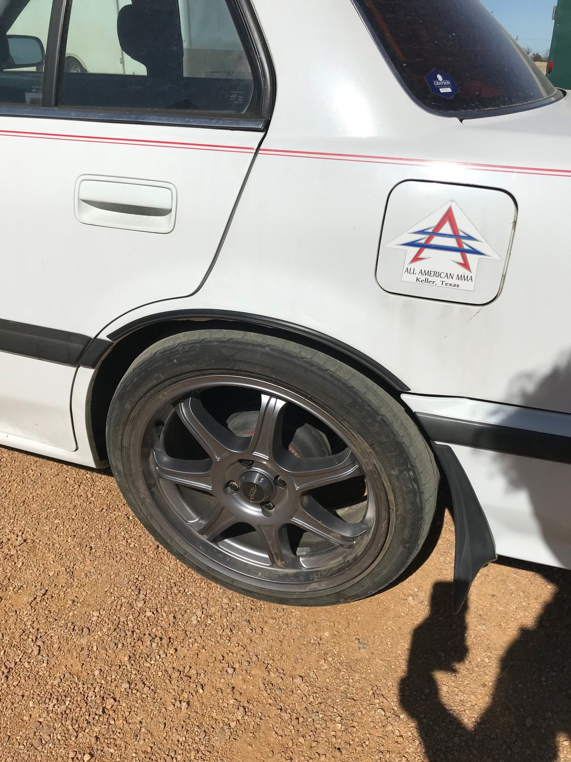

Rear Right
Rear left (bad one obviously). Do I need a whole new trailing arm?!?
Old Mar 21, 2018
Re: 91 Civic trailing arm & drums
I'd want as big a chunk as I could get off a good car.
Get everything you can get, take what you need, chuck the rest or save it.
Ya never know if stuff will come apart easily or be seized up
The arm itself
all the links you can get with it (upper, lower, and front) and all the hardware
knuckle/hub/brakes/drum complete
