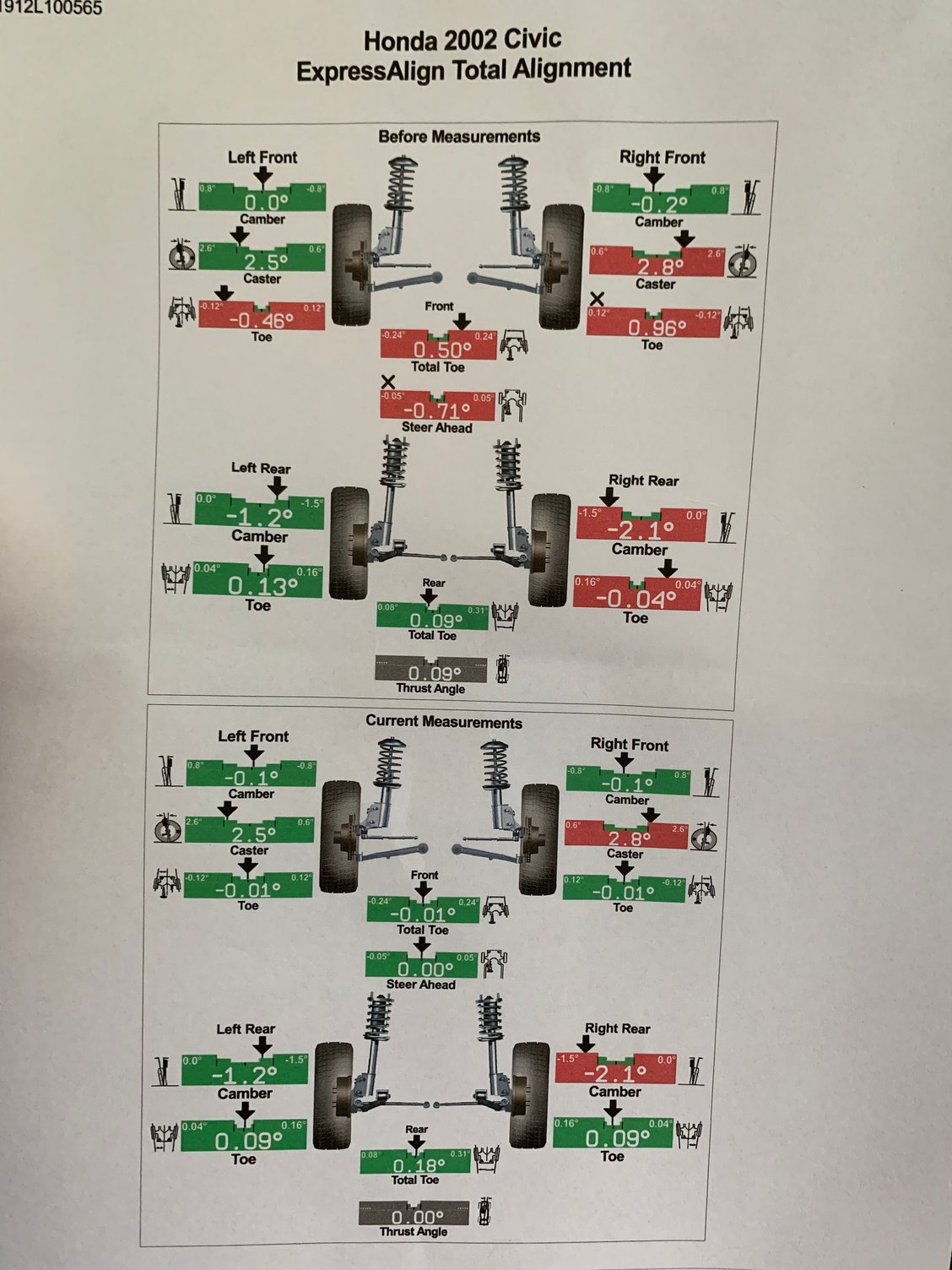

Let me upload the newly alignment print out
so the front right is what I’m talking about. The back wheel just to get upper control arms that are adjustable.

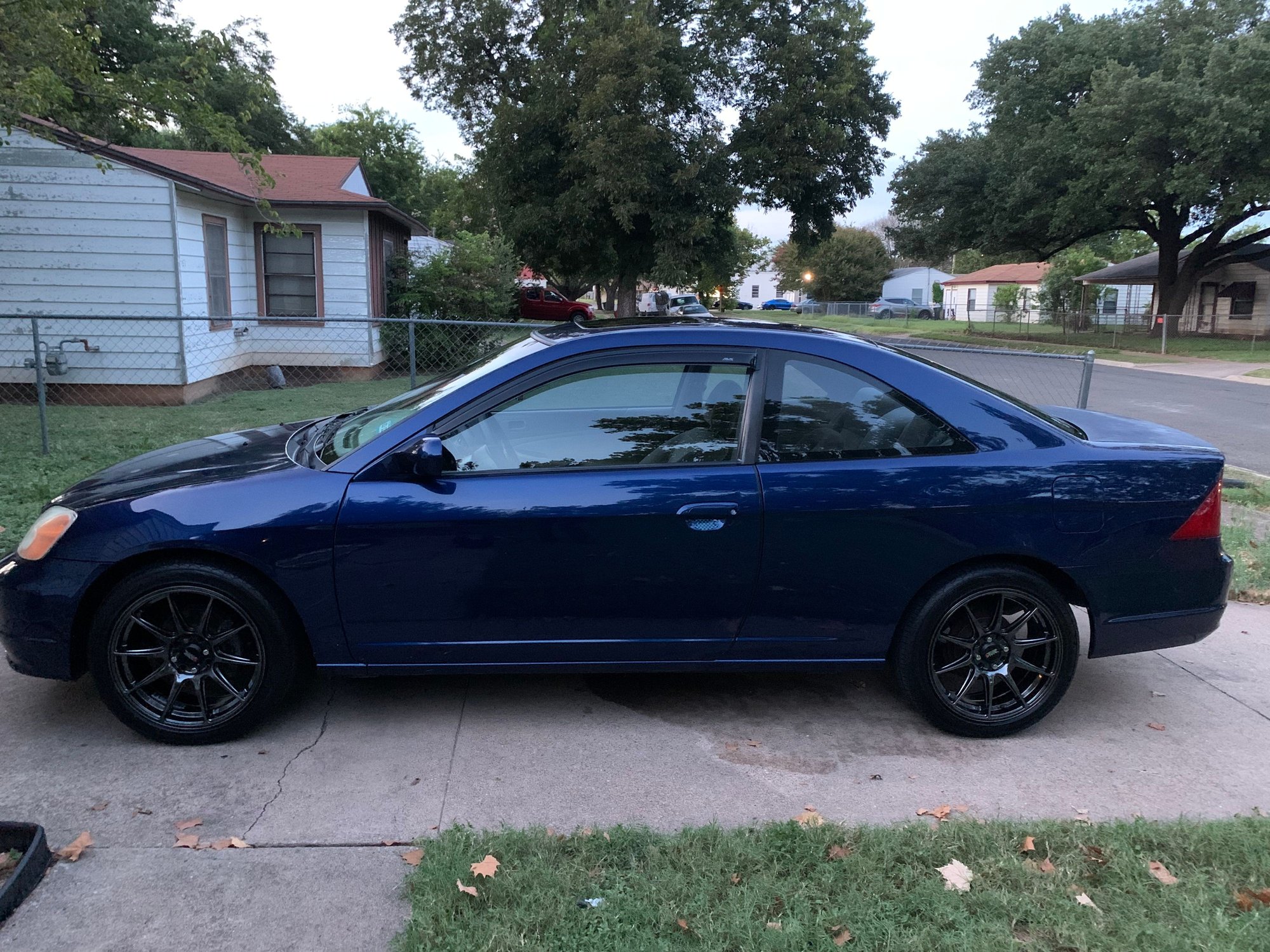

Pictures of the car?

This is the car. 7th gen civic, 1.7 Lt, 4 cyl.
the alignment was done in the same time I uploaded the picture of the alignment. So the front right wheel push towards the front than it is on the left wheel.
I don’t know if it’s the subframe or the spindle but that’s not normal.

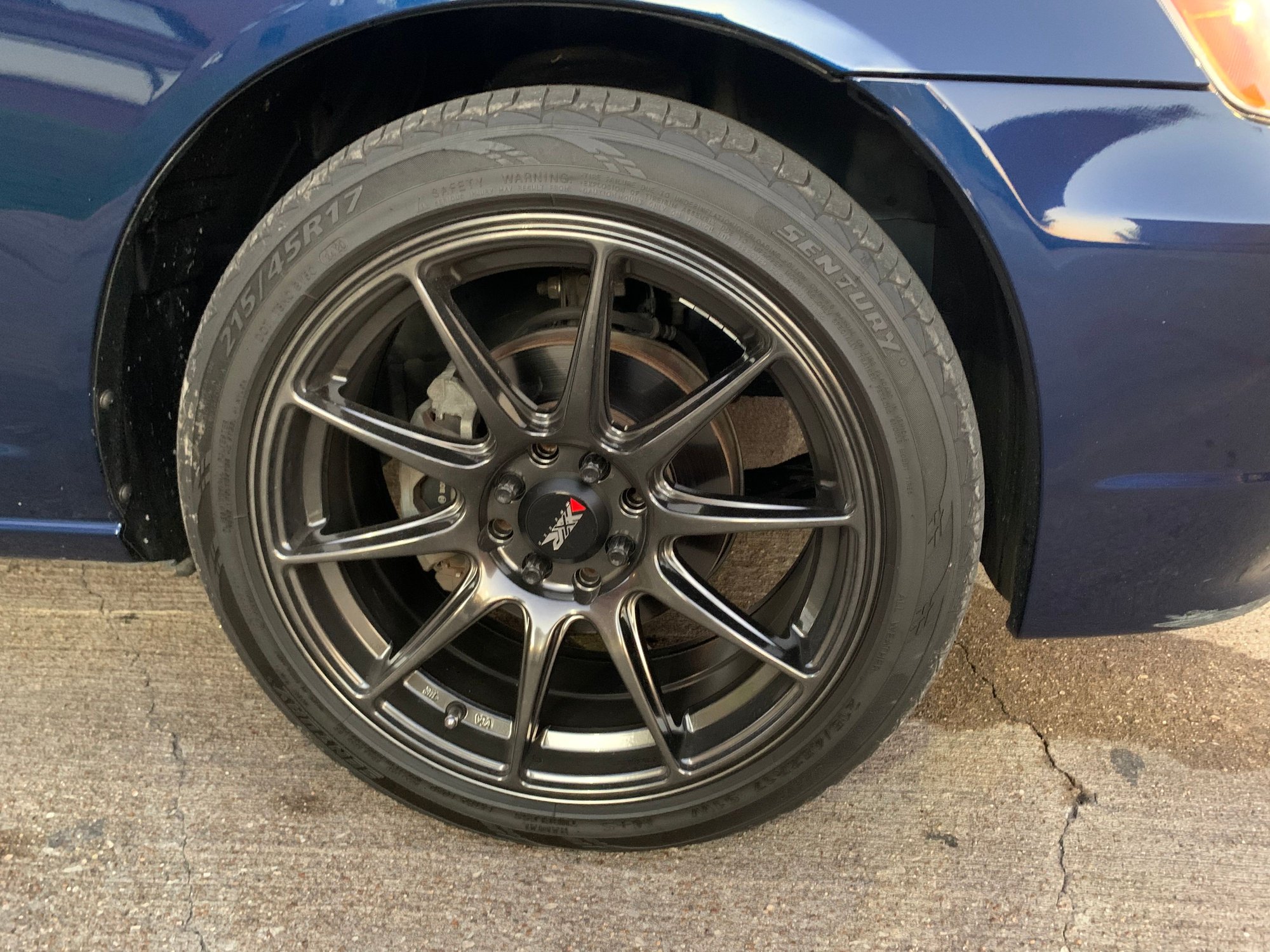

From what I understand, you’re having issues on the right side. Not sure why you’d post a picture of the left side.

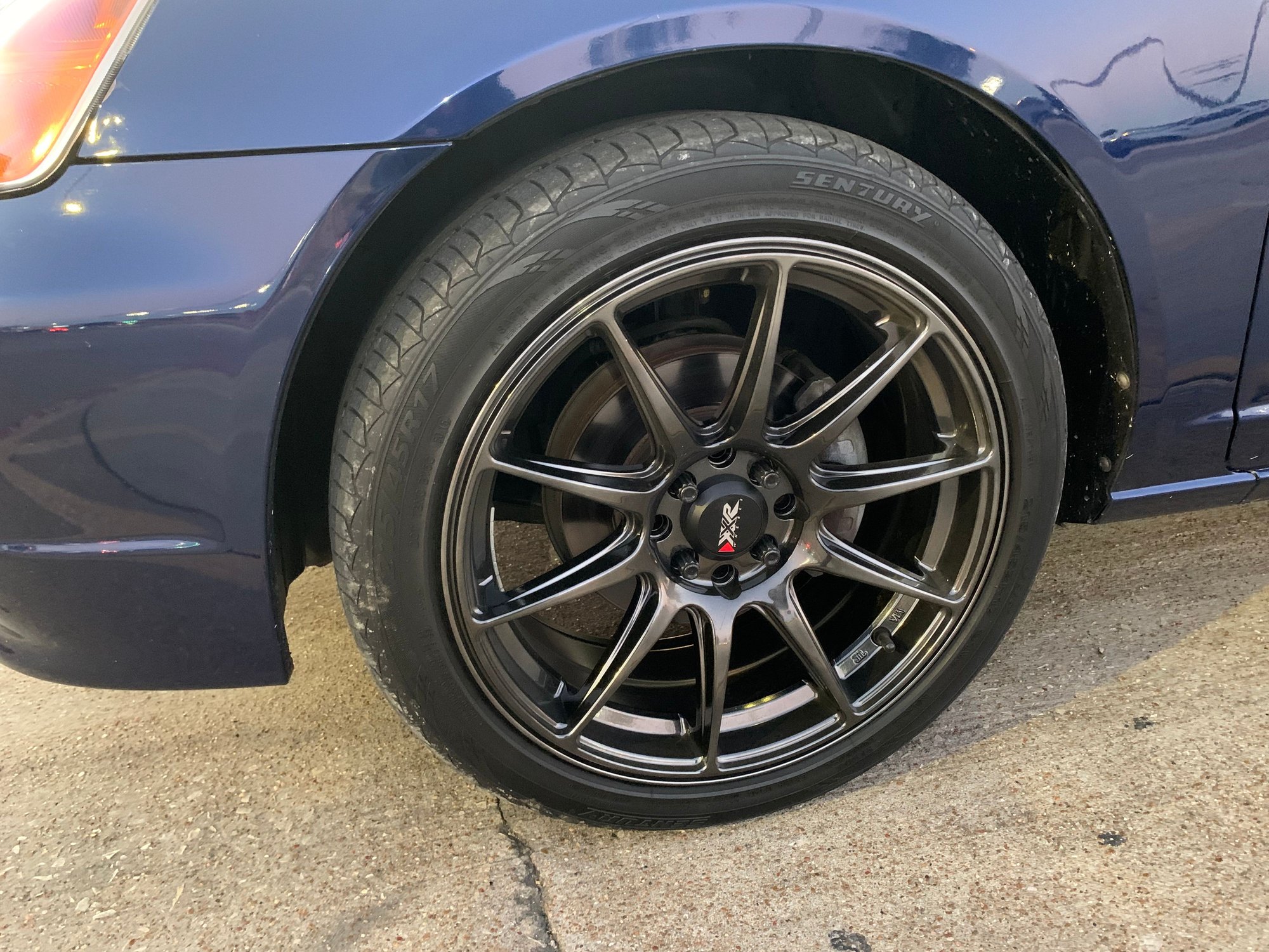

my bad, I should’ve known it’s the right side to send. BrotatoChip ask for a pic but I should’ve known that it’s the right side I should’ve send.
the fact that this is a suspension thread, can I mention something about my fuel system on here also?
the bottom one is the affected side but I just took two pictures to show the difference. It may not show much on picture but in person it really shows. Two alignment shops told me something isn’t right. The last one I just went to about two weeks told me it’s something wrong with either my spindle or my shocks or something but he couldn’t really say.
looking at these two pictures you can see the big difference of the two rear wheels. The wheel on the bottom is the affected wheel. my mistake when I said the it’s the right rear wheel, it’s the left rear wheel and the right front wheel that’s affected.
