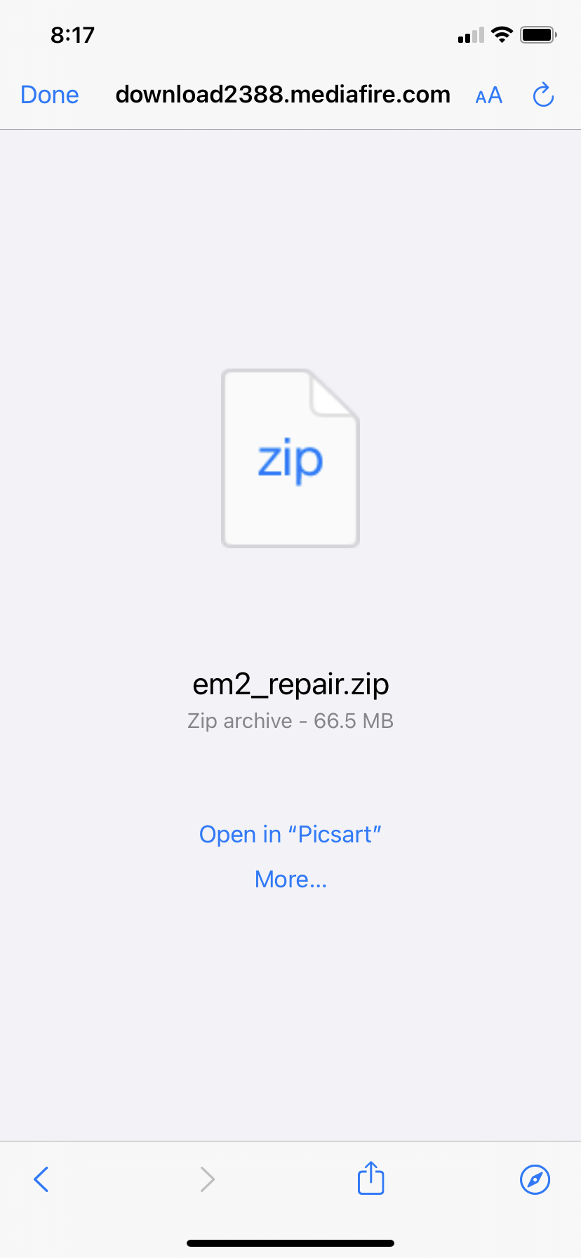

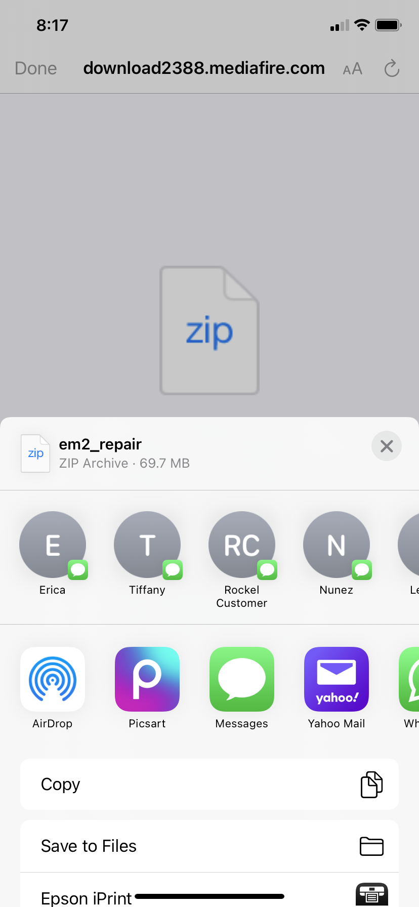

So after I opened the link, it shows links for some 7th civic but the one I click on for me it won’t give me option for any pdf instead it shows zip and under zip it shows open in a picture app I have on my phone so it won’t work for me.
These are what I get after I click on it so it won’t work
Old Sep 16, 2021
BrotatoChip's Avatar
Super Moderator
Joined: Jun 2012
Posts: 5,073
Likes: 2,096
From: Ohio
Rep Power: 224
Re: Slappy steering
You have to unzip the file first, inside you will find the service manual. Not sure if you can unzip from a phone.

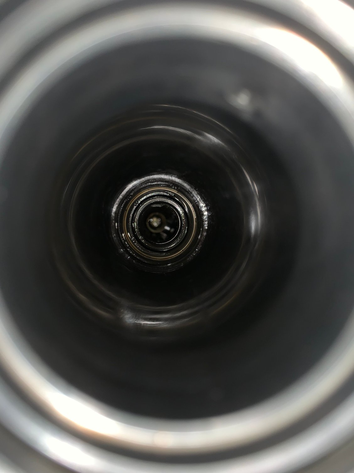

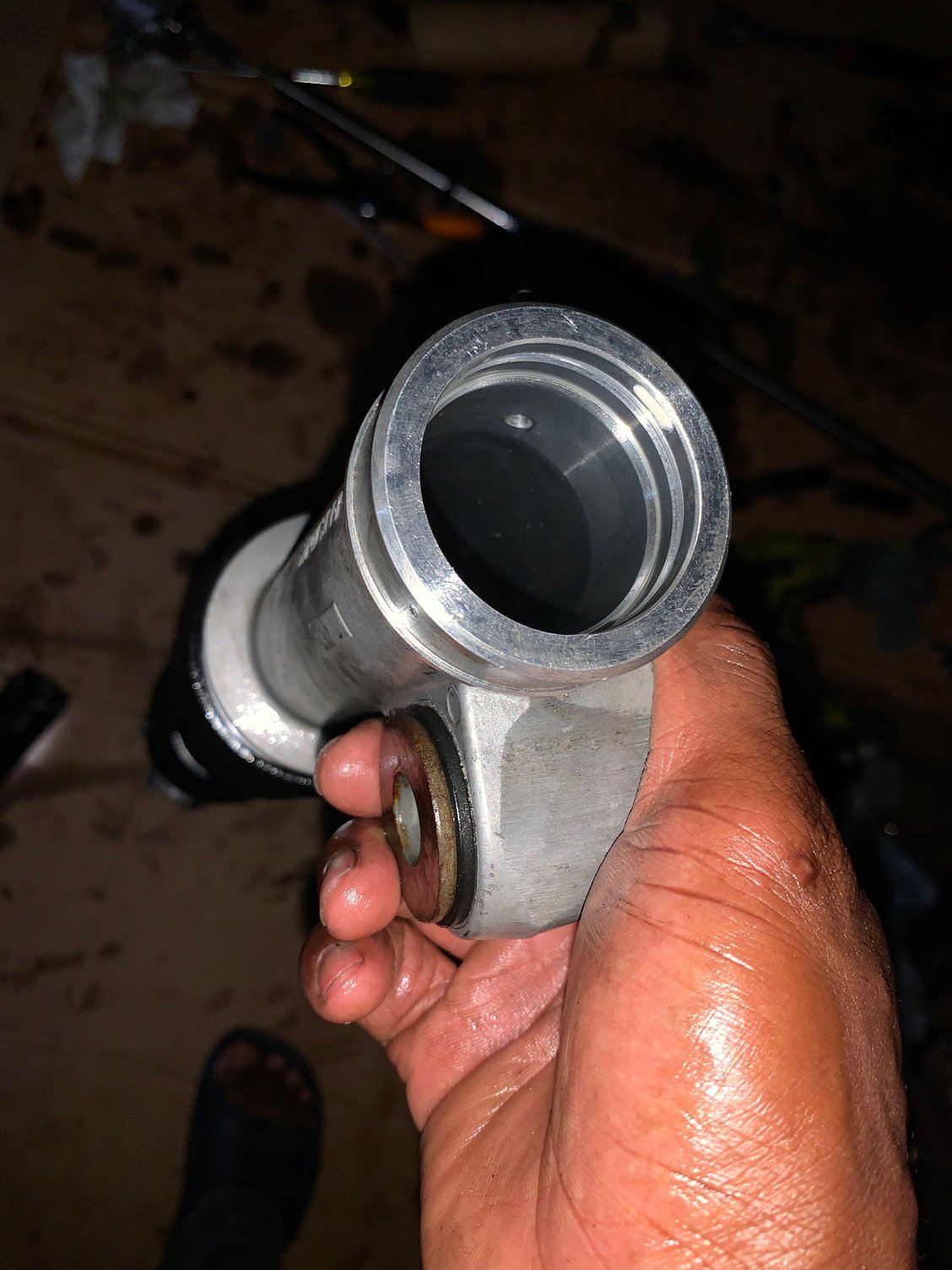

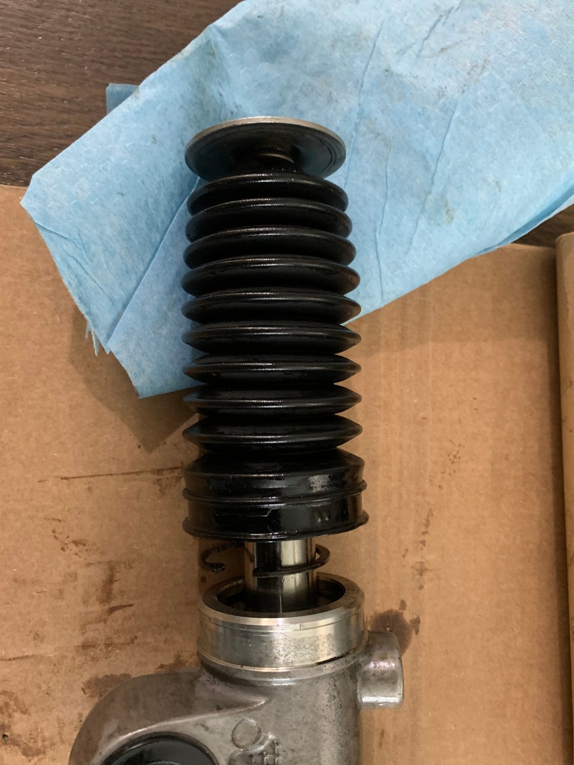

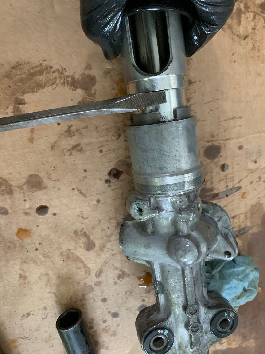

so I just trying to repair this rock and pinion but I’m wondering how to take off one end of the rock pinion so I could get to change the seals. I have picture of one where shafts goes to the steering not sure if that’s the end should be hit with a hammer and separate it. I also take out the ring fro the other end thinking it would come out afterwards but I was wrong. Help me

I look in the service manual I have ( not a Honda type service manual) but i can’t seem to find anything. I saw a page that mention about rack but it’s nothing about taking it apart. I figured it out and took it apart. Thanks anyway. There is a seal that down inside the house that I cant seem to take out and if I should use a seal puller it would be soo difficult to get the puller to get under the seal to pull it out. The reason why I want to repair the rack is because when I’m driving I can’t literally feel the steering going left and right in my hand on some road, took it to check on the alignment and everything is fine. My ball joints are find. Hun and everything shocks struts are fine so my only other option is the rack. When I unclip the metal clips from around the rubber Boots I have oil coming from all of them. That tells me that there are leaks in the housing of the rack.
