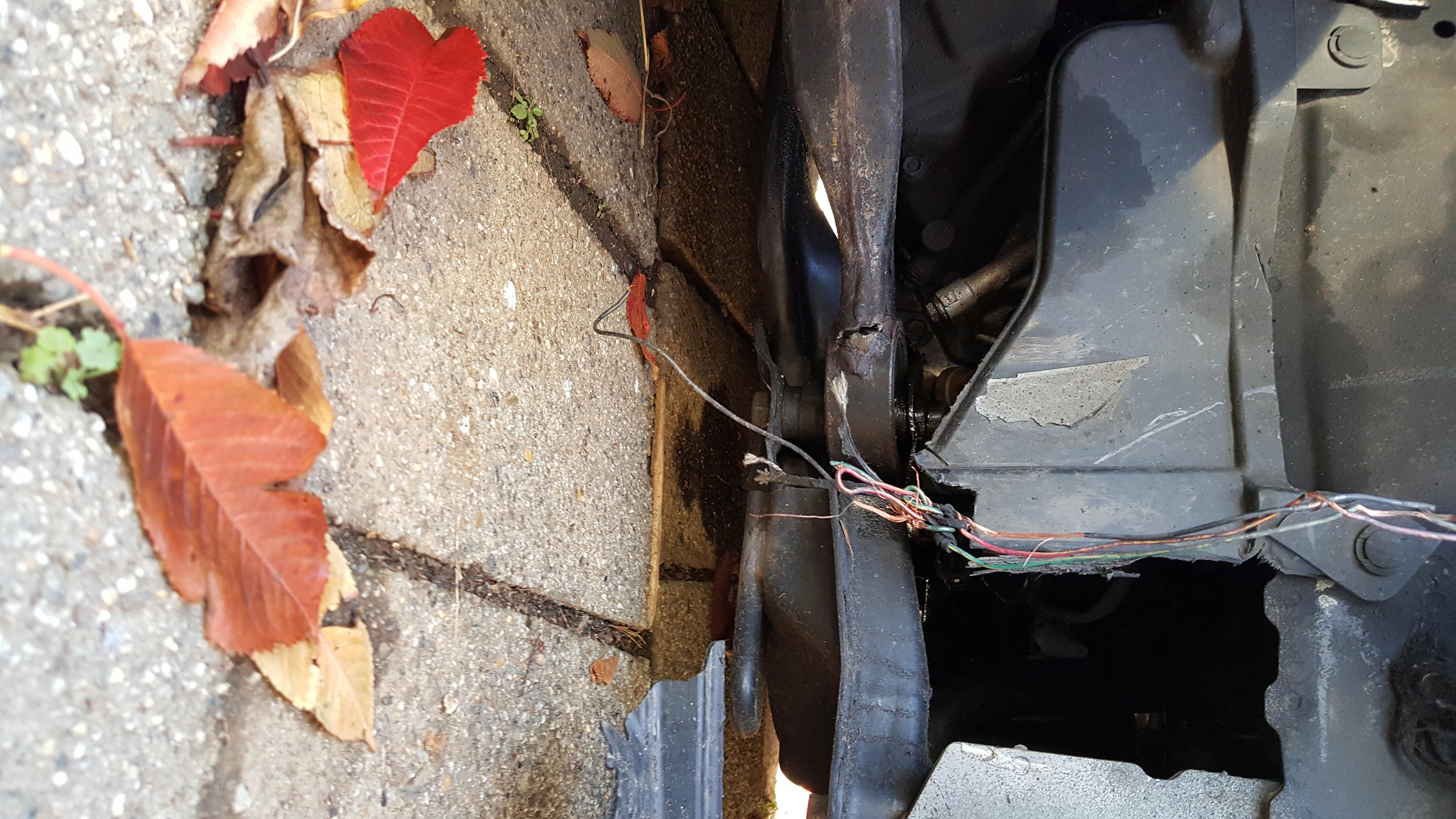

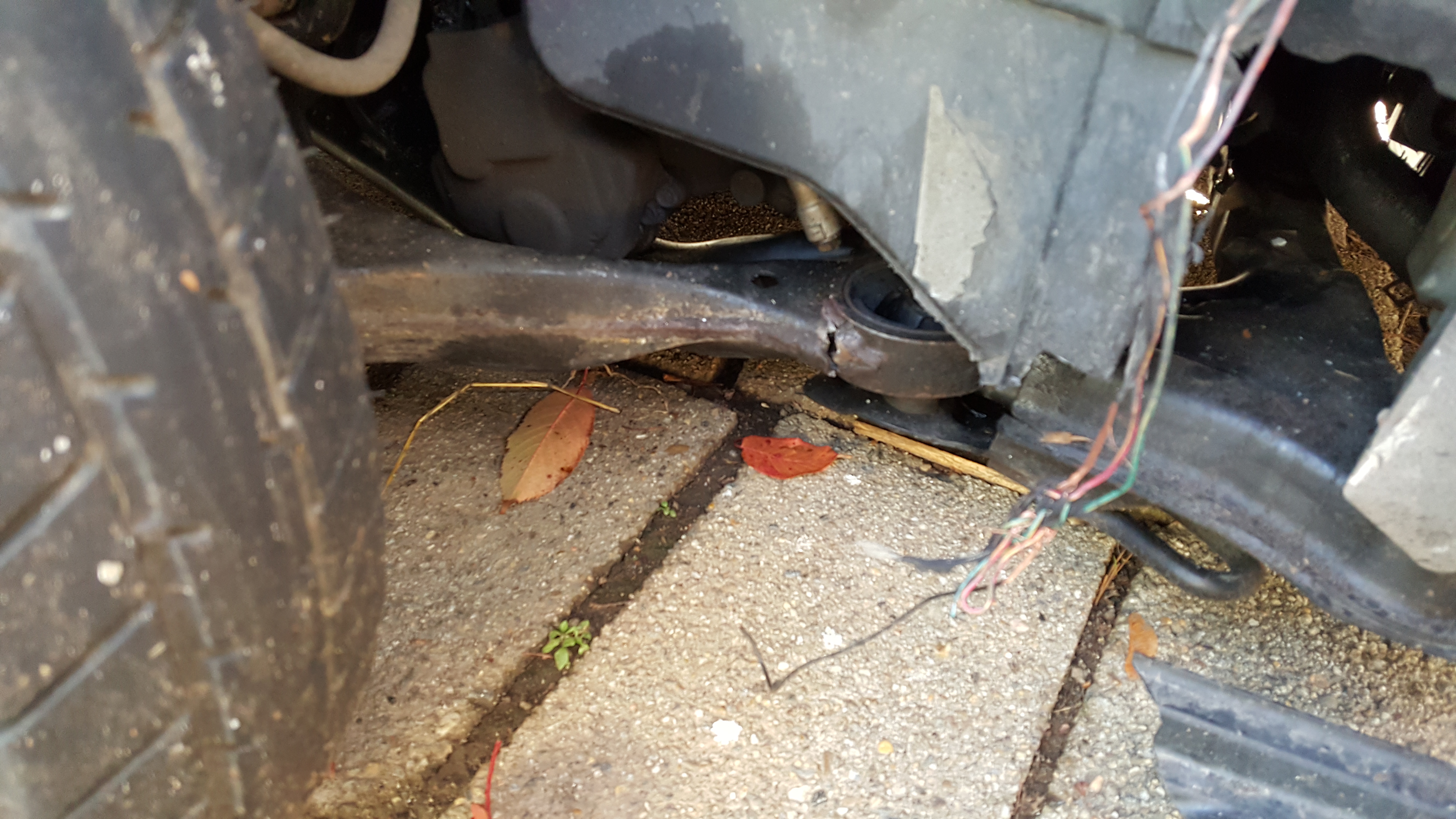

Hello everyone. I am new, and I am sorry if I have posted in the wrong section. A friend has a Honda Civic Lx (2004), with what seems to be a cracked control arm?
My question(s) - Assuming this plays out ideally, I should order a control arm for the front passenger side? Also, I know it's hard to tell given little information and 2 pictures, but by chance would anyone be able to identify the wires hanging? The lights seem to work, but the signal lights do not work when flipped on, so I am assuming those wires may have something to do with the turn signals.
As far as replacing a control arm - any advice or special tools required? Thank you all and I am sorry if I did not supply enough information. Let me know.

Did this person whack a curb or what? Look for other stuff bent or damaged.
I'd replace the control arm, complete
Plus an alignment, maybe that would reveal if more inspection is needed, look for more bent and damaged parts.
Wires.....maybe horn, maybe foglight or other lights? Use your head, figure out what does or does not work and see if it would make sense. Find another car like it and see what might be in that corner.

holy crap, what the hell did they run over?

replace both arms, most likely the compliance bushing is a goner on the other side.
a new arm is cheap, just keep the other side one and install new bushings for the next time it is gone.

no idea what the wiring is, maybe some aftermarket part?

Thank you everyone. I didn't think to check the driver's side control arm as well. I should replace both you all suggest? I'll figure out the wires, just thought I'd ask since I'm here. And as far as taking off the control arm - yea I haven't ever done this before, but I am going to give it a go and see how I fair. I suppose I'll let everyone know how it goes in a few hours. I really do appreciate the advice and I do appreciate the pros bearing me patience. I see now why it is important to learn this stuff early on.

The arm in the pics that is broken near the weld is dangerous, it needs replaced without question.
The other side should be inspected but if it is not damaged then there is no point in replacing it, if the front bushing is bad it can be replaced by itself or you can buy another lower control arm if you wish.

the price of a new arm is not that different than removing/taking to a shop that have a press/having the bushing removed/new one pressed in.
I simply replaced the arm, both sides. BTW, id tire rotation yesterday, and the compliance bushing is already quite cracked...
