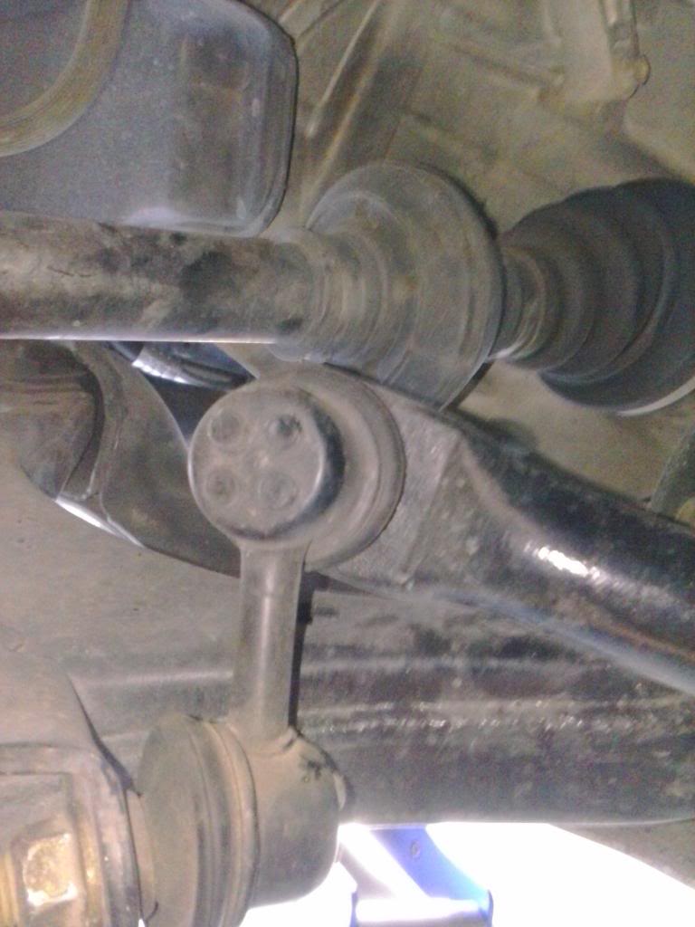

I checked the stabilizer bar links, they look ok:
I shook the stabilizer bar to see it it was loose, it seems pretty tight.

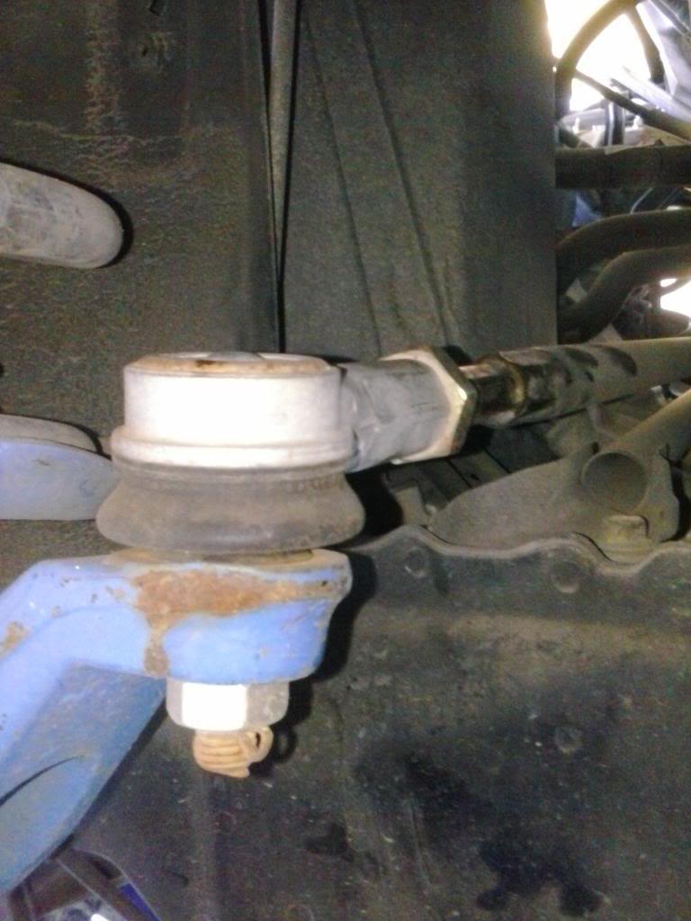

I checked the steering links, they seem ok:

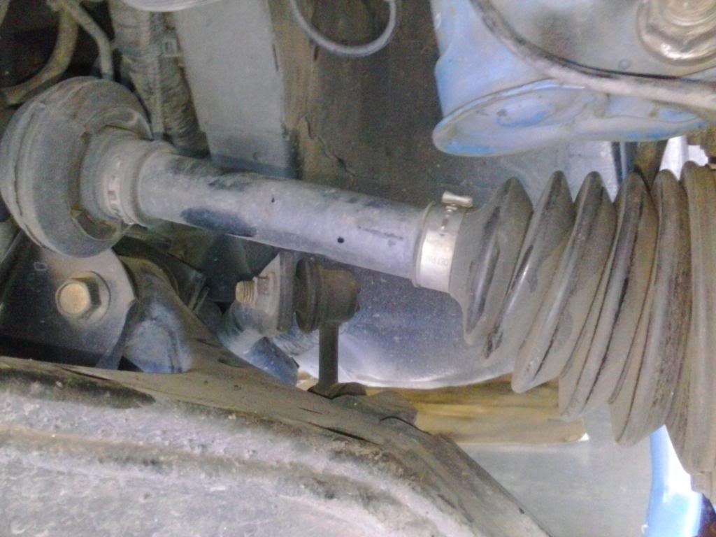

I grabbed the half shafts and they had some give back and forth. I would say they move back and forth about 1/8 of an inch. Here is a pic:
Normal.

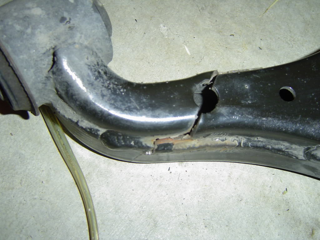

this was what was clanking in my car a few years ago, but could not see it clearly since it's in the top side of the lower arm:
Man, makes me cringe how badly I'd pounded my Paseo's LCAs running from meth-enabled roiders driving on surface streets in Phx, thinking I'd brake-checked them... good thing it was a pre-'96... and had stock ride height.
