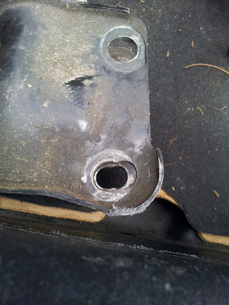

No, there was no problem before replacing the strut. But why would someone drill out the bottom hole double the size though? It wasn't like that on the driver side. The only thing I could think of is something being bent on the passenger side to make them drill the hole bigger on the old strut so they could adjust it accordingly so that there wouldn't be a tilt to the wheel. I will take a pic and post so y'all can see what i'm talking about.

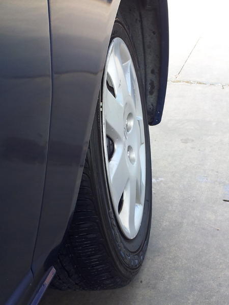

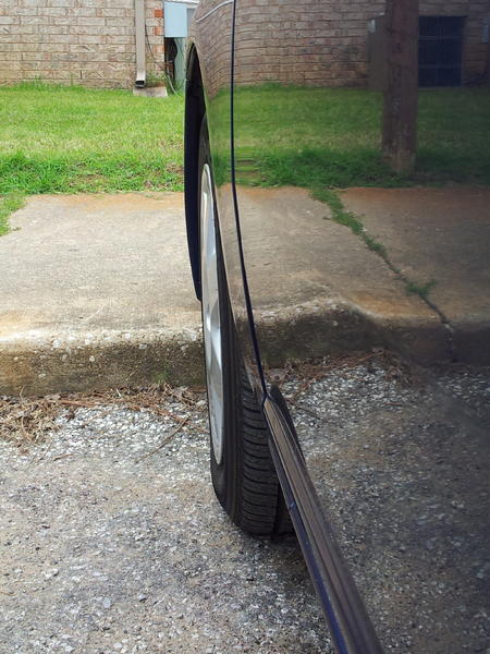

Okay, I've uploaded some photos so that y'all can see what I'm dealing with. There's a view of the drivers side and passengers side. Then a view of the old drivers side strut and then the old passengers side strut. You can see that on the passenger side strut the bottom hole was drilled more elongated vs. the driver side strut which was normal. I've also replaced the tie rod end and the lower balljoint(not that it has to do with my current situation) and as mentioned before the LCA was replaced too. The only other thing I could possibly think of now is the subframe being bent?? If some one could help me out I'd really appreciate it. Thanks

Something is definitely not right about your car. That hole in the old strut was enlarged by someone to fix the camber issue. The subframe is probably bent from a collision on the pass side I doubt the car rolled off the factory line like that.
Cheapest option would be to take both the old and new strut to a machine shop and ask them to enlarge the hole the same as the old strut. Shouldn't take them much time at all.
The proper way to fix it, is to take the car to a body shop and have them evaluate the subframe, and straighten it out or replace with a new one.
