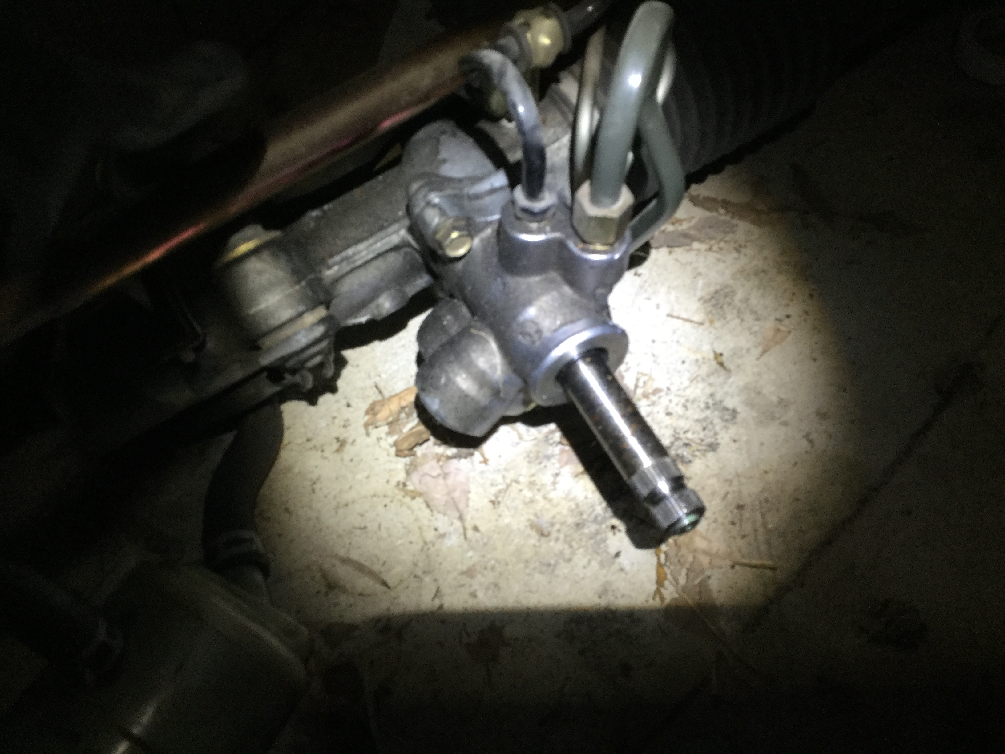

Re: Power Steering Leaking inside the car
Wonder just how hard it would be to just replace the 3-4 seals on the input shaft that leak out into the cabin..
clealy you you need to remove the assembly, but once out does not look hard to take apart.

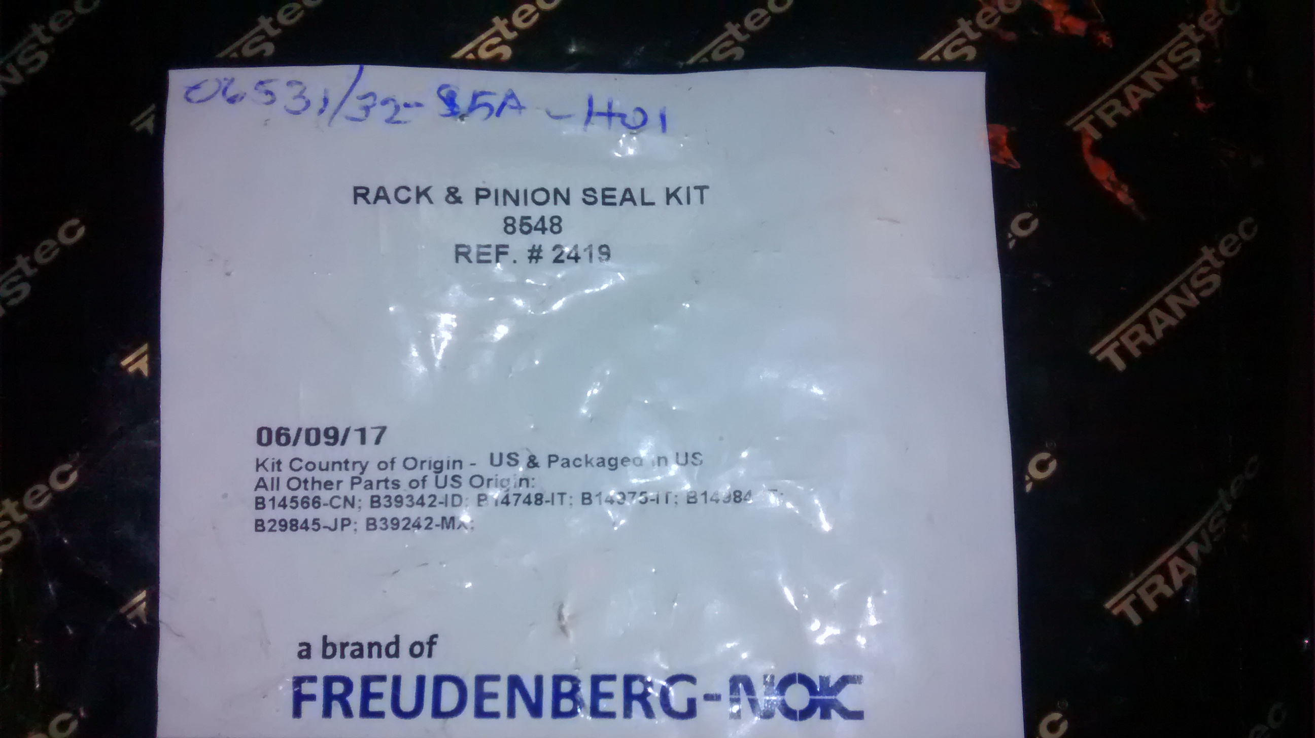

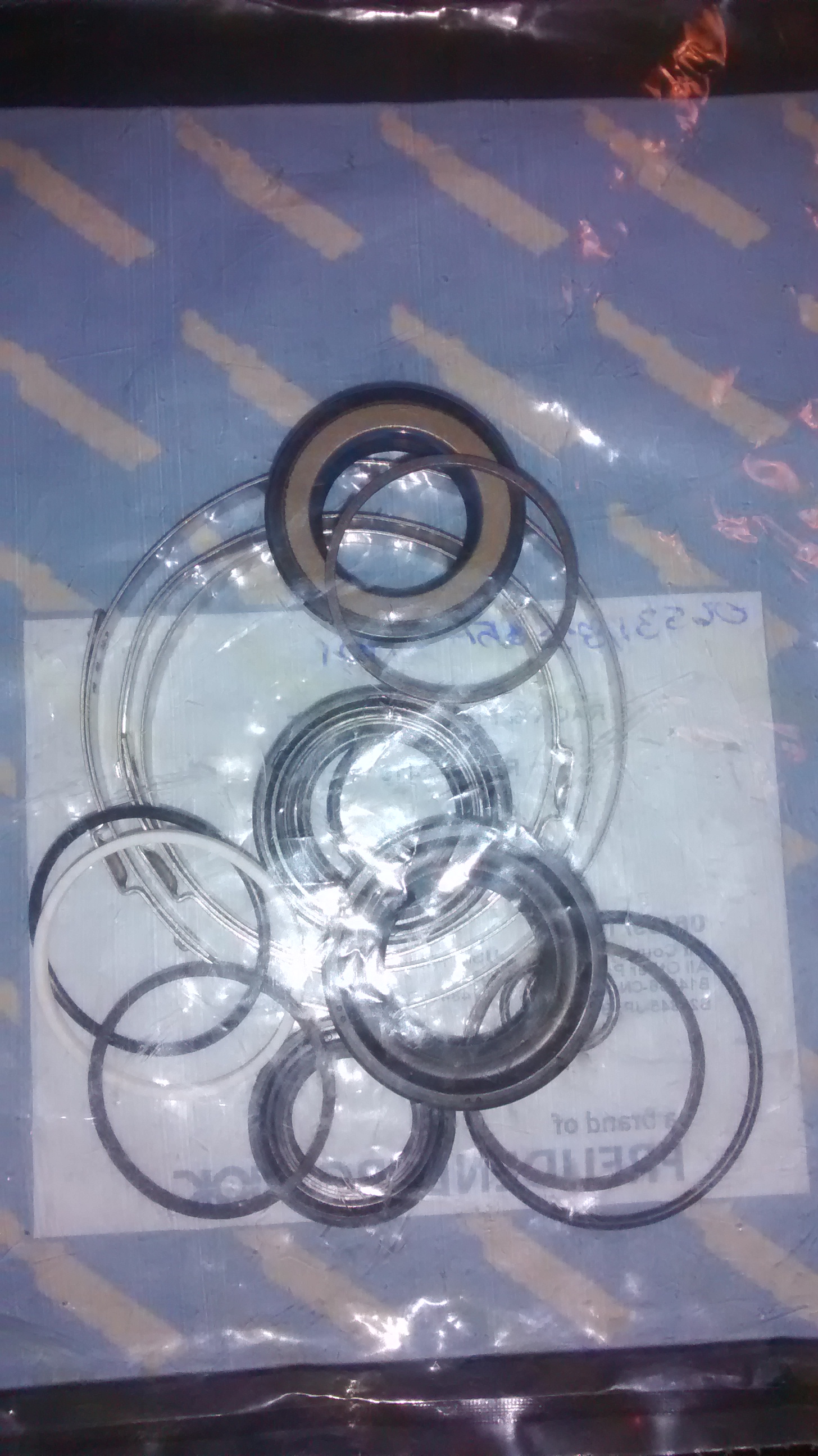

Don´t really know but...I will let you know tomorrow.
My local stealership wants $ 1200 for a new one (Honda)
and $ 565 for a re manufactured one (Honda)
I was able to get the seal kit for $ 47.34
Transtec brand (actually NOK seals)
http://transtec.com/why-transtec/the...complete-kits/
I will just take it to a local shop that only does this kind of job.
So I´ll try this first and if no luck I will buy the re manufactured one.
I won´t be throwing $ 1200 on a car that is 13 years old.
Name:	transtec kit 1.jpg
ID:	112204   Click image for larger version
Name:	transtec kit 2.jpg
