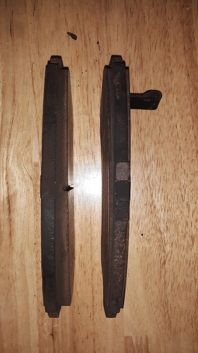

My front brakes finally started squealing at me, so I went ahead and tore them apart. I found the lower caliper guide pin COMPLETELY seized on the driver's side. As a result, the pads wore unevenly both from top to bottom and outside vs inside. I just wanted to inform those who may not know or haven't checked their brakes lately to make sure your guide pins are sliding properly.
