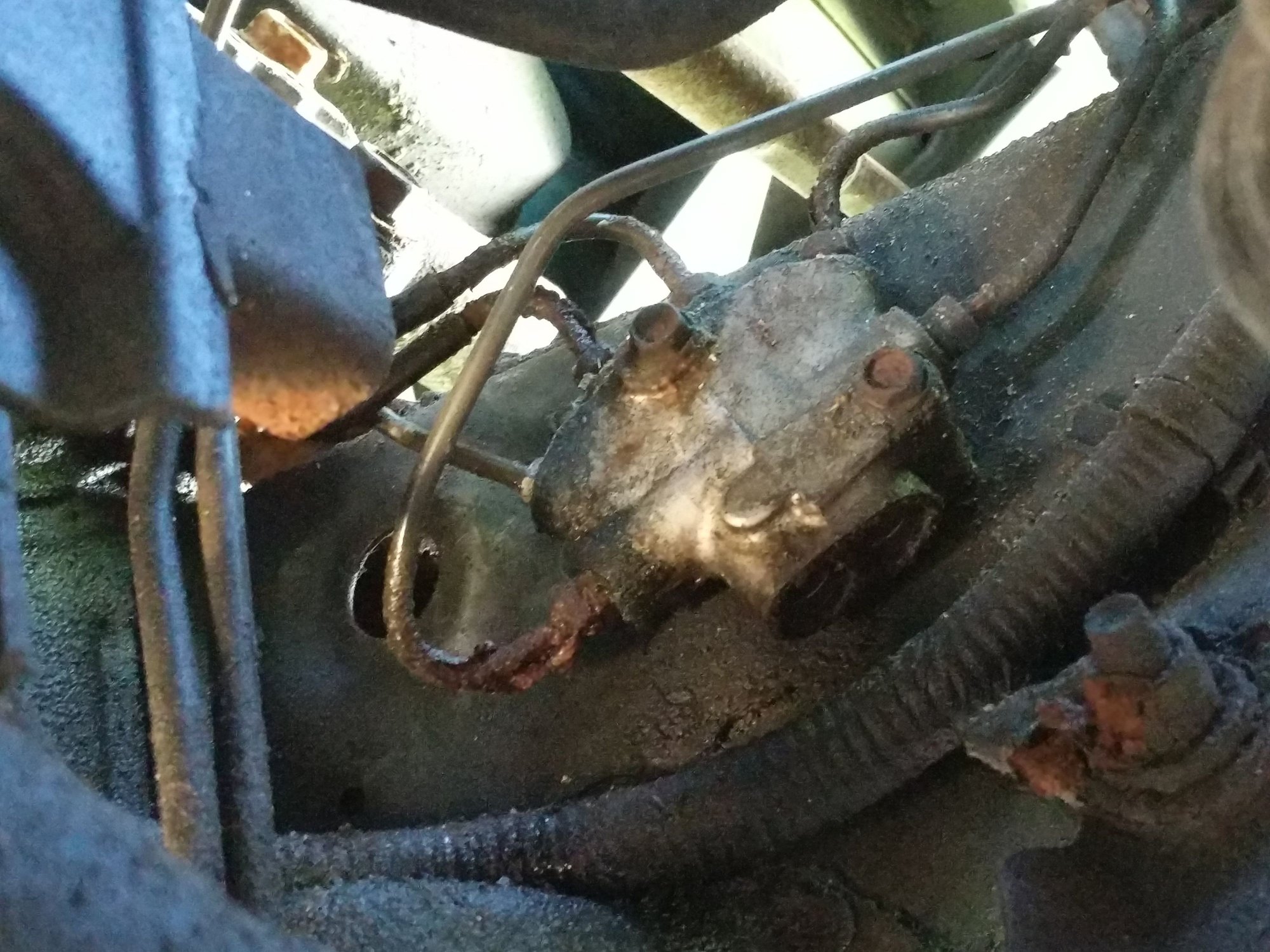

I have an 02 Civic LX which I picked up at the beginning of the summer. The current issue is that my brakes are leaking, and it's speeding up. I think if I refill the fluid and bleed the brakes I can drive for maybe two weeks. I was hunting for the source of the leak today, and I may have found it. It would be incredibly helpful if you could help me to identify which part I need to pick up, as well as potential instructions on swapping it out. Thanks so much!
Before I wiped it down.
After I wiped it down.
This is a picture I found online, but I've circled what I believe is the correct line.

Just realized that last picture is flipped from the one in my car, so it's actually the line attached to the other side (Labelled FL-RR).
Old Aug 29, 2019
Slumpertcivic's Avatar
Joined: Oct 2017
Posts: 1,267
Likes: 15
Rep Power: 119
Re: 2002 Civic LX brakes leaking.
Oh that’s bad...
Clearly that line needs to be replaced, but possible your not going to be able to disconnect that from the flex line so then that will need to be replaced..
Definitely suggest looking at trying to find a pick part junkyard and pulling that line out completely from a non-rusted car.
Those other lines don’t look like they are far behind..
That brake line actually runs up to the master cylinder, no flex line involved. My local Honda dealership has that line listed as $36, part number 46320-S5A-A02.
Haha, I didn’t even “see” that line due to contrast on my phone.. I was seeing the rusted out one weeping down the portioning valve backlit with sunshine..
Indeed that lower one needs to be replaced as well, what sort of hellish rust do you have elsewhere I can only imagine.

Thanks for the help thus far all. I got the line off, though it was a huge pain. Now i have to get a new line put in. I don't have the ability to go pull one off, so I'm just going to bend one myself. Due to time constrains, I'm not going to be getting tubing and flaring it myself, I'm just going to buy a line from Advance Auto.
I am very worried about the actual bending process itself. I have the old line to use as a template, but there's a ton of complicated bends in it, and I'm worried about getting it in exactly the same shape. How difficult is it going to be to actually bend something that's going to end up fitting into the car? Any tips? Thanks!

Hey all. So I still have a leak, but I do think I have the location down correctly. I think the problem is that the fluid is actually leaking out through the threads. Is there a way to fix this without replacing the proportioning valve? Perhaps if I used threadlock, or something akin to it? Thanks again!
Had same problem with my 2002 civic,had to purchase new proportioning block, new honda oem $120.00 ouch , i think problem arises with alum threads in block -steel threads on brake line fittings get buggered up stripped,also had all steel lines replaced new master cyl.,cost over $550.00 labor and $250 parts car is in N.E ohio
So you replaced the rusted line, correct? Do you just not have the new one tight enough? Or Is it cross-threaded?
