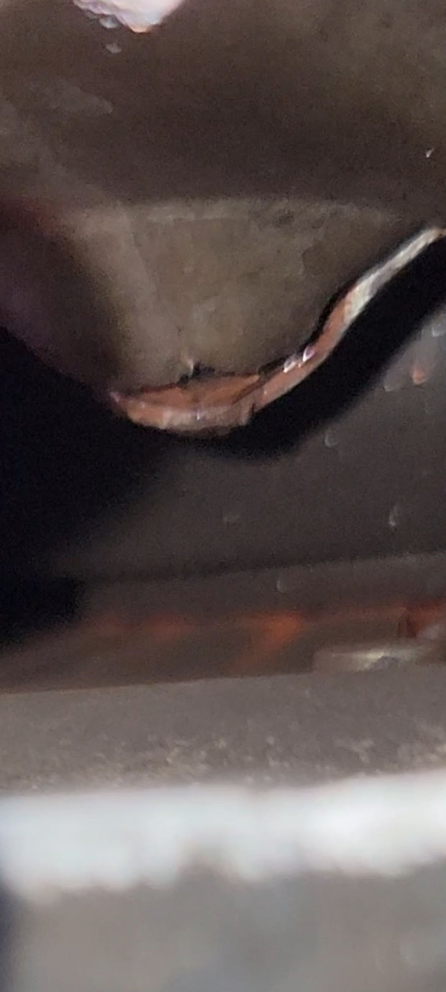

Hey yall. Basically to make it short and simple the car won't go into any gears unless the car is off. It started yesterday but got progressively worse until I can't get into any gear. The clutch won't disengage even with the clutch pedal to the floor. The clutch fork moves so that's a plus I guess. I'm not seeing any leaking coming from the master cylinder but the slave did have what I believe is old brake fluid inside the boot. However after cleaning the inside and pumping the clutch pedal quite a few times I'm not seeing any fluid. Could this issue be purely clutch or pilot bearing related. In the video linked below it shows (sorry if it's not the greatest quality lol. It's hard to film it such a tight spot) that the fork is pushed in but the input shift is still spinning. No unusual noises coming from the bellhousing area even with the clutch fork pressed.

Turns out I didn't need to drop the trans to figure out the problem or 1 one of the problems. Classic case of should've greased it better. Clutch fork split at the pivot ball mount. Bought a clutch kit today so since I already have to drop the trans I might as well replace that as well. Problem is that it's the one part that an auto parts store doesn't sell (at least in my area) and I doubt a wreckage yard will sell it to me without buying the whole transmission. Time to call the dealership I guess.

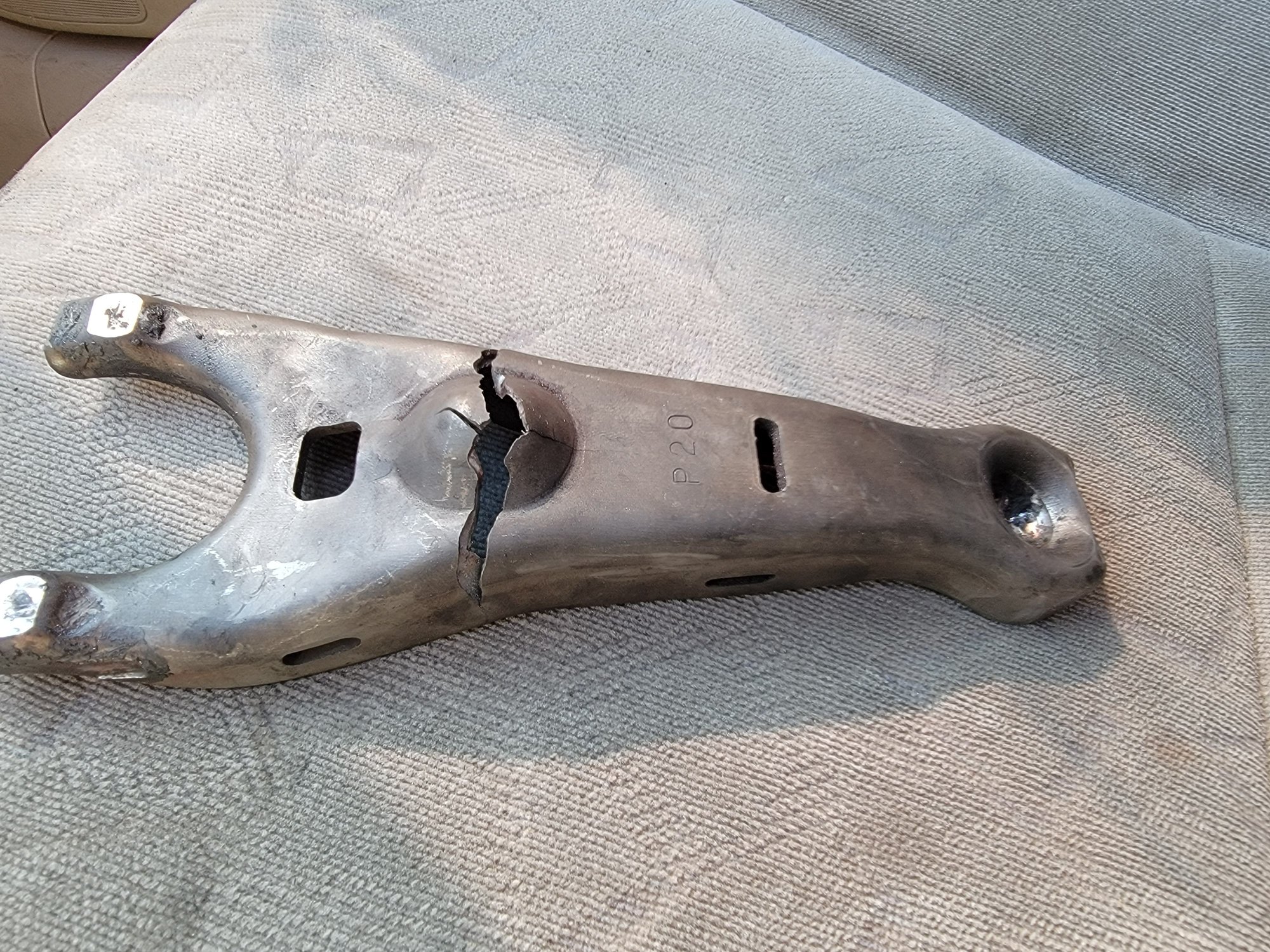

Final verdict. Clutch release fork is almost split all the way across width wise at the pivot ball mount location. I'll post photos tomorrow. This time around I greased the pivot ball generously with some wheel bearing grease. The broken clutch fork apparently was never greased at all from the previous owner's clutch job. Wore away the clutch fork until it had barely any material left to sit on and eventually just gave up. Pressure plate was still in good condition and the clutch disk had a fair bit of material on it left, still replaced it because I'd be better safe than sorry.

Here's the photo of the fork as promised. Nearly a clean break.

That's impressive, and try bleeding some more.

1 inch off the floor was surely from the nearly two piece clutch fork.
