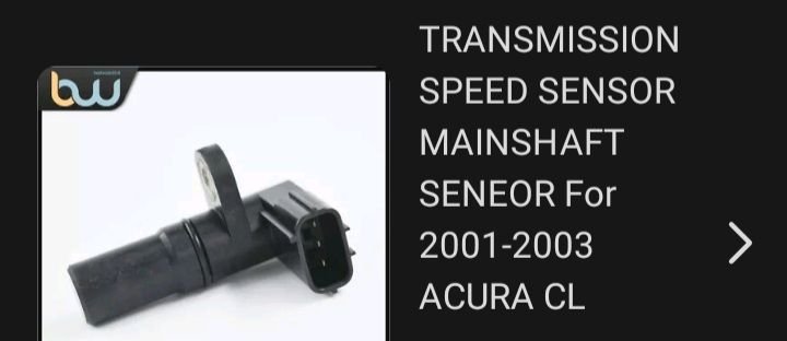

Thank you for your help and I realized I ordered the wrong part the reason it didn't make sense in the location it was giving.
Where is this located?
Might at as well replace it... lol
Thank you again
