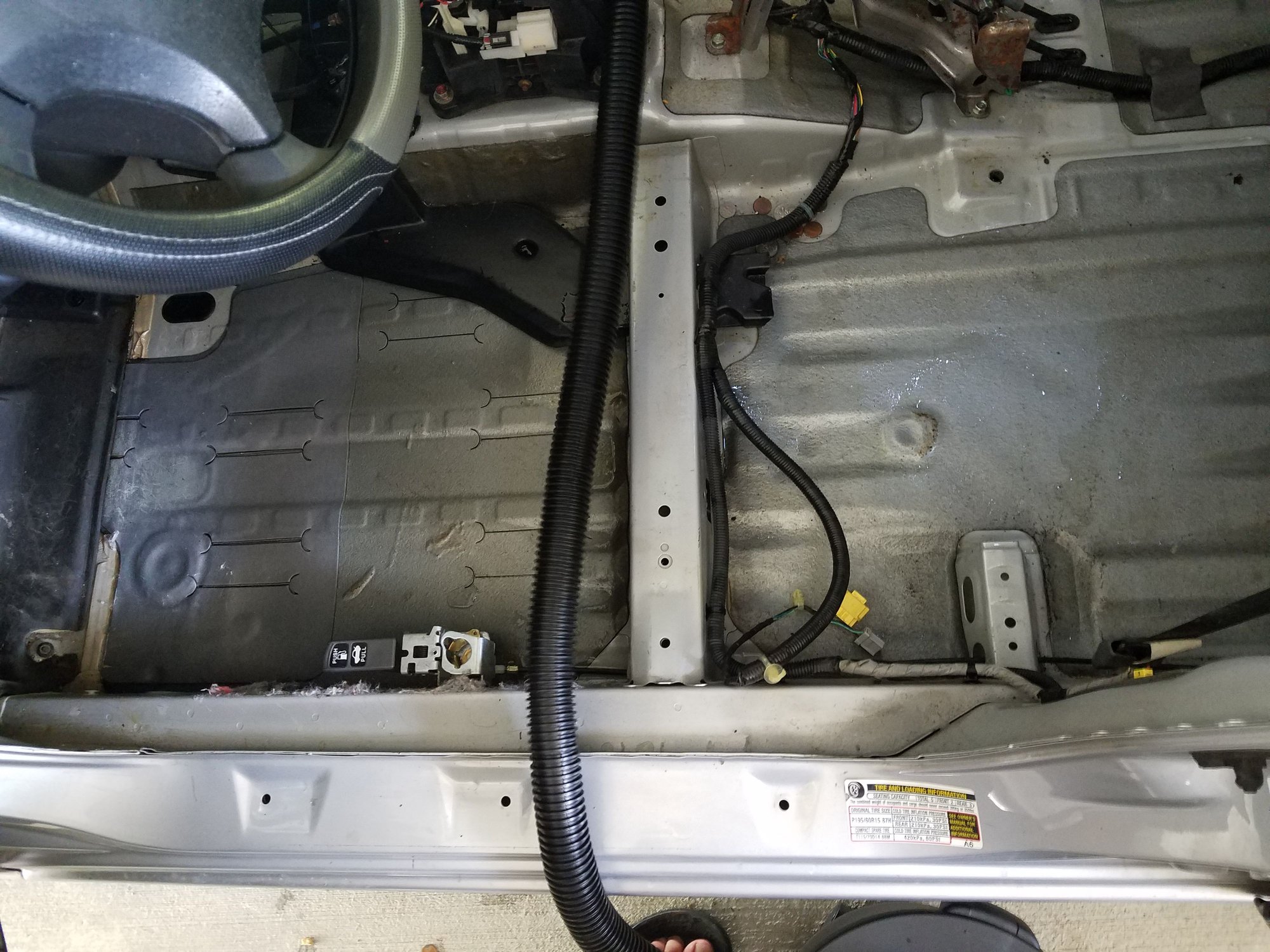

Raining a lot and I had been delivering food as ubereats etc. I got into some water flooded areas and by night the car was having like a whining noise when I accelerated, next day gear shift skipped. Never had it happen before in 15 years. So I did get into water flood again next day after already having the problem and I got water in my interior carpet and now I'm batting into shampoo and vacuum and removing all interior plastic sides and all. But what's hurting the most is the transmission, so today I did another fluid change and the car have a rattling noise in parking at idle coming from the transmission. The engine is perfect but now that I accelerated in parking the rpms peak at 5000rpm . Could this be a sensor problem again? Could it be the transmission having to do with sensor damage or is it else? I had been using valvoline max life atf since the last 4 fluid change also. Please any of you experienced experts here guide me through this, I need this car to last me 15 years more. It's my second home
Feel depressed with this happening after I replaced so many parts in over a year and now got all shassis parts new and new tires and alignment and the car was running so perfectly smooth like brand new . My God. Also bought today a new transmission dipstick and fit tight in this time, always was worried since the beginning why the OEM one was all loose

Also, how deep was the water? You may have water sitting in connectors and causing issues.

there rain water flood in south Florida been raining too much and the first day I got into like a foot of water or so and that same day I started getting a transmission sound then next day gears skipping a little or so and then got into deeper water . Hundreds of cars stranded everywhere on the road for water flood. Is not possible to drive under such conditions.

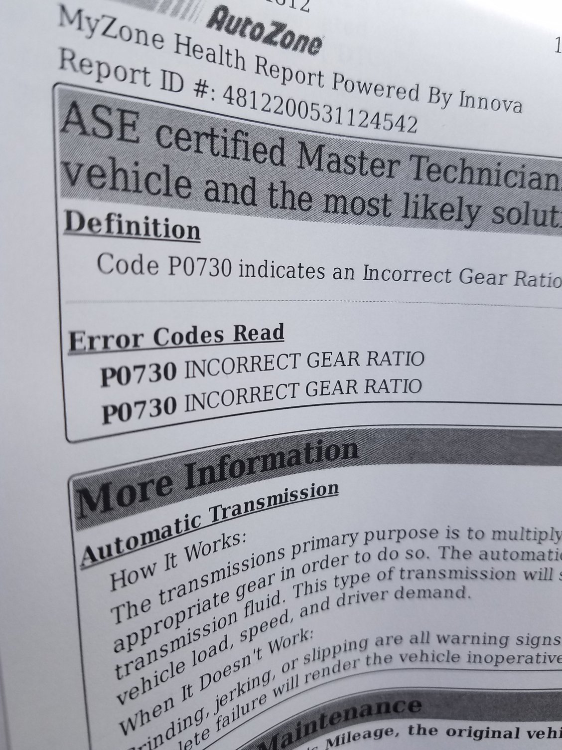

Last night finally transmission gave up, engine light on and cannot go faster than 30mph . Some mechanic guy at advance auto parts told me the symptoms and said it is very common on these honda civics that best bet is to buy one made in Japan running low mileage than repairing. He gave me estimate $800 to buy one and 350 to mount it and all. Damn what should I do,

showed fluid levels as low, they aren't. The guy at autozone says the knock sensor activated and if I had gotten into water to wait a few days and see what happens but been like 5 days already.
