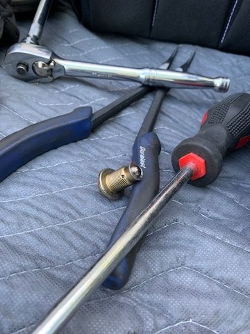

Thank you so much for your response @SlumpinCivic . Took the transmission out, removed those 2 12mm spring bolts and look what I found. Not sure how I did it, but I did. Hoping I can find a replacement and put this baby back together.

With those spring bolts out, I was able to cycle through all gears. I'll make sure to check again once the new bolt is installed.
