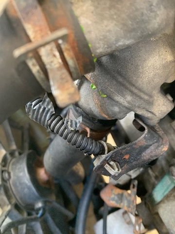

check around under the intake, between engine and firewall? need to see from under

So last night I tried something thinking it wouldnt work. I noticed new pink drops, thinking they could be from the top hose by the manifold.
I noticed the top hose was mounted far down the pipe. So I loosened the clamp and pushed the hose all the way up and reclamped it.
Today driving to and from work I only smelled a hint of anti freeze a couple times. But the weather is not as hot as it usually is.
But now there is antifreeze creeping out of the hose. Just a tad. This hasnt been this obvious before.
What do you guys think, new regular clamps, new oem clamps, or new hoses?
The clamps have beaten a groove into both hoses.
Maybe the clamps arent as strong as they used to be, or maybe the hose is too beat up inside to seal? These hoses arent swelling, they feel fine.

Either new normal hose clamps, or new hose + clamps
