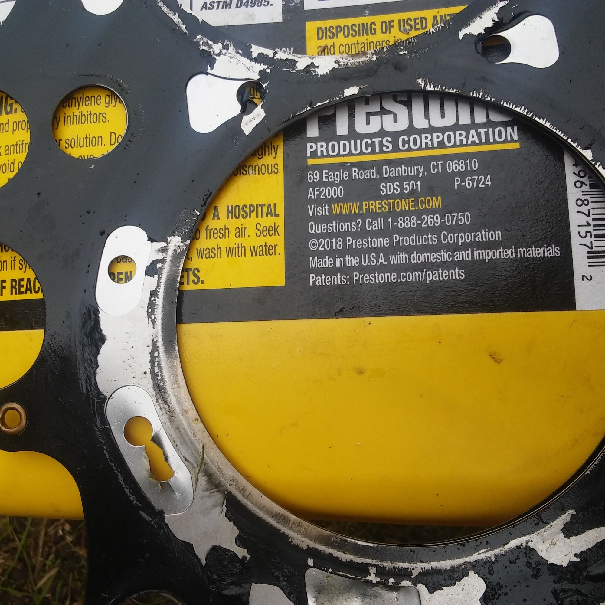

Tear down starts first thing tomorrow. Radiator had exhaust gasses entering it via cylinder # 4. Compression test yielded 185 on 1,2 and 3, 200 on cyl. 4. with plugs removed coolant sprayed from cyl. 4 when turning engine over and radiator cap on.

I wonder? Hope its not still in there!

Head gasket was blown at water jacket on cyl. 4.. Replaced with h.g. from local honda dealer. 100 miles and all is well this time. Hopefully this one will last
