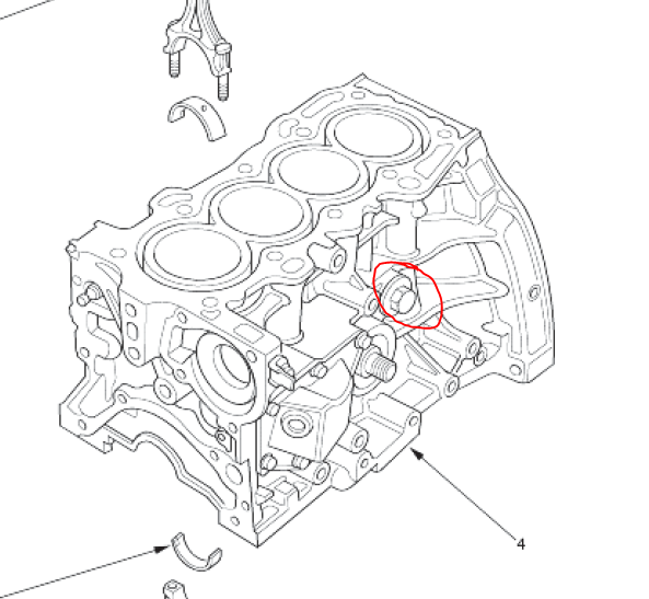

Where is the coolant drain bolt (28 mm) in the engine block
I have looked a lot. Downloaded Chilton manual
with no luck. I know I overlooked
is it a Allen type bolt or a hex head bolt ?
does anybody have an actual picture of it’s location ? Or a good description of the location please

It is a hex bolt, 19 mm head I believe. Located on the back of the engine (firewall side) just to the passenger side of the oil filter.
