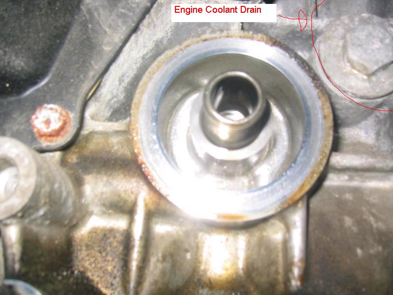

Originally Posted by ncirom2003
never heard of a bolt on the engine block to drain coolant. must be me but anyways what are you looking for what size wrench you need,
or what size replacement bolt?
Its right next to your oil filter.

ohhhhh i see. so what measurement you lookin for? best bet would be to call honda or just keep trying a few diff. wrenches on it make sure you use the 12 point end of wrench not the open end or youll stip that sucka

I'll give you a hint - it's metric.
Just figure it out - it looks like 12mm or maybe 14mm.
Seriously, just put a ratchet on it, you have four choices on these engines for the most part - 10mm, 12mm, 14mm, and 17mm. You can pretty tear apart your whole engine with just those sockets.
And dude, if you're intending to drain your coolant, there's a plug on the radiator that's much easier to get to. Unless that manual says to drain coolant like that, you should be using the radiator to drain, not that plug.
