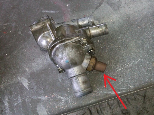

if the hoses top and bottom are hot and your fans are not turning on while idling it is your fan, fan switch or fan relay. (my fan switch blew out at 150,000km.
if it cools fine while in motion and overheats while stopped that means that the fans are not turning on to force air through the rad.
you can test this by first taking her for a hard rip then pull over when at operating temperature, if you pop the hood and the fan is not spinning, while ac is off, then there is a fan issue.
To test the fan/fan switch, locate the fan switch, it looks like this
it will be right under your thermostat
-disconnect the electrical socket
-jump the socket with a piece of wire (the plug side not the switch side).
-start the engine.
If the fans spins this means your switch is fried.
If the fan dos not spin either the fan is fried or the relay.
to test that fan just disconnect it from it's electrical socket and connect the battery directly to it, if it does not spin your fan is fried.
if you get to this point and the fan spins, that means that there is no power getting to the fan when it should be. So test the relay. (you can pull the horn relay out and place the fan relay in it's section, if the horn still works then you know the relay is good).
good luck.
