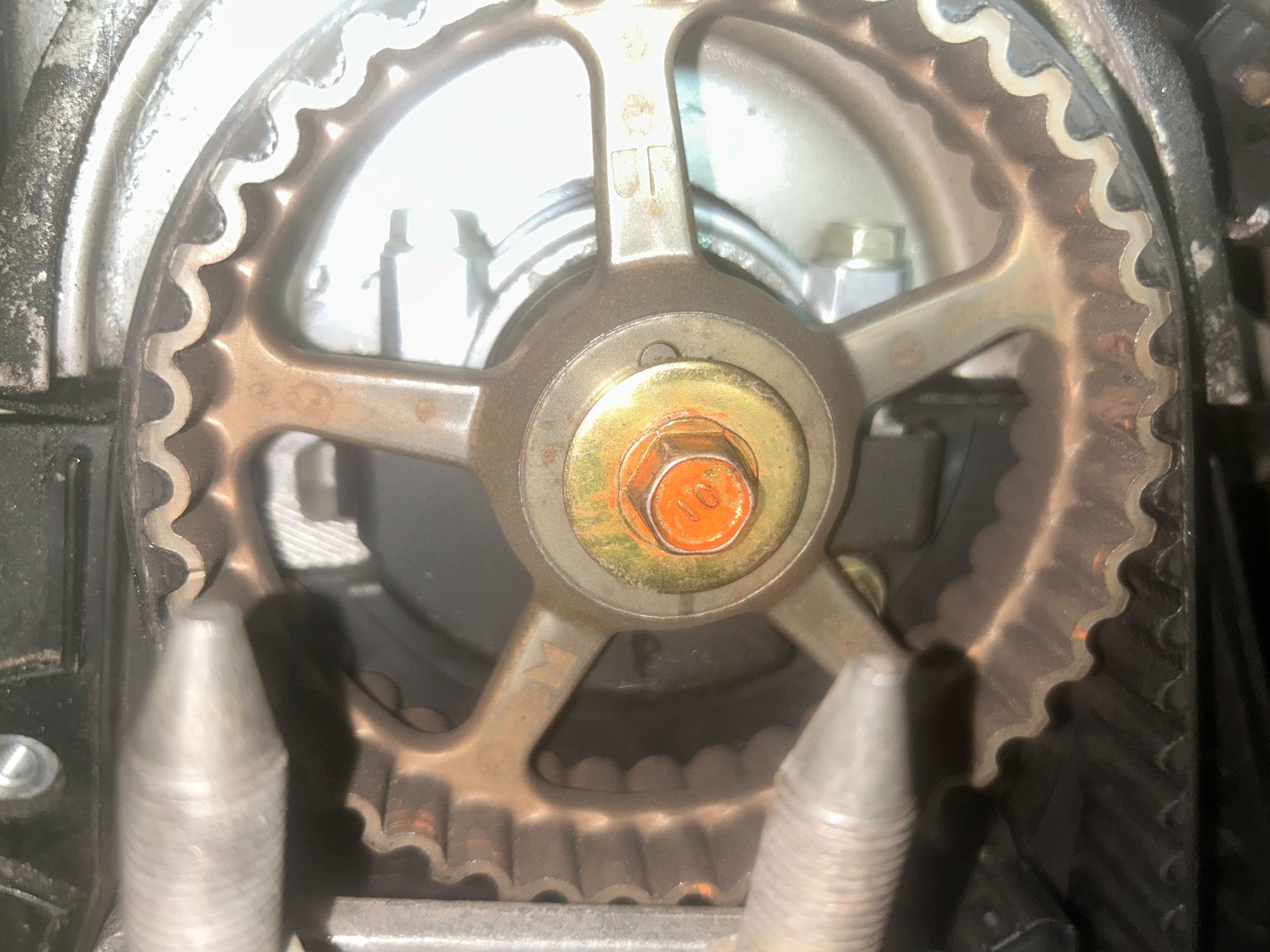

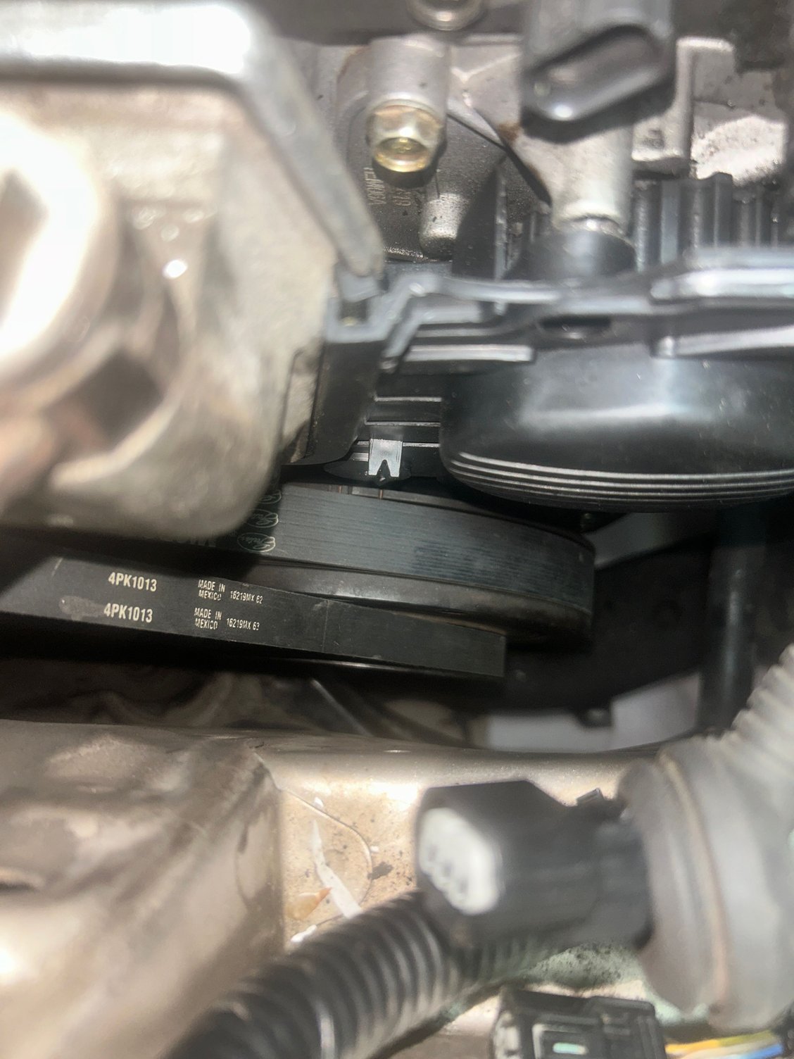

I thought if both sensors are functioning maybe there is a problem with the timing so we pulled the upper timing cover. I believe the belt has jumped a tooth but wanted to confirm before the timing belt is replaced. See the pictures below.
Any advice is appreciated or if you have other suggestions for the cause. No codes except for the sensor that is unplugged to make it run.
