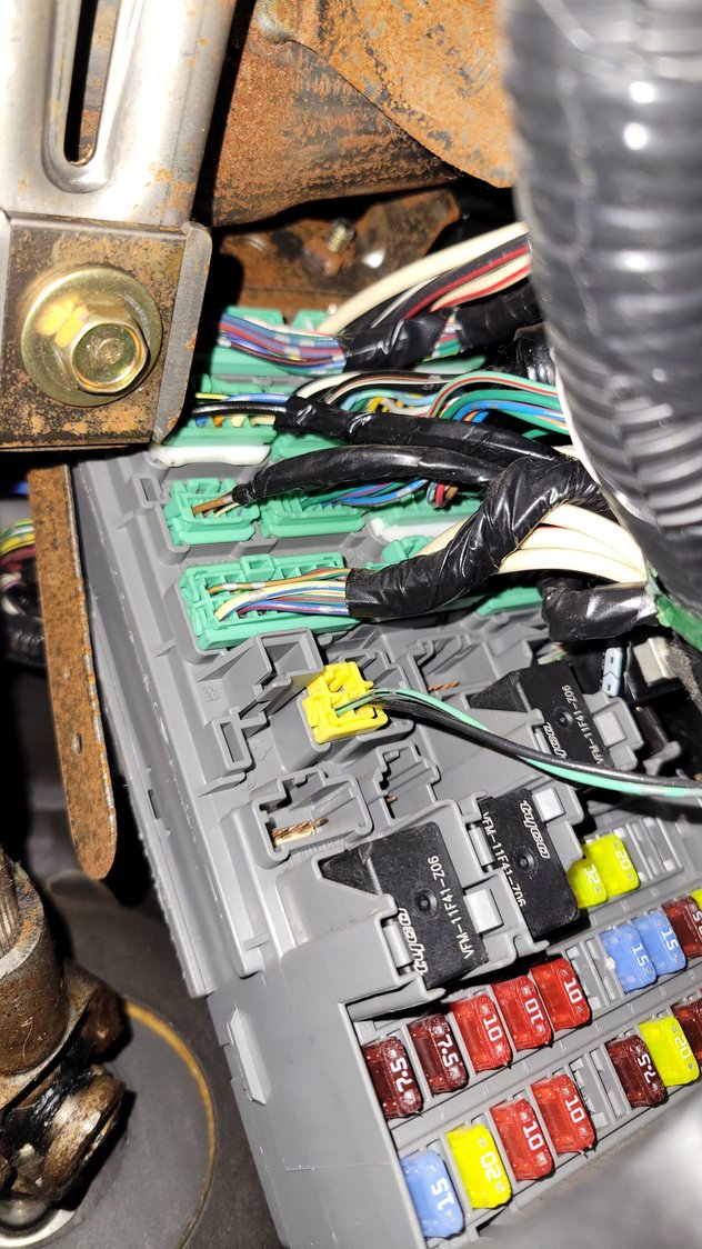

As you can (or can't) see, the scanner's bright blue LED is nowhere to be found, while it would usually even be on while the car is off. Any idea if there's a fuse related to this?
Most relevant pic in my camera roll I had, didn't see any obvious breaks but ask me for more photos of needed
