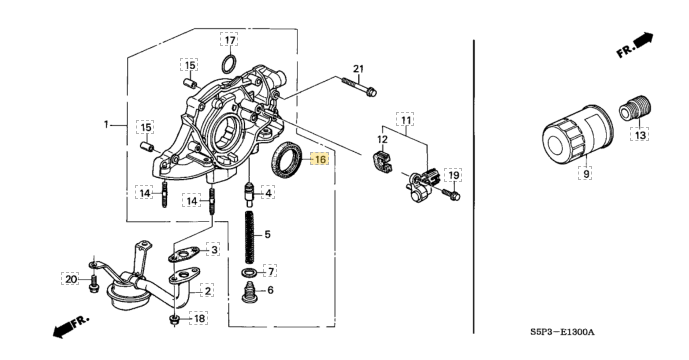

You might as well do the timing belt/water pump unless it's been done recently.
Originally Posted by shunpiker
The crankshaft seal looks solid (not leaking), but since I'm this close, I'm going to replace it, too (do you happen to know the p/n of this crankshaft seal?).
You can use a site like HondaPartsNow.com to look them up. For the crankshaft seal you want to go to Engine > Oil pump - oil strainer. It is part number 91212-PLM-A01 (reference 16). Oil pump seal is in this section as well (reference 17).

Many thanks for that clarification. I was looking on the 'fiches for the crankshaft and its seal to appear in one of the exploded images. I couldn't be sure I was getting it right. Thanks again.
