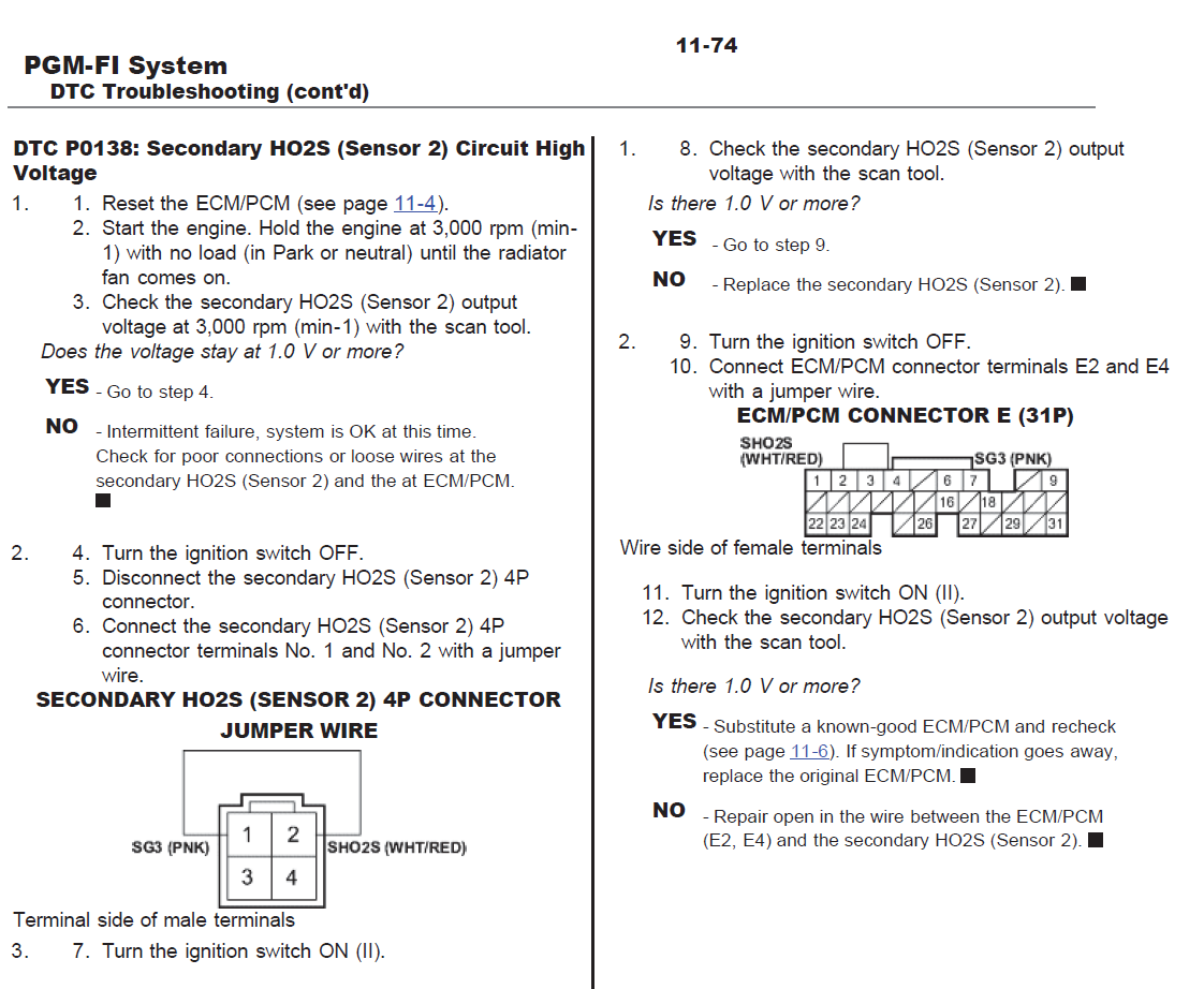

Which pins I have to check for wire continuity on 2001 Civic EX? I am getting P0138 on my downstream O2 sensor.

Directly from the service manual that you can download for free.
