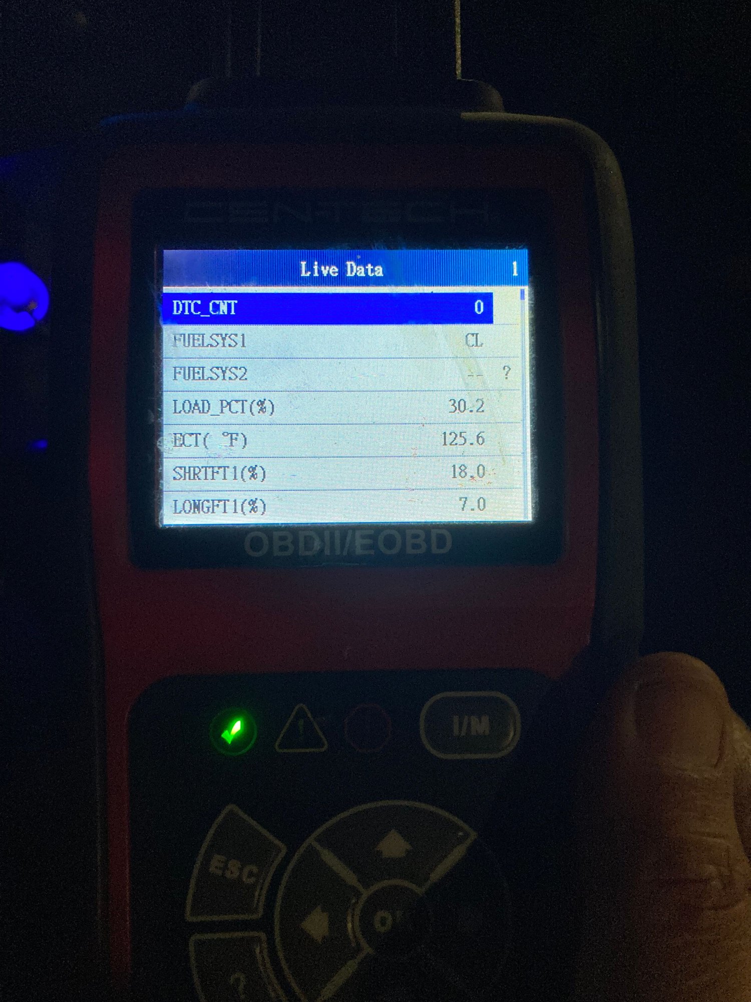

I scanned the car and my long term and short term fuel trims were about +7 or +8 each, which doesn't set off a code, but is high. The car drives perfectly fine, but the gas mileage is horrible. I've scanned the car with over 200K miles before and my fuel trims are usually like -1 short term and +2 long term. Really close to 0 like they're suppose to be.

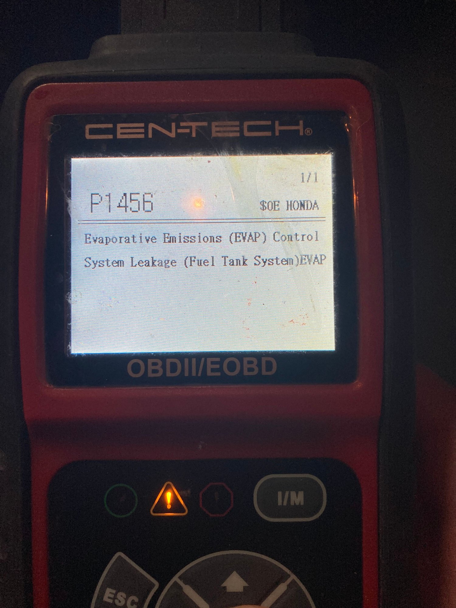

I drove it the same 50 mile trip all highway again. When I got to my destination, I actually got a pending code. P1456. Google search basically told me it's the gas cap every time. I replaced it with a brand new Stant gas cap I had laying around. That code hasn't come back after a week. When I got home from the 50 mile trip, I got a P0420, which I know is pretty much always a cat code. I've replaced the cat twice already, I'm skeptical that the cat is actually bad, I think it's something else throwing off the computer. Code hasn't come back in a week either.
After I replaced the gas cap, it actually did change something. When I'm driving and coasting, the STFT actually does go to 0 now. But it jumps to like 12 or 18 sometimes when i put the slightest pressure on the pedal. If I come to a traffic light, or park it in the garage the STFT is usually around +8-12. LTFT is about +7.

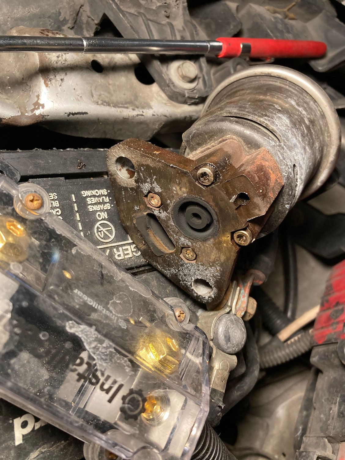

I thought maybe it was the purge solenoid because that's related to the gas cap code. So I bought a used throttle body assembly and cleaned the IAC up and installed it. I got it cheap. So it's the new throttle body, IAC, and Purge Valve. Installed that today with no improvement.

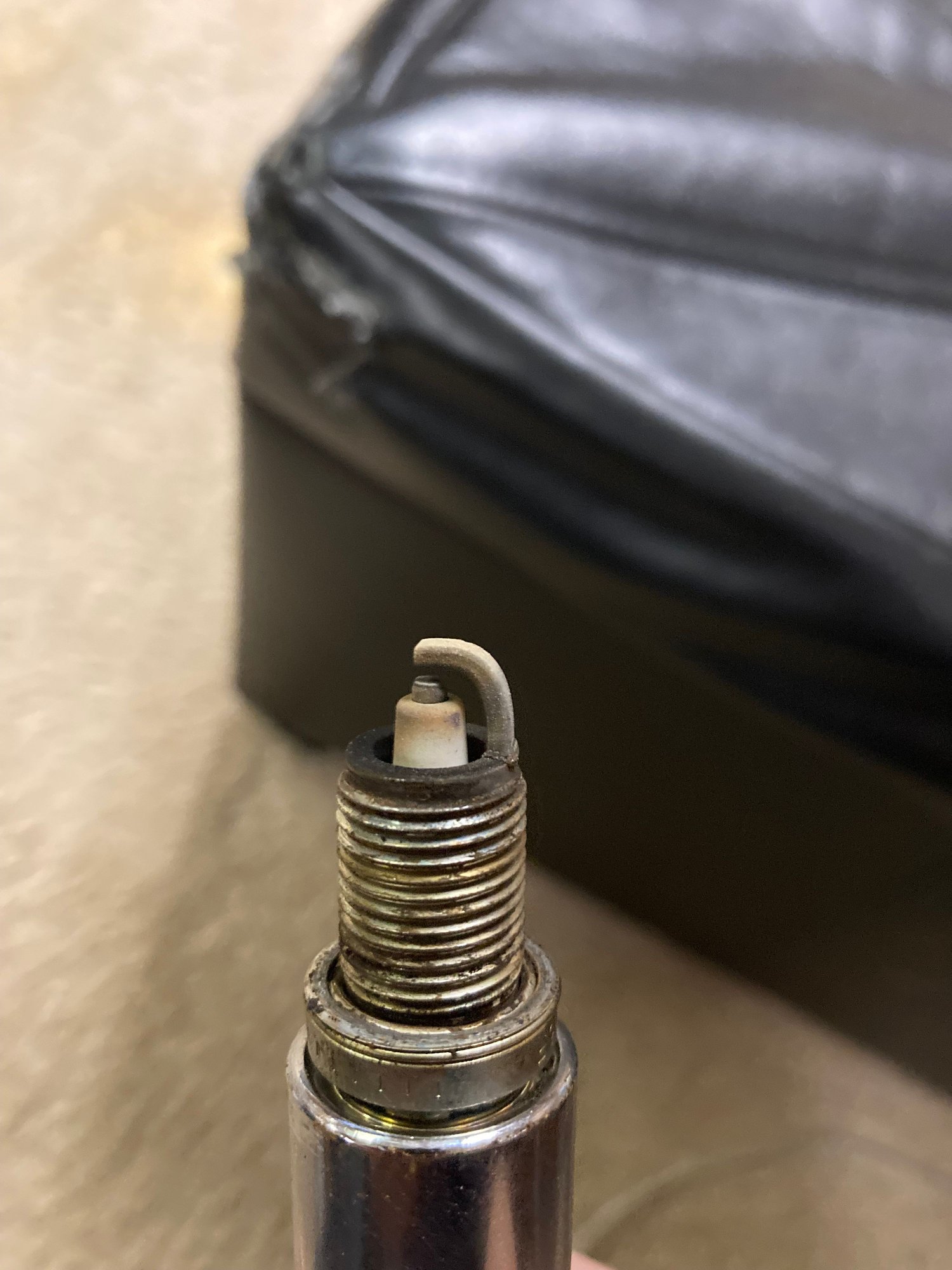

  • Spark plugs last replaced last spring I think. NGK Coppers. I took them out last week. A little browning to the white porcelain part but it's been like that for a while.

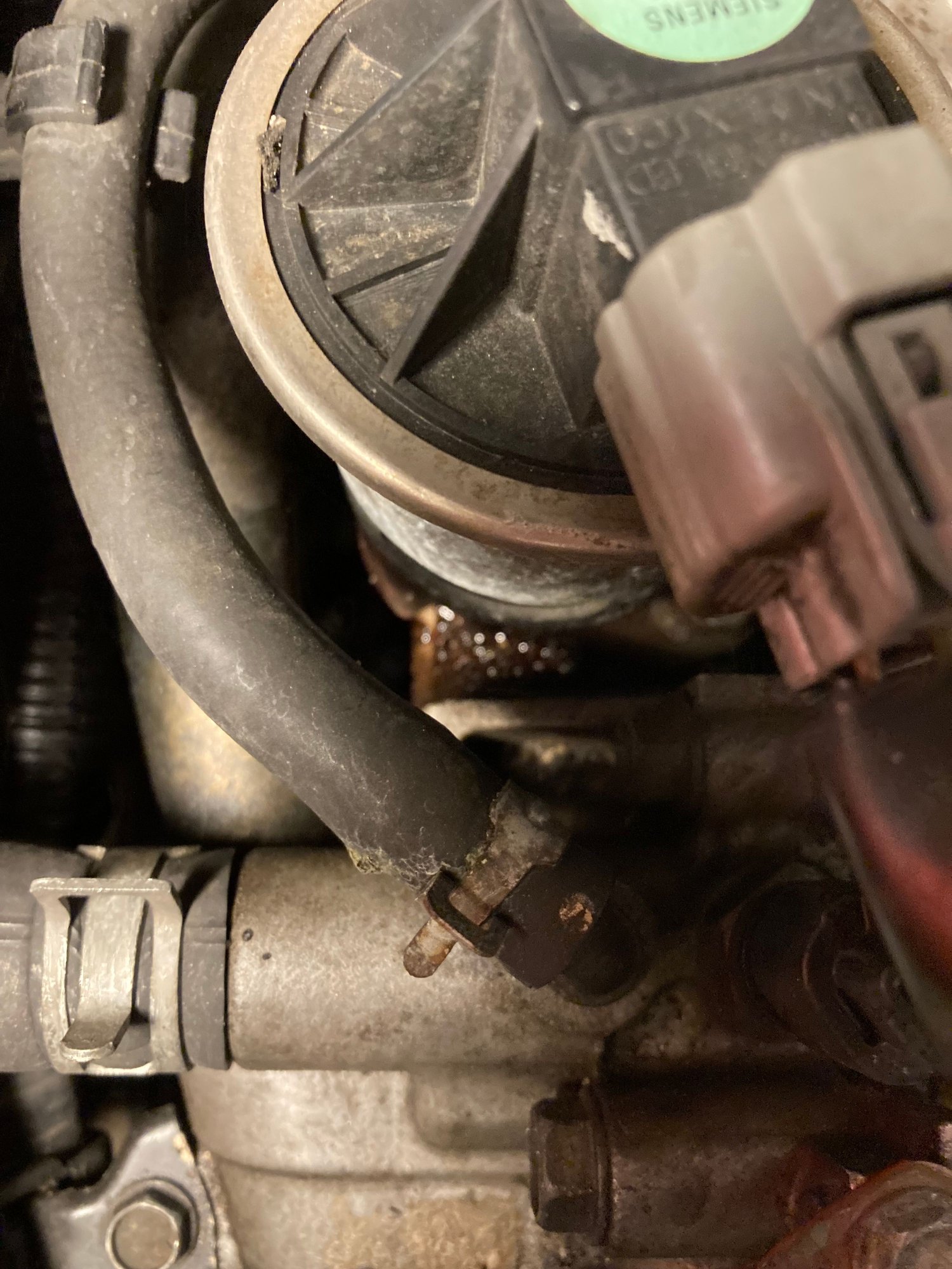

  • Cleaned EGR Valve

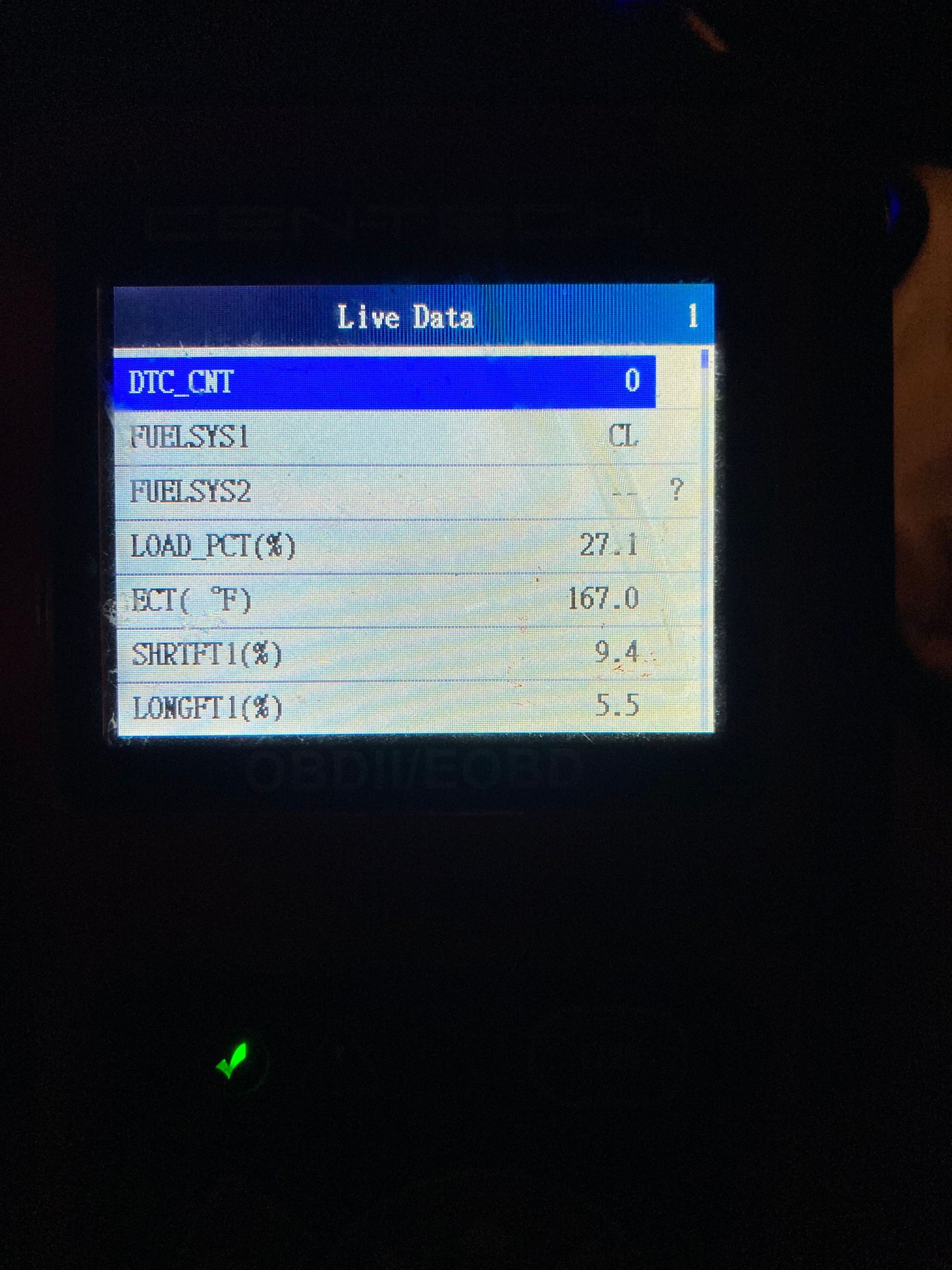

I started the car and drove it a couple of miles and came back. I was excited at first cuz the long term fuel trim was 0, but there's not really any change to the car. It still has elevated short term fuel trims that go to 0 if I'm coasting without my foot on the accelerator. The LTFT was adjusting upwards as I put more miles on it.
It's puzzling cuz even while coasting at low speed, the STFT starts to creep up when I hit the brake and come to a stop. When I got back home I parked it and the STFT was fluctuating between 4.2 and 8.6 for the most part. Out of curiosity, I stepped on the brake repeatedly, and when I did that I was able to make it go up to 10-11. That does seem like it could be normal though. When you press the brake, you're activating the brake booster, which should cause the engine to run somewhat differently. Am I wrong about that?
A vacuum leak does seem like the most likely scenario at this point, but like I said, I did spray brake cleaner everywhere. And the STFT does not go down when I accelerate like in my Dad's car that probably has a vacuum leak. And in my car the STFT actually does go to 0 when coasting.

I've been constantly checking my fuel trims while driving. Long term is usually about +6 or +7 at idle at a traffic light. Short term is usually between +4.2 and +8.6 at the same time. When I first turn on the car, the short term is usually like +12 or +14 if the car is cold. That's not normal.
