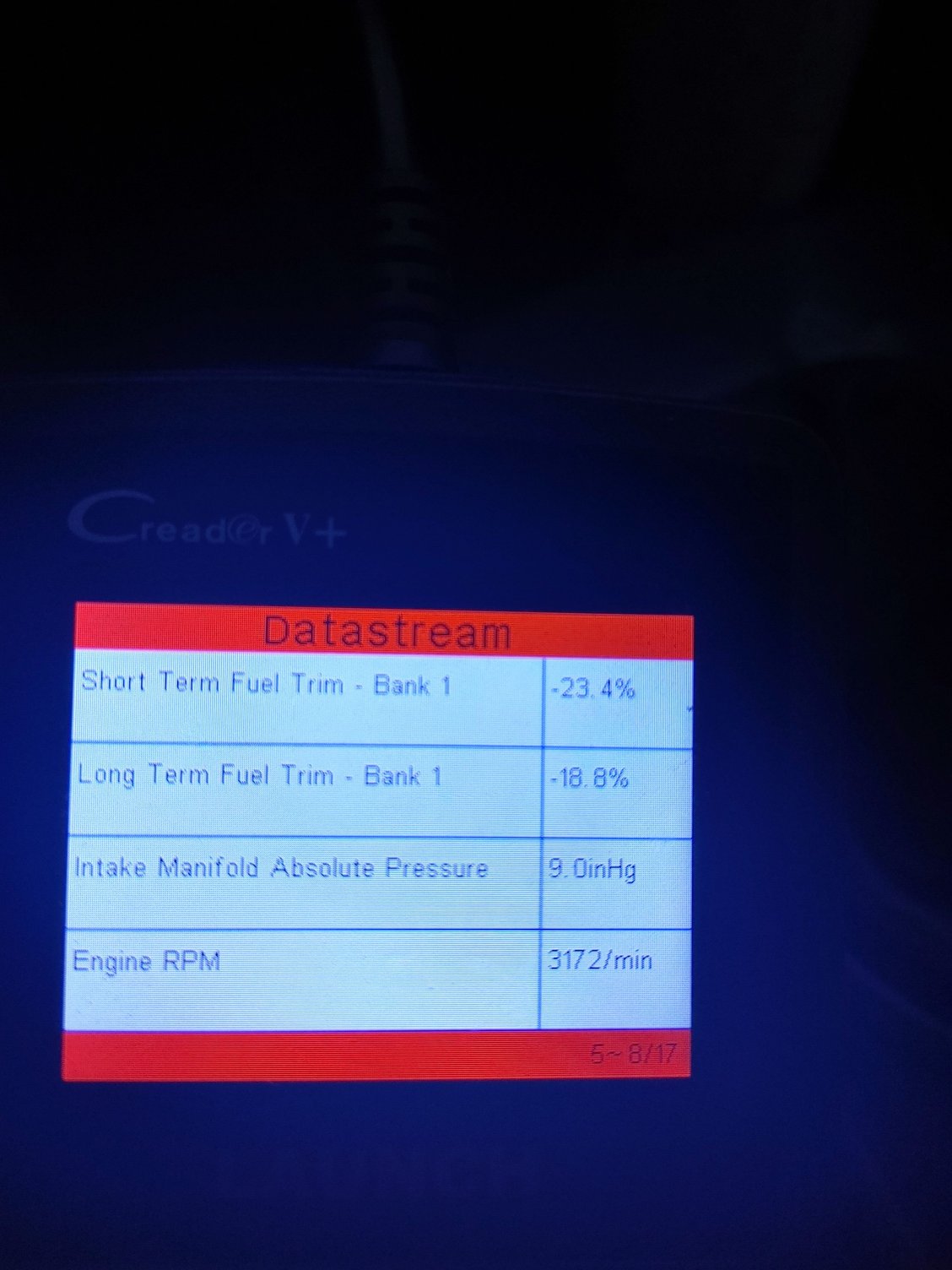

*EDIT forgot to mention my fuel trims seem to be way outta whack.
