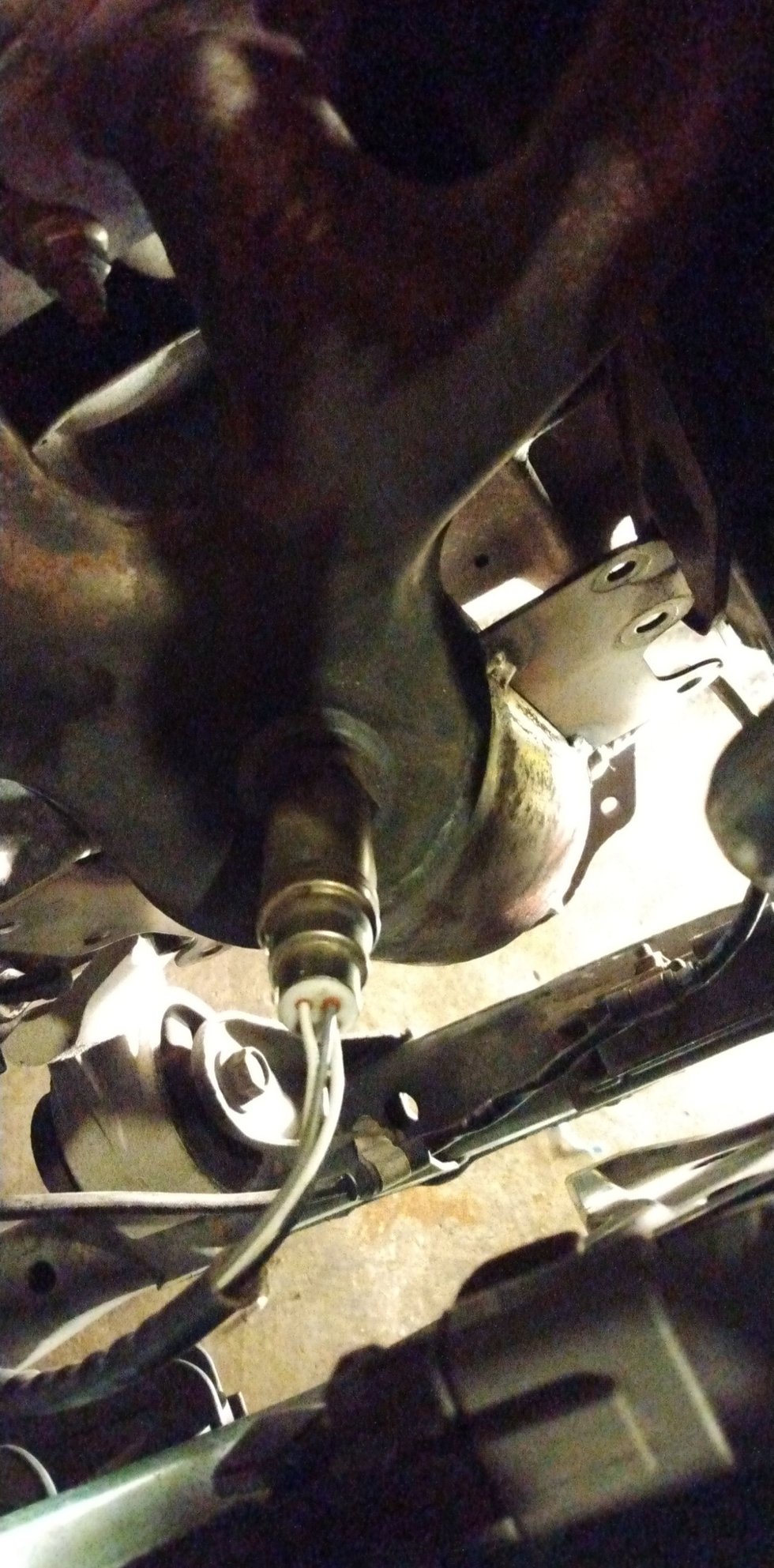

pic of 02 there one down to the right where you can see the wire.

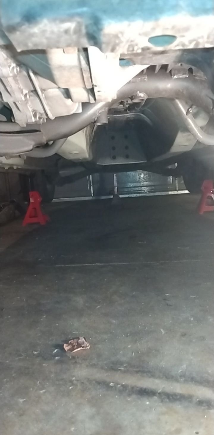

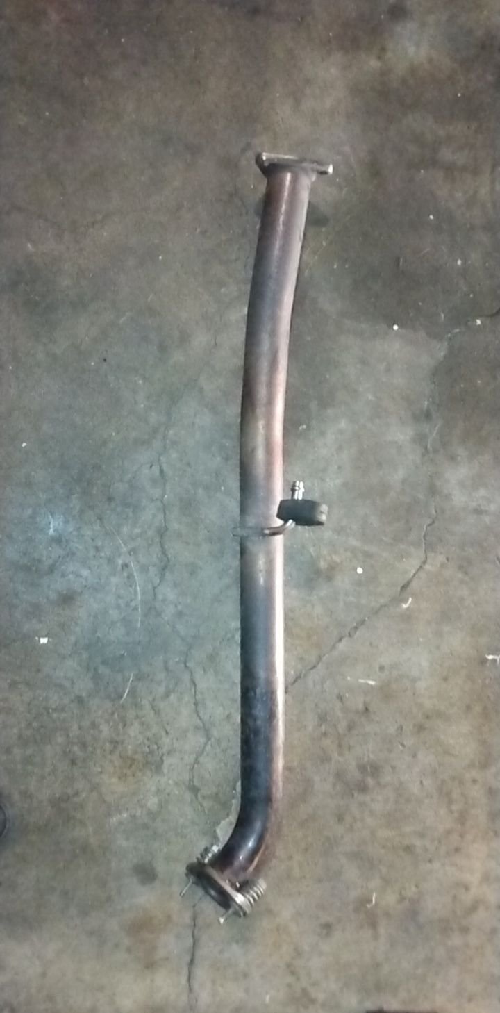

pic of exhausts you can see left one is new and its 3 inches longer, and pic of downpipe you can see bend.
you can see the bends and kinks in all of them after being back into a solid curb to a dead stop.
at first thought my engine shifted but it runs perfect so checked exhaust cause sputtering and smelling exhaust and sure neough all gaskets and it weldsbroke and seperated
