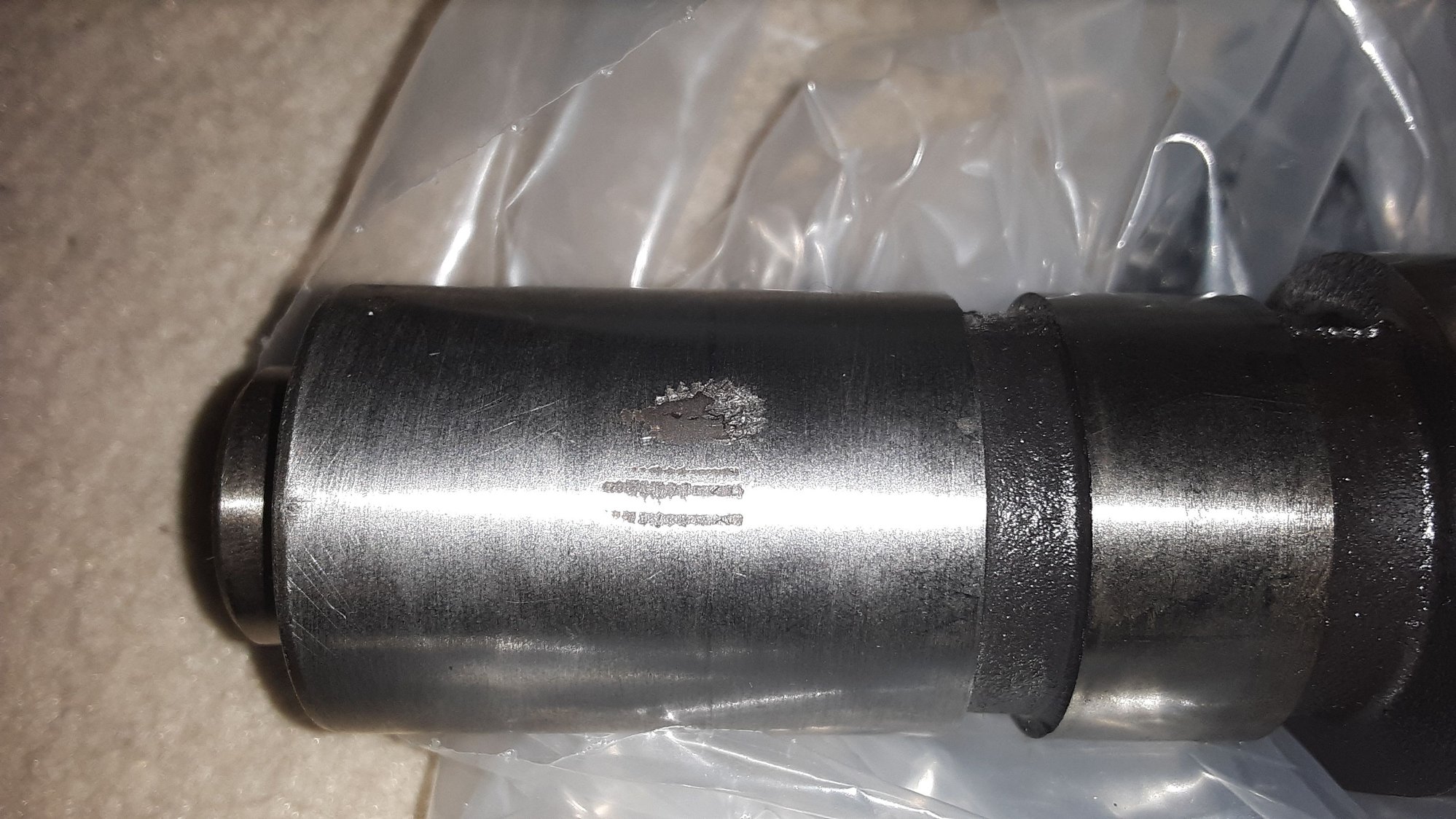

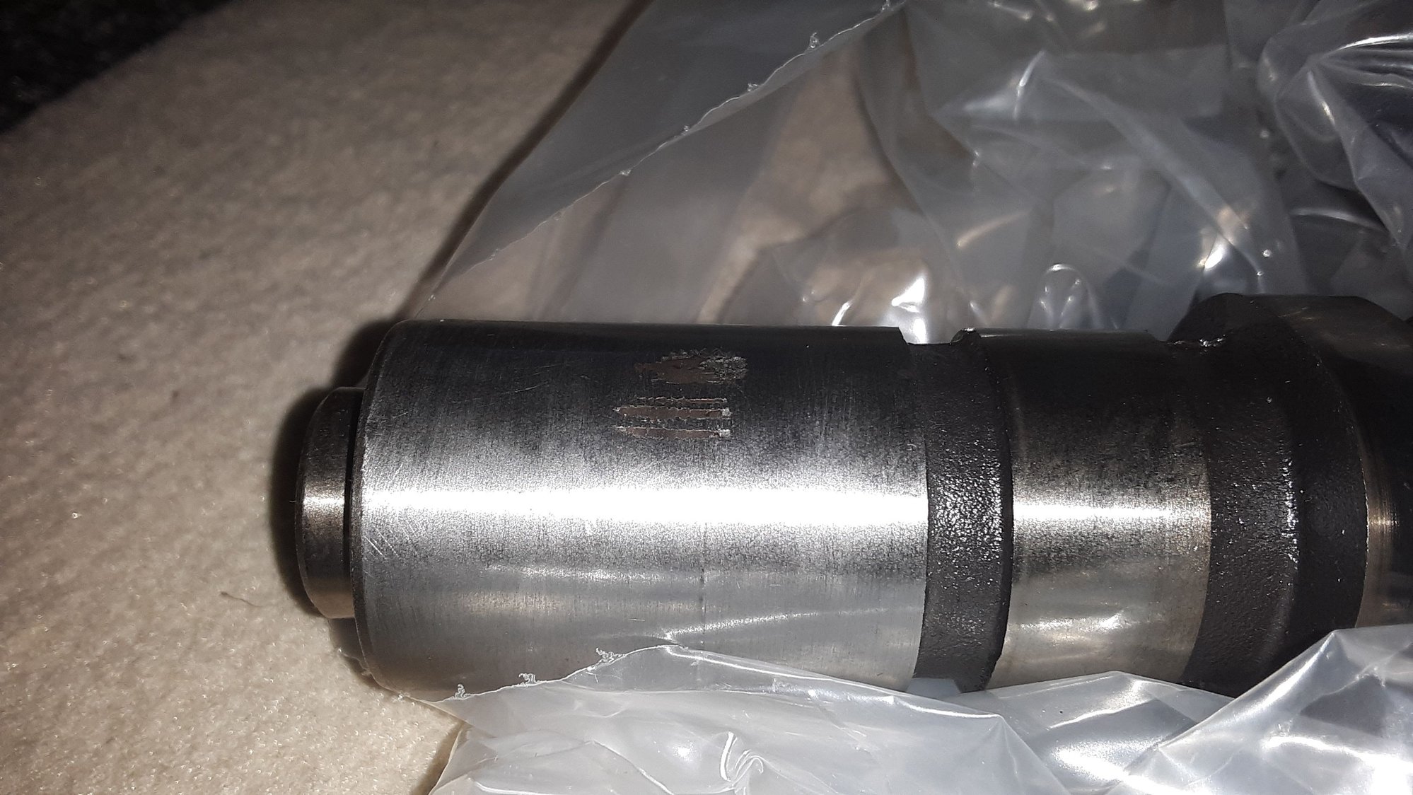

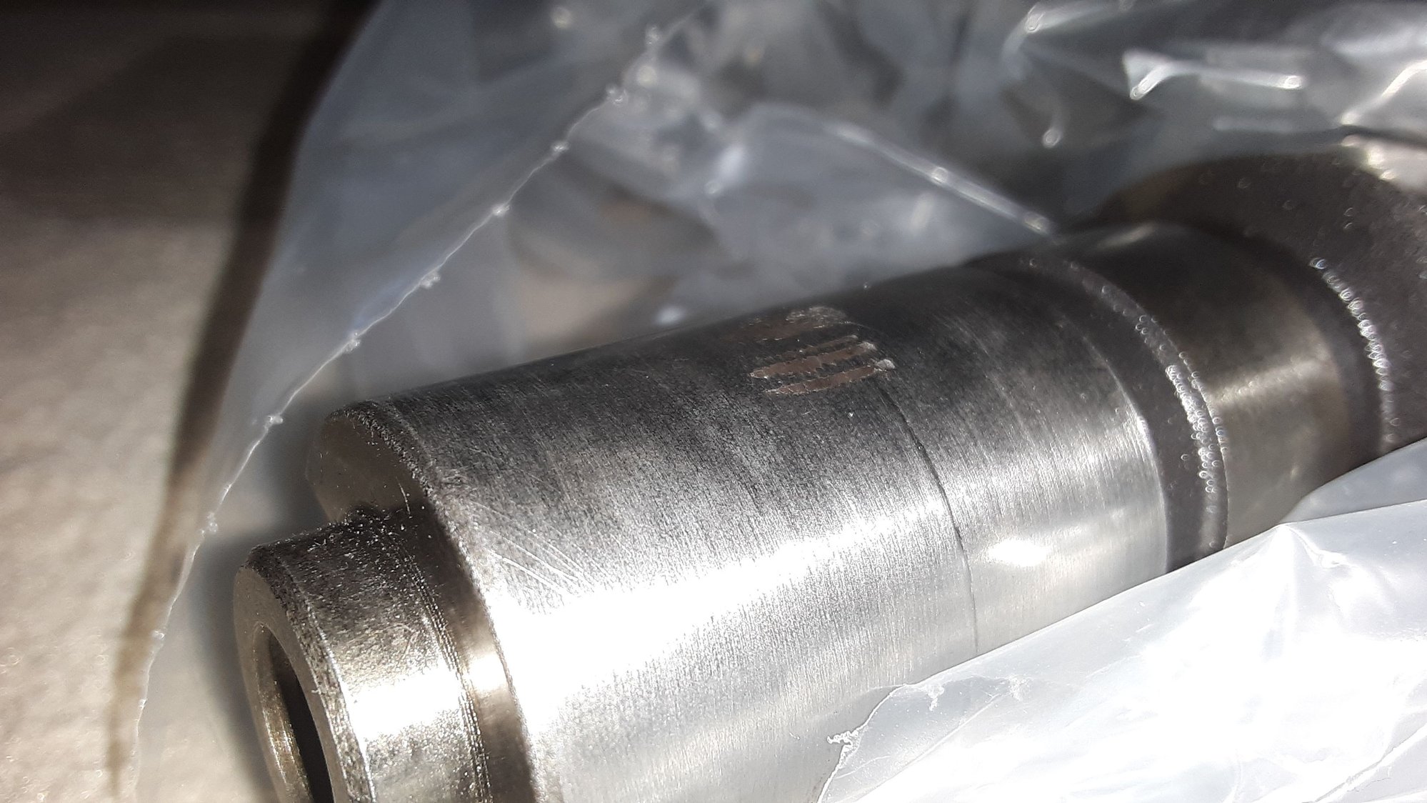

Cost for checking the cylinder head was $112. Not bad. They didn't have to do much. They just checked it and cleaned it. The new seals were not used since no problem was found. The deck must be flat also since they did not mill it.
Below are some pics of the scrapes on the end of the camshaft. You can see how I tried to fill it in with JB Weld. It wasn't enough apparently.

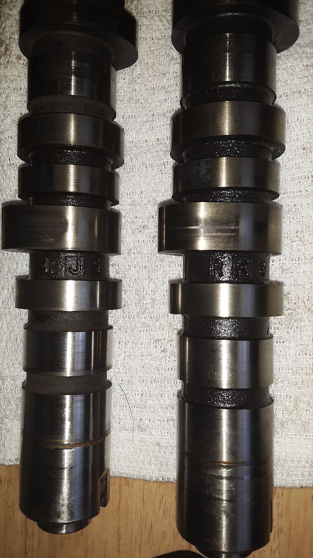

The cylinder head I purchased arrived super fast. I received it three days ago, so that was awesome.
I removed the camshaft from it and it looked pretty good...no scratches or scoring. The only difference was the part # (code) etched into the shaft. This one was "RJ5" while my original one was "RK8". I laid them side by side and they appeared to be identical. A few measurements with the calipers showed the bearing surfaces identical. The lobes may have been ever so slightly different...maybe .005"-.010" difference. But I wasn't being all that precise taking the measurements so I don't know.
I went ahead and installed it. I think it'll be fine, but we'll see.

I installed the RJ5 camshaft, and got everything back together. I've been driving the car now for over 500 miles with no issues. I did get a knock sensor fault code when I first started the car up, but it never came back after the code was erased.
The engine performs identical to the way it did with the other camshaft, as far as I can tell. So I'd say the different codes might be related to origin of manufacture location or something.
