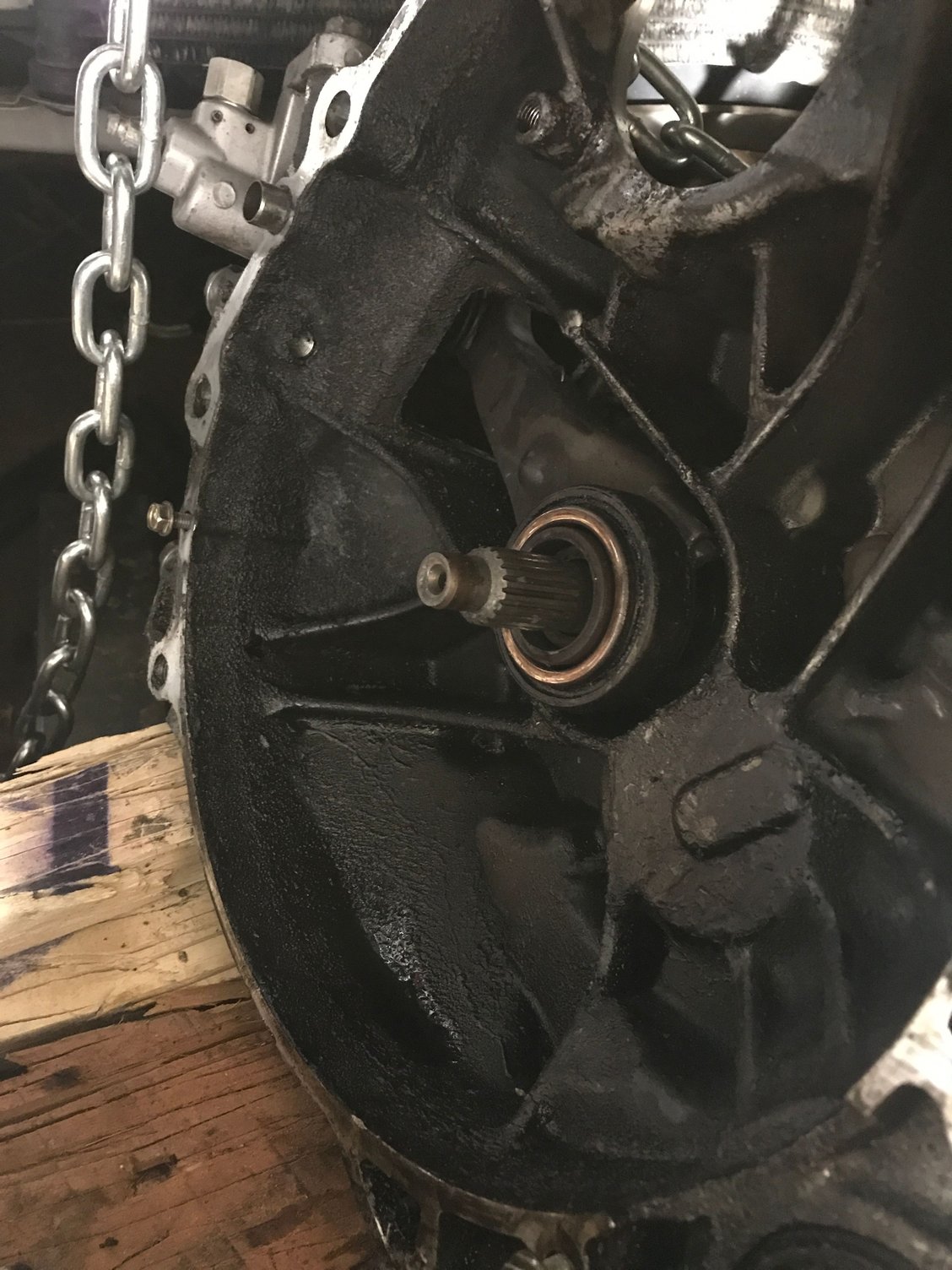

5 spd m/t
Thoughts and opinions

You have two options (that I can think of). Rear main seal on the engine is leaking oil or the input shaft seal on the transmission.

Were you constantly adding oil to the engine or transmission? Is the transmission really low on fluid? If the trans is still full and you haven't been adding any that would indicate it's the engine.
If it were me I would clean it up the best I could, replace the throwout bearing (and possibly clutch due to oil contamination), and replace the rear main seal. Of all the different Honda's I've worked on I've never seal the transmission input seal leak but who knows, that is a lot of oil/fluid/grease.
Alright, that actually makes perfect sense since I was having to add quite a bit of oil to the engine and could not figure out where the heck it was going. I had replaced everything but the kitchen sink when this horrendous knock started. I guess I will replace the rear main and then sell, as I have already purchased a newer replacement engine, in order to recoup a little bit of money. Hey many thanks and if I knew how to give rep I would, lol
