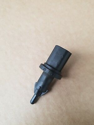

Should come out with a bit of coercing. It's literally just friction fit by the rubber grommet, and a little bumps of sorts to keep it in place. Carefully wiggle the hell out of it while pulling and it should come out
Here's what the sensor looks like, so you know what you're working with:
