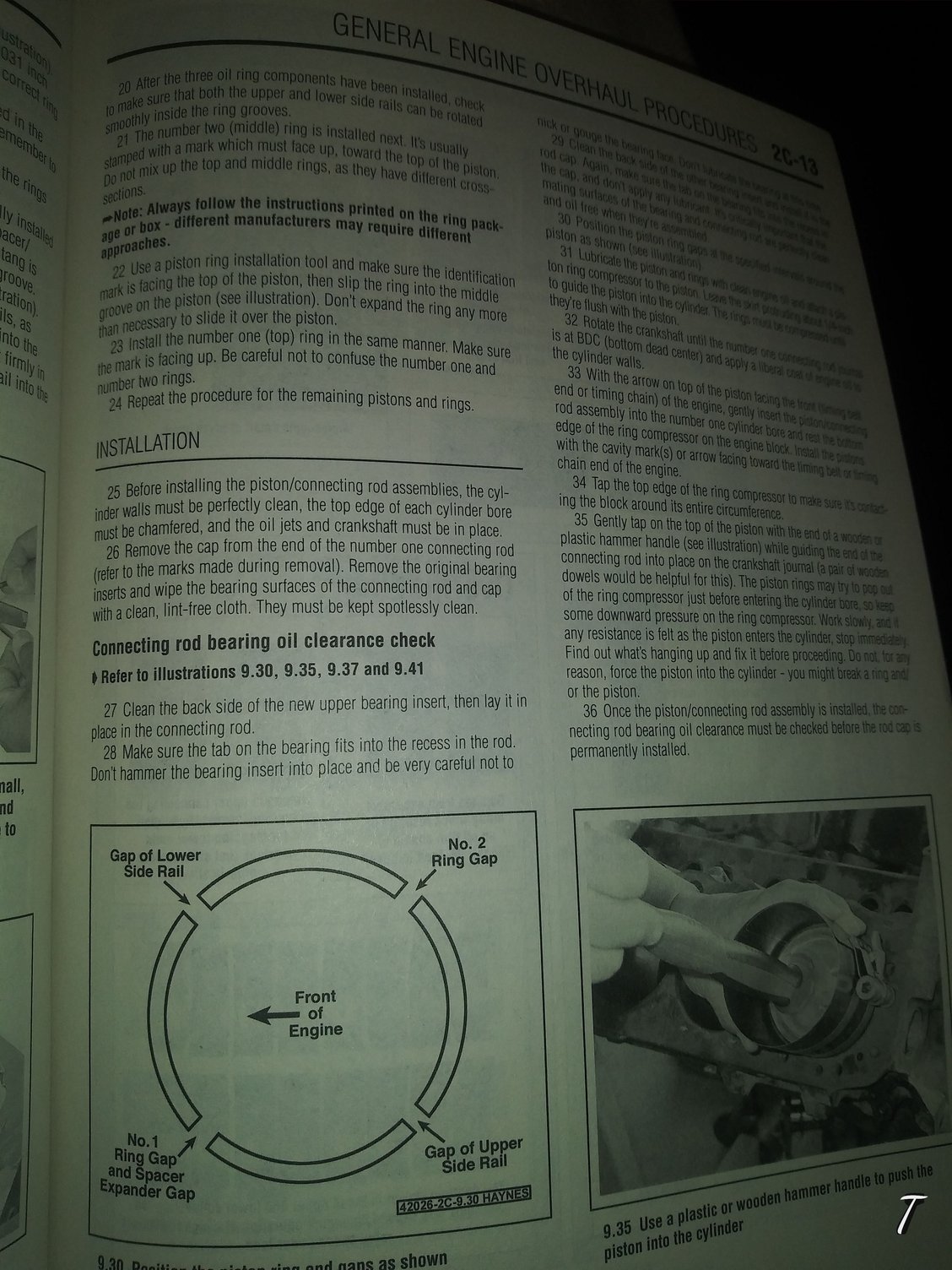

no its not but i got the book after i changed the rings. what the book shows me on how to gap the rings, its different from how i gap them and i dont think i have the compression that i had before. I didn't know nothing about break in rings either so that wasn't done also.
and i didn't know that i should put the rings down in the cylinder check the gap with the feeler gauge before i installed them. And one last thing, its the same feeler gauge that use to do valve adjustments is use to check the ring gap? I just want to do it right. And when i was doing the rings noticed a slight burn in about 2 of the rod bearings so i might just change those to.

Piston position
It said general engine overall but Those this illustration works for SOHC and DOHC as well.? . Its just rings gaping I'm talking about mainly.

If you're not burning oil do a compression check. If it's within spec I wouldn't worry about it. Redoing piston rings is a lot of work.
-Yes you put the ring the cylinder first to check the end gap using a feeler gauge.
-Yes you should have orientated the rings like in the picture.
-Lots of people have different opinions on ring break-in procedures. Some say none is needed, just don't use synthetic oil at first. Others say you must use break-in oil and drive a certain way after startup.
