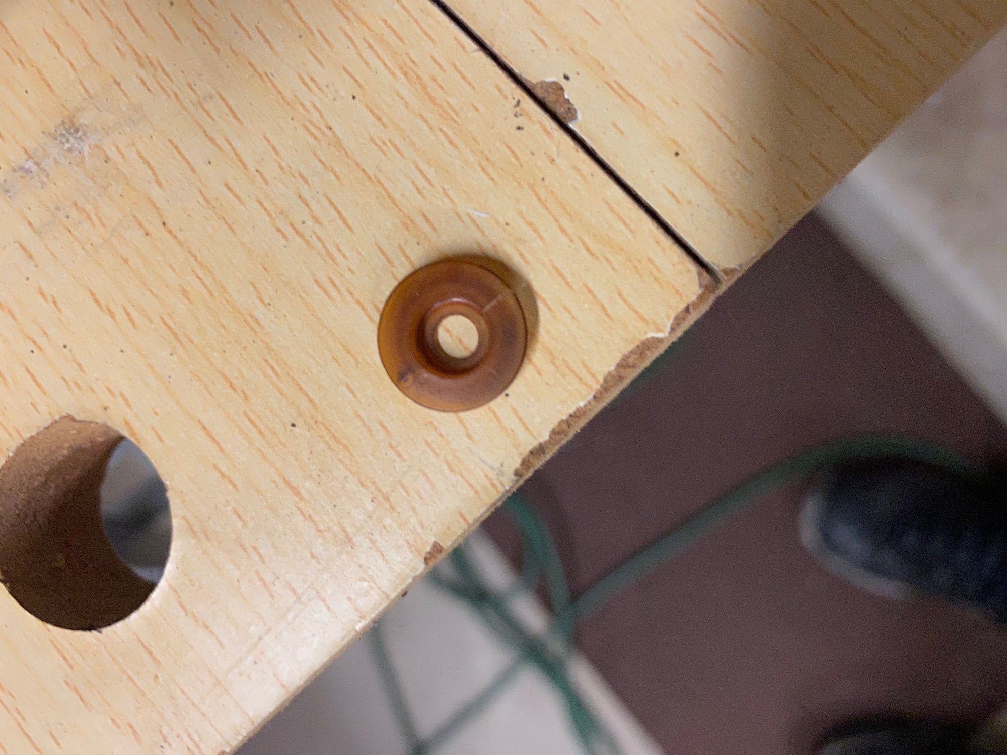

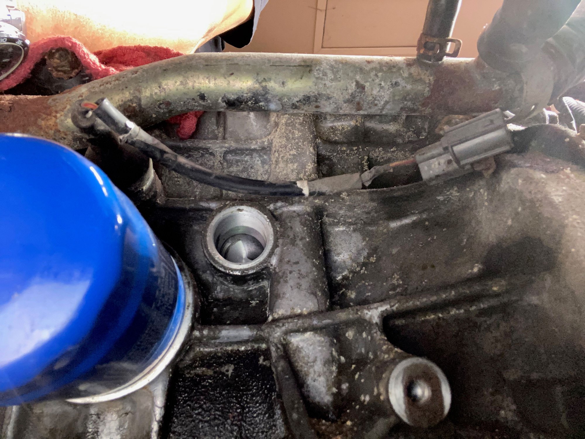

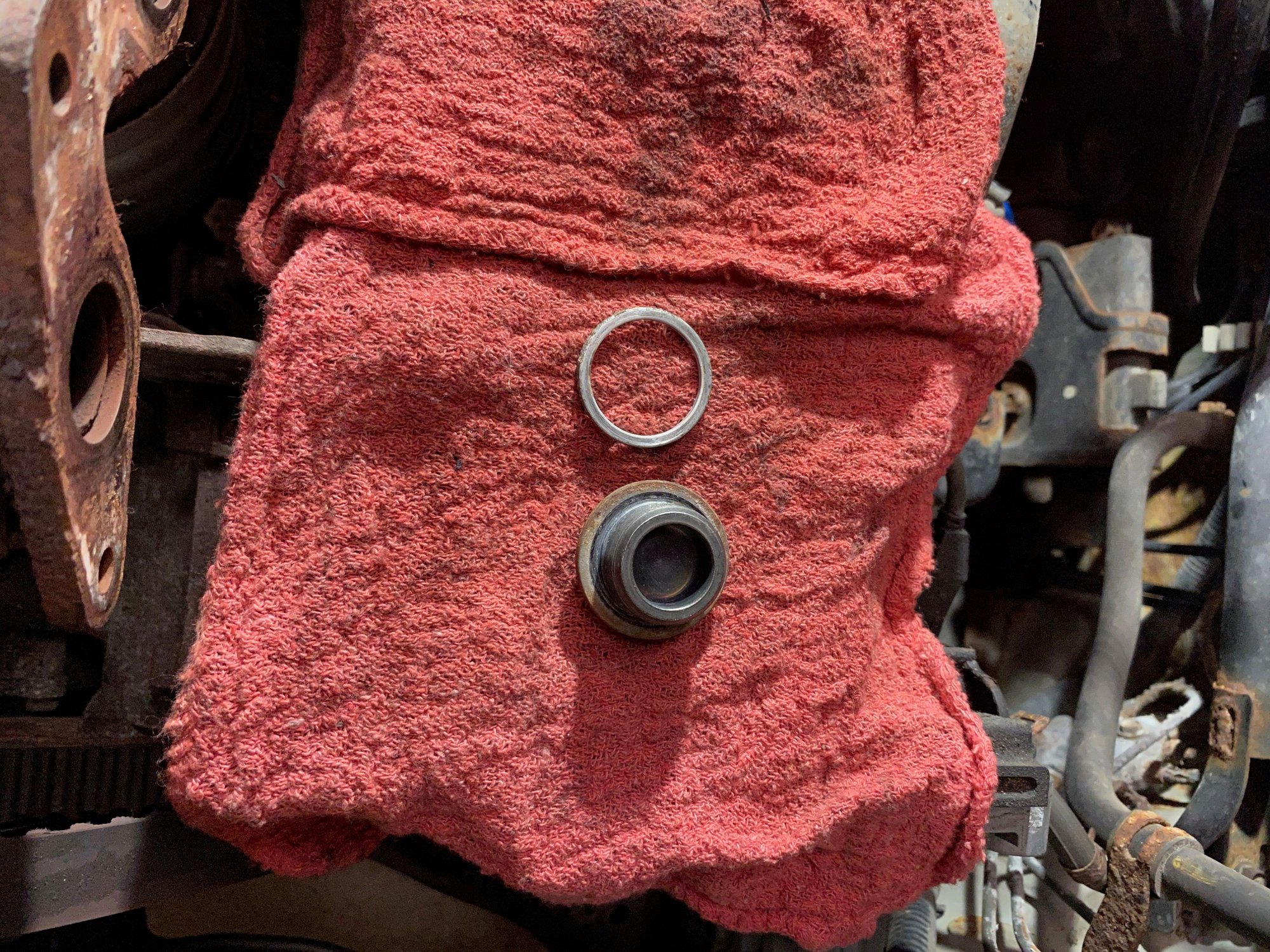

A couple of other questions. I removed the rear drain plug on the block next to the oil filter to drain all the coolant out. Can I reuse the washer, and what is the damn torque for that thing? Cant find it anywheres. Also, one of the plastic caps on one injector split, do I need it? where can I get a new one? I replaced the seals on the ends of the injectors and only one split.
Fork if I know, Personally I'd reuse the washer and smear the gray hondabond rtv on both sides, and some of the threads. Install immediately. The aluminum washer is supposed to squish to seal at a certain torque though, and the rtv is insurance lol
Got pics?

Plastic cap that was on the end of he injector. Split can been seen at 2 o'clock position.
Cap on the end of injector.

Location of coolant drain/plug at back of block.
Plug and gaskets. Honda can get gasket for about 5 bucks.

This didn't upload last time. Plug and gasket, gasket 5 bucks from Honda. Must be gold.

I just bought a new Gates belt, it was 13 bucks. By the way, the large plug that is pictured is where the factory block heater would go. Dealer had the gasket and the torque is 44 foot lbs. The car is back together and purring like a kitten. I refused the head bolts. I also found the littler plastic end caps for the fuel injectors on eBay as a rebuild kit. Like 19 bucks.
A lot depends on why the cap is on the injector in the first place.
Does it support the O ring? If it falls off the tip of the injector, will the o ring be free to slide down?
If it falls off, will it drop all the way through the injector hole and get chewed up inside the engine?
If it falls off but the hole is too small for it to drop inside the engine, it may block part of the hole and disrupt the fuel spray pattern from the tip of the injector.....

From what I could find around the net is that it protects the spray nozzle. When its in the intake properly I don't see what use it is. The rings are not gonna come off at that point. The caps do snap on, but with the crack obviously it was loose, and I didn't want to chance it falling into the intake and not knowing it, cause when the injectors are in place obviously you can't see the tips if them.
