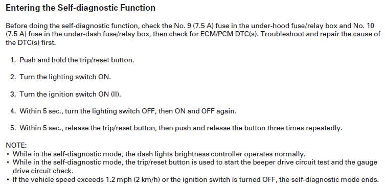

I believe there is a cluster self diagnostic test but I can't find anything in the service manual. Below are directions for the RSX which is hopefully the same. If so the gauges should sweep from minimum to maximum and then back. This would rule out the cluster having an issue.

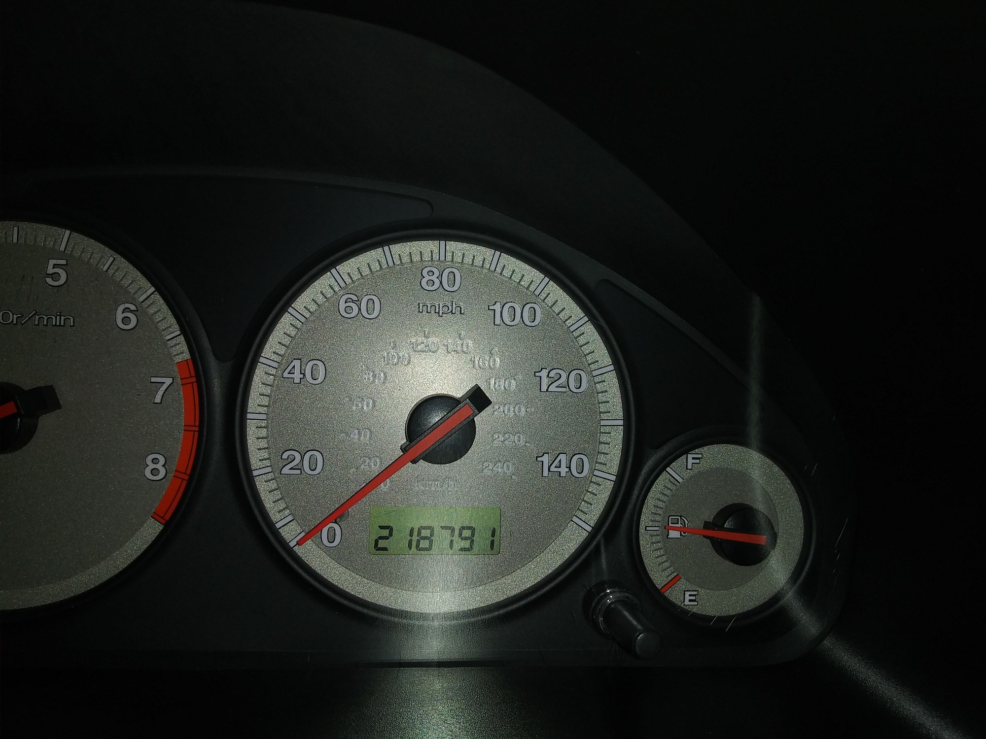

Ok, so here are two pictures of my gas gauge cluster. The picture with the one with needle almost on half a tank is the one i took last after i made it home. The other one is the one took it before i leave work. If you can see the difference in between and i only drove less than a mile from work and the same to work.. I remember a few months ago i was doing an idle relearn so the engine was running but i w low on gas to. While the engine running the red light came indicating me that i need gas so while driving to the gas station ,the went from empty to just about the bottom mark. Thats how it operate. Before it started giving this bad readin, when i
full up my tank, it would go over the that top stroke and i could drive for a week before it dropped to that full stoke. Now its giving all these bad reading.

Did you try the cluster self diagnostics?

I did the test and all the needls move from bottom to top and down again. If that test was fine,why I'm getting this bad reading from the gas gauge? It wasn't like that before so whats the problem?

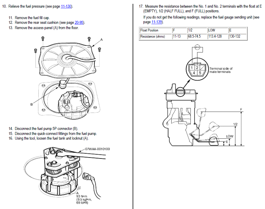

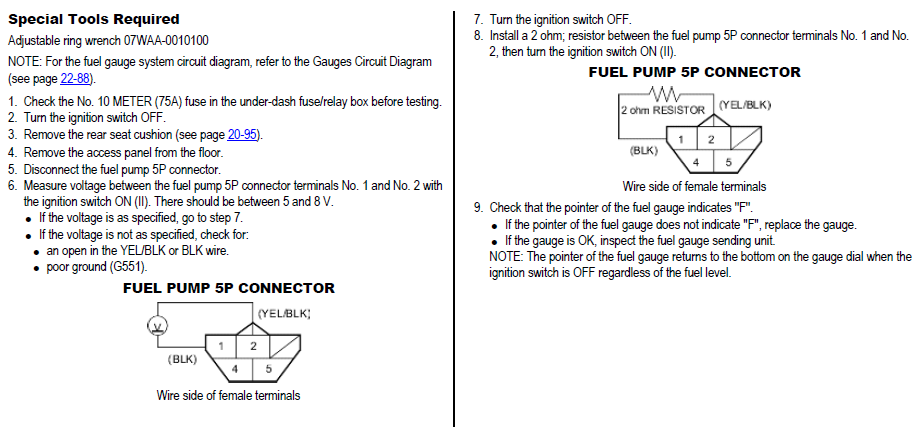

Due to the fact that the fuel gauge correctly swept up and then back down during the self diagnostics it would indicate that the issue is with the fuel sending unit which the float is a part of. Below is all the troubleshooting for the fuel sending unit.
Another option is to just ignore it. It seems to give a somewhat close reading, using that and trip mileage you should be able to figure out how much fuel you have left.
