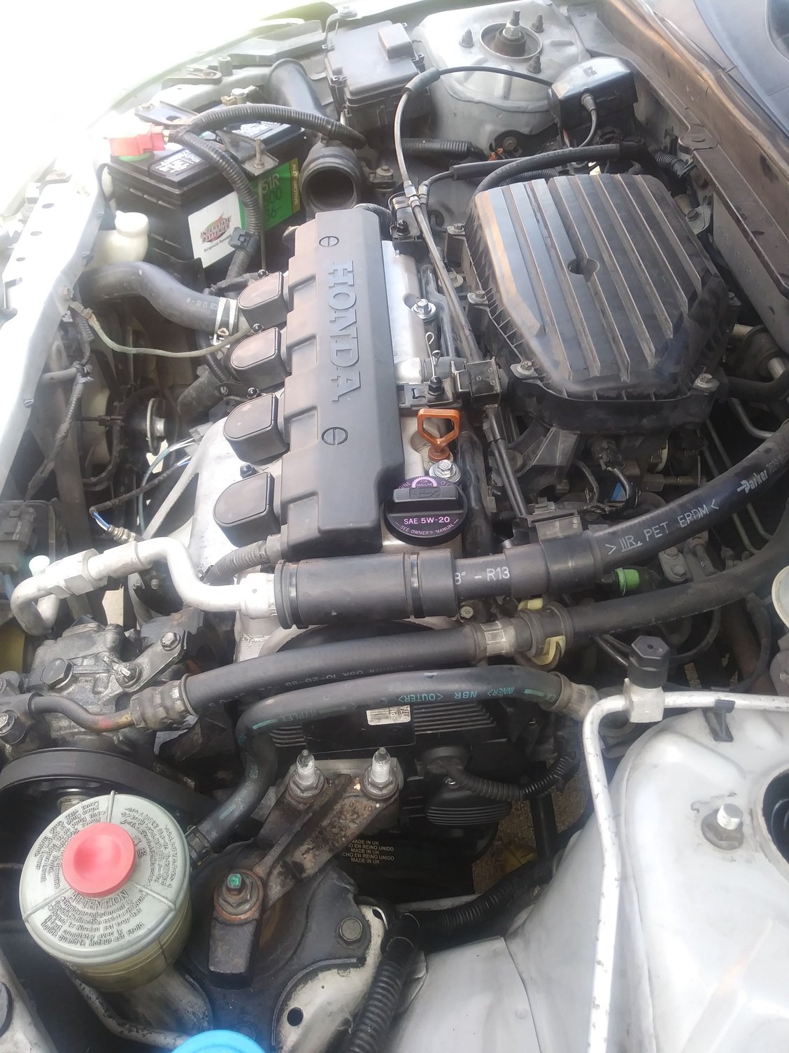

torqued to 8.7ftlbs and is the 4th time to replace the oil pan gasket this year. I'm doing everything now oil pump o ring which looked fine still and Crankshaft seal those 2 honda genuine, the new gasket I got was through ebay and said made in Japan not genuine but will see. I'm guessing my oil pan may be the problem needing a new one since the surface does not look even or flat. Also I forgot to get hondabond 4 since I don't want to use any other anymore and will see tomorrow if I can go to the dealer again. I'm also having problems with starter motor which I took apart and the power steering pump. 05 civic lx

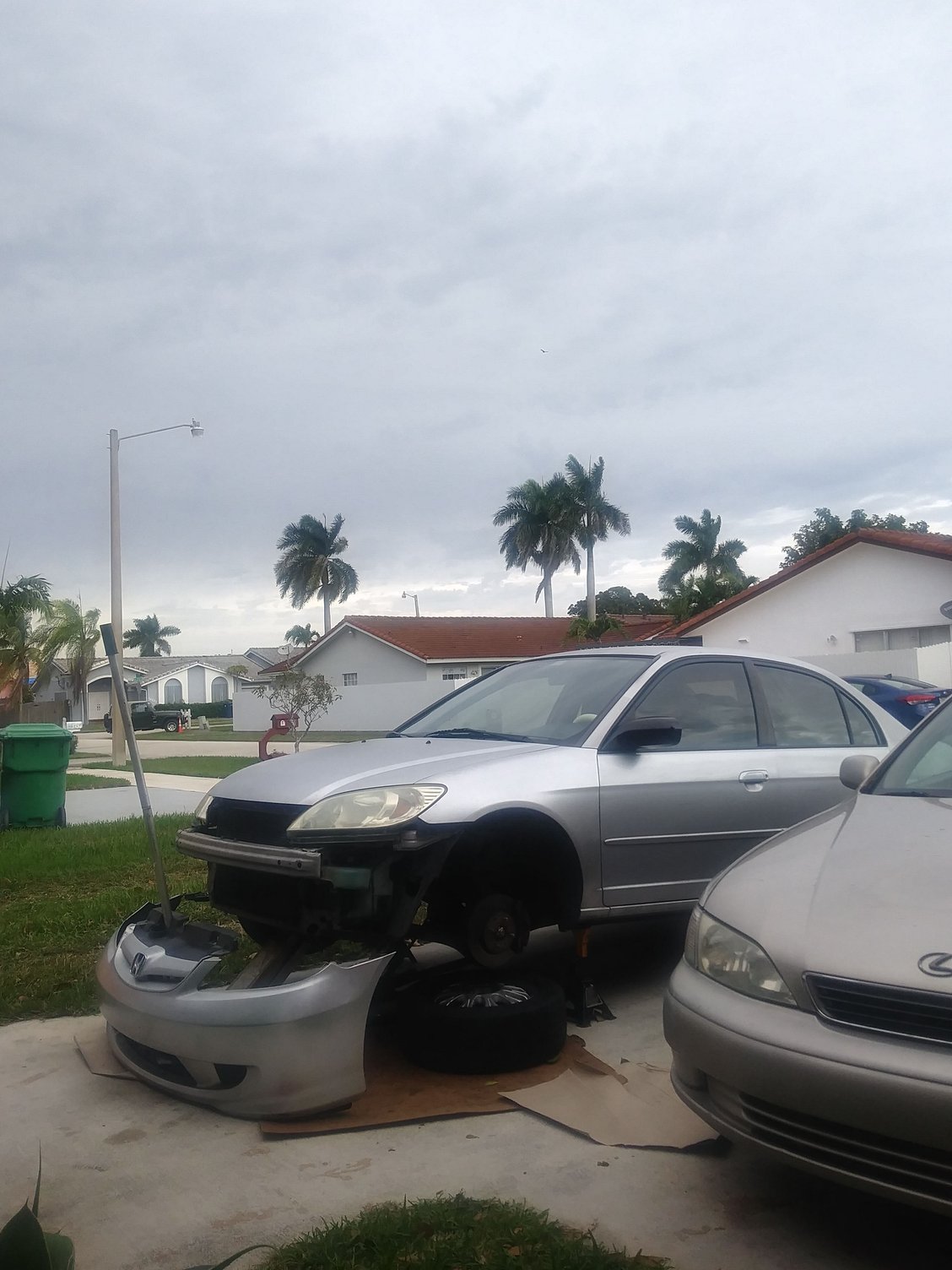

Bought a new oil pan the old one was uneven bent and that was the main problem. Got the oil pump and oil pan installed now. My next headache is setting the timing belt back on and I did some marks on the crankshaft but I'm guessing It was useless now and I didn't take off the top cover yet just the lower side. My question is do I need to take the whole valve cover out again to set the timing belt again in place ? Is it possible to take top side timing cover without removing valve cover? I did that with genuine gasket, water pump and belt new this year and all went so well and I don't want to ruin the valve cover gasket. can I reuse it? This is so much trouble all should had been set from a begining and I fail without knowing anything at all. I didn't change tensioner and I need new starter motor and power steering pump too. This is costing too much

I'm done, thanks you all who shared that knowledge. Everything looks good so far and still have other many things to fix. I cleaned and sanded the starter motor and still failing to start just not as much as before, selenoid activates and the starter motor fails to ignite and I wonder what makes that happen. The starter makes such beautiful sound now like smoothly not so loud noise as before. I need a power steering pump also.
What happened with the stock oil pan was that the first time I changed the gasket I thought the studs washers were bind to it and that I believe caused the pan to bend and also that I torqued them to over 11ft lbs and that damaged the pan and I couldn't tell so it kept going bad when I added other gaskets. That's all
