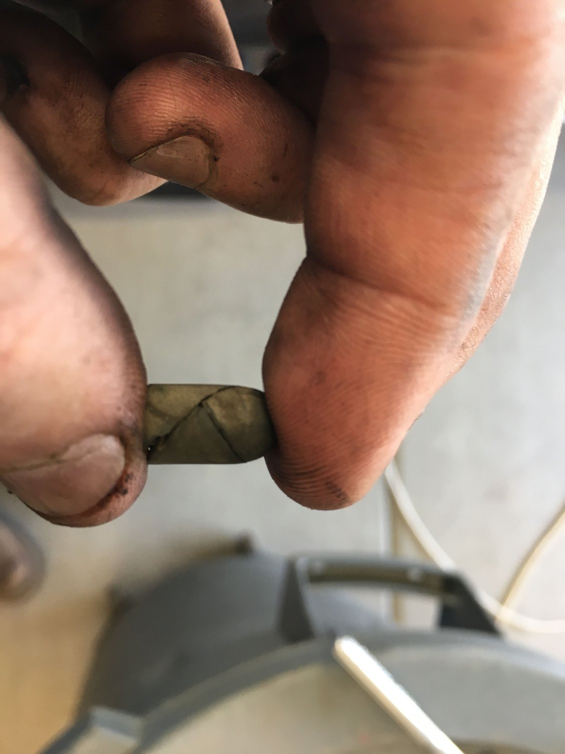

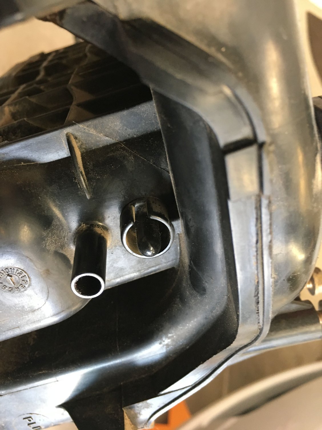

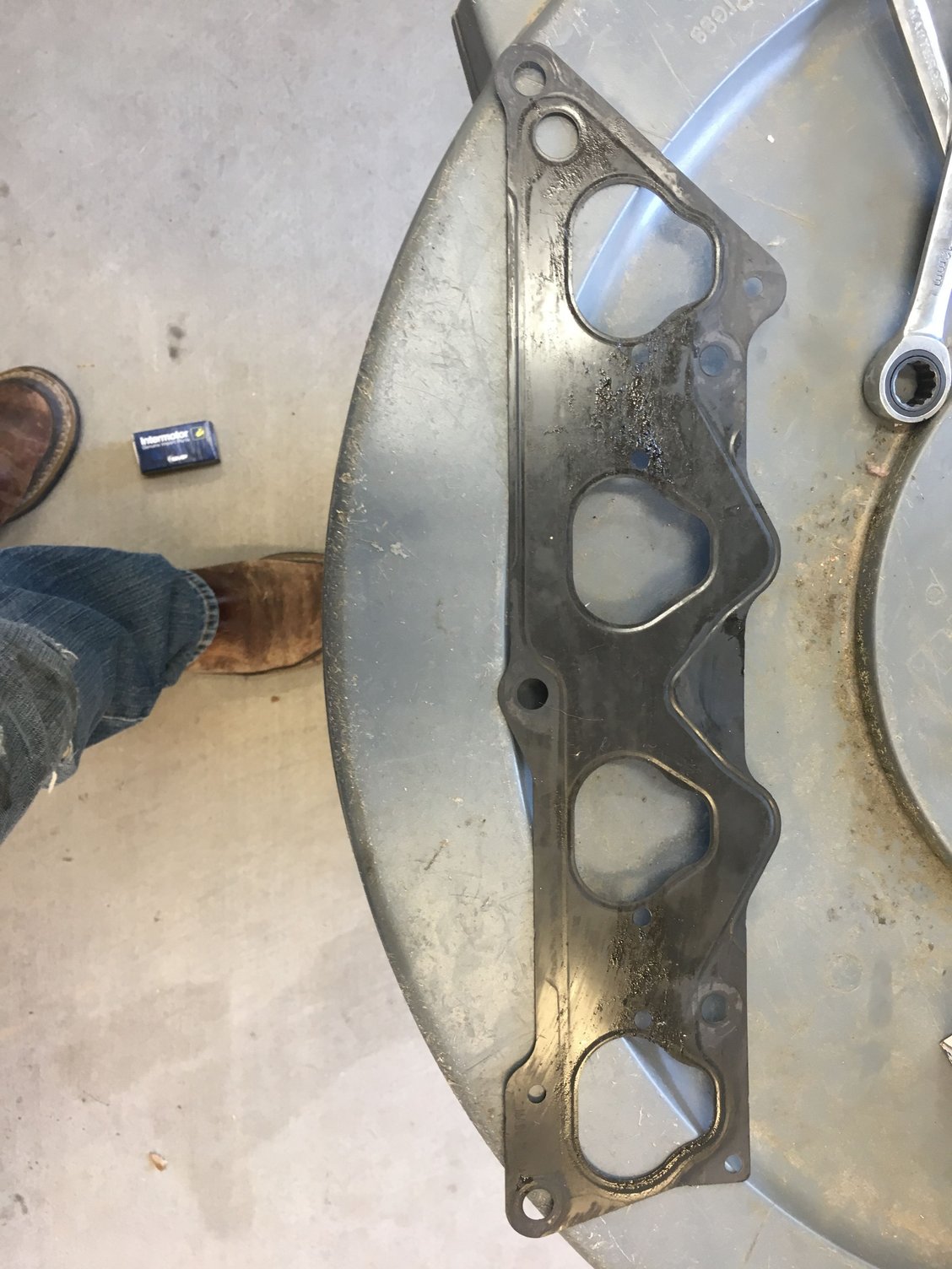

So i tore into the car this weekend and found some issues along the way. I replaced the intake gasket which was a incorrect felpro gasket EGR gasket on a non EGR car (so someone has already been into this car), i found multiple loose bolts along the way, i replaced the 4 rubber intake gaskets, the throttle body gasket, all 8 injector Orings, and the PCV valve. I also found a small rubber vac cap that was cracked which was directly above the PCV port on the intake. I got that replaced and put everything back together torqued.
I performed the relearn on the car after all this and found that my cheap amazon IAC made the car do the idle hunting thing (up and down over and over). I swapped the original IAC back on the car, did another relearn and that hunting idle stopped however it still wants to idle at 1300-2000. It does feel better, but its still not correct.
I am thinking my next step is to do another carb cleaner spray test to verify no more vac leaks at the intake, injectors, throttle body, and around any hoses. If that checks out im thinking i might pull all the vac lines off the intake and plug all of them with caps and see if i can get the idle under control. If so start replacing each line and checking for correct idle till i find which line is causing me the issues and fix. If nothing changes with all Vacs off and capped i might try putting my finger over the IAC port inside the TB and see if that slows the engine idle as a test to see if the IAC is truly controlling. My code reader cannot see the IAC% but i can see other things like throttle pos (which seems good), engine temp (seems good)
Do you guys see anything wrong with my test logic or is there anything else i should check? I am suspecting the IAC, but i dont know the best test to verify. I "think" i have the vac leaks ironed out but my IAC is the original and im not sure its working properly.
