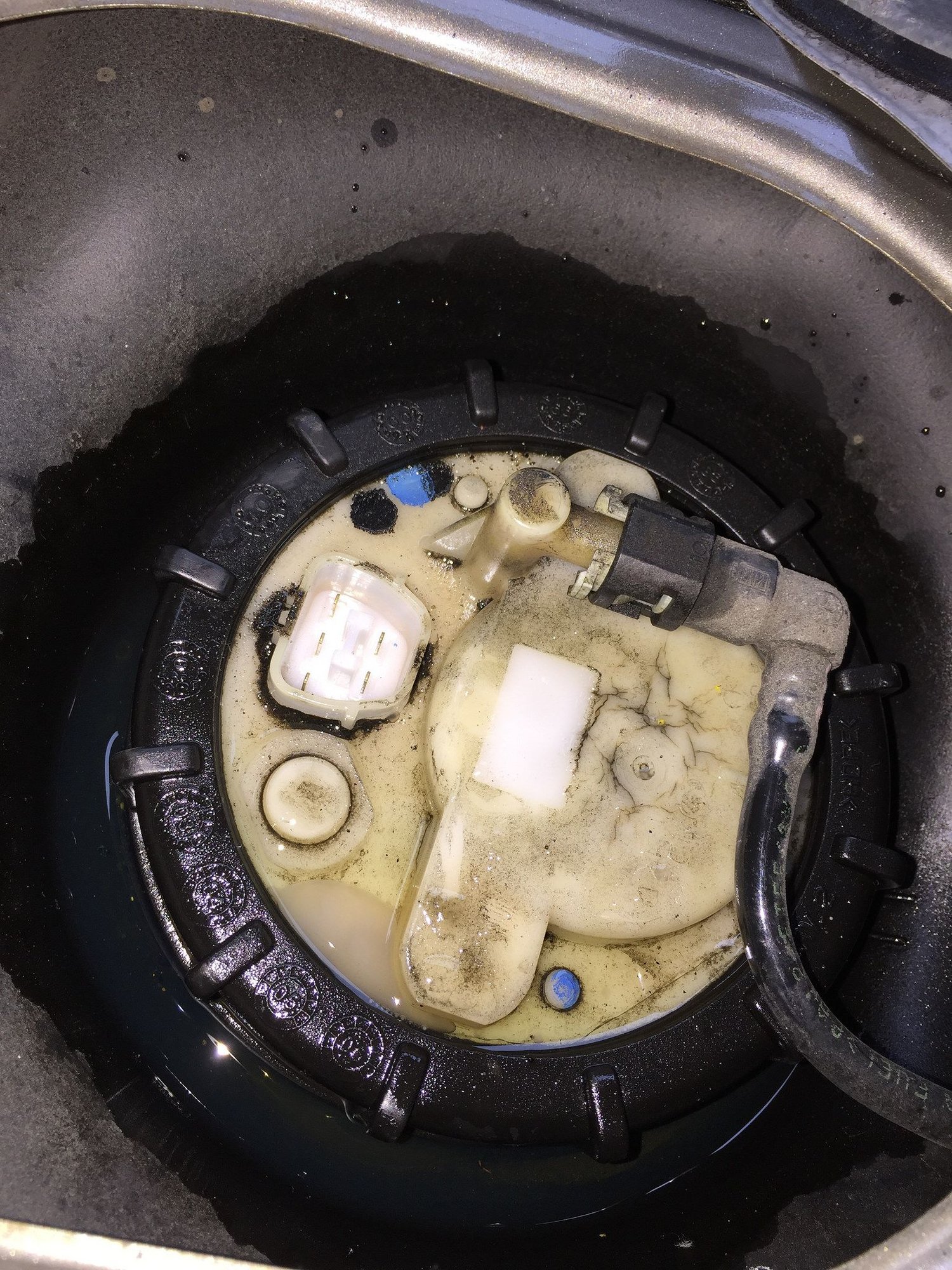

Thanks again guys for the reply''s! That raw fuel is freaking me out for sure that's why I want to dig into this sooner then later! Thanks for the pictures as well. I report my findings back here for sure when I get a change to pop the seat and have a look at that pump. From the strength of the smell I bet it's cracked there. It's not all the time but you get the occasional whiff from time to time. Talk about living dangerously, I use to work at a gas station when I was a kid and my boss would go out to pump gas if I was fixing a flat or something and he would always have a lite cig in his mouth! He would put it on top of the pump while he pumped gas. He did that for YEARS! How the hell he never blew up was beyond me! Sometimes when I saw him walking to the pumps I'd yell, "there is a cig in your mouth!" he would say yea I know! lol Crazy times back then. We actually checked your oil, washed your windshield, and checked air pressure in the tires! I think we were the last full service station in PA to do that. Customers use to love the service and when we got a new customer in for fuel they would be like "what? open my hood?" hahaha ok back on topic!

Well.. I found the fuel smell!! Was like a flood in there. You touch the top and the fuel just leaks out. I called the dealer my price is like $300 some bucks. Delfi from Rock Auto was $170 shipped. Think I'll go that route! Thanks again guys for the tips!

Well thanks again guys for the info and tips! I ordered the complete unit from Rock Auto it was a DELPHI unit for $157.00 plus shipping. Honda wanted $300 and something for it. Rock Auto said it would arrive Tuesday but it showed up late yesterday. Was a piece of cake for the install. My neighbor walked over as he does when I'm working on my cars to see what I was doing. He was shocked I was able to take the old one out and install the new one in the short time he was there talking to me. Gotta love Honda for easy access to things! It was the smoothest install I've done that's for sure. Pulled the FP fuse and popped it right out and installed the new one and off to work I went. No more fuel smell and she starts right up faster then ever!
