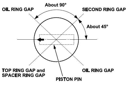

Pull the pistons all the way out. You gotta seriously clean all the carbon out of the ring grooves before installing new rings. Gotta scrape carbon without damaging the grooves (without removing aluminum), which makes it kinda tedious.
Oil ring grooves will be absolutely caked with coked oil, so much they will be completely stuck, you'll have to pry them out.
MAKE SURE YOU MARK EACH PISTON SO IT GOES BACK EXACTLY WHERE IT CAME FROM
don't mix up bearing shells, don't get a piston installed backwards, etc.
Follow instructions on ring install, most aftermarket sets have instructions in the package. Don't install compression rings upside down! Make sure each ring gap is clocked according to instructions
Typical gap clocking (random google image search):
