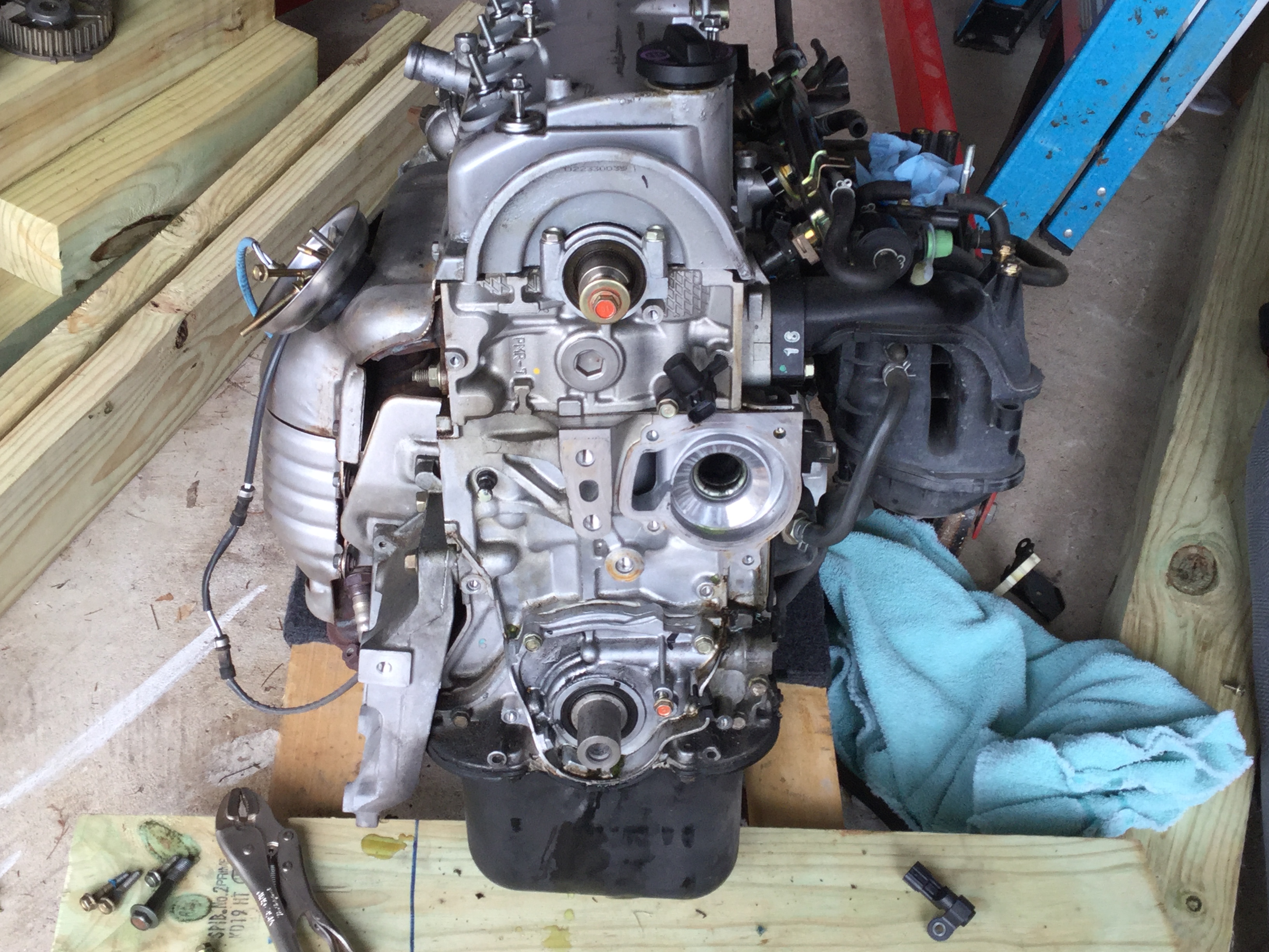

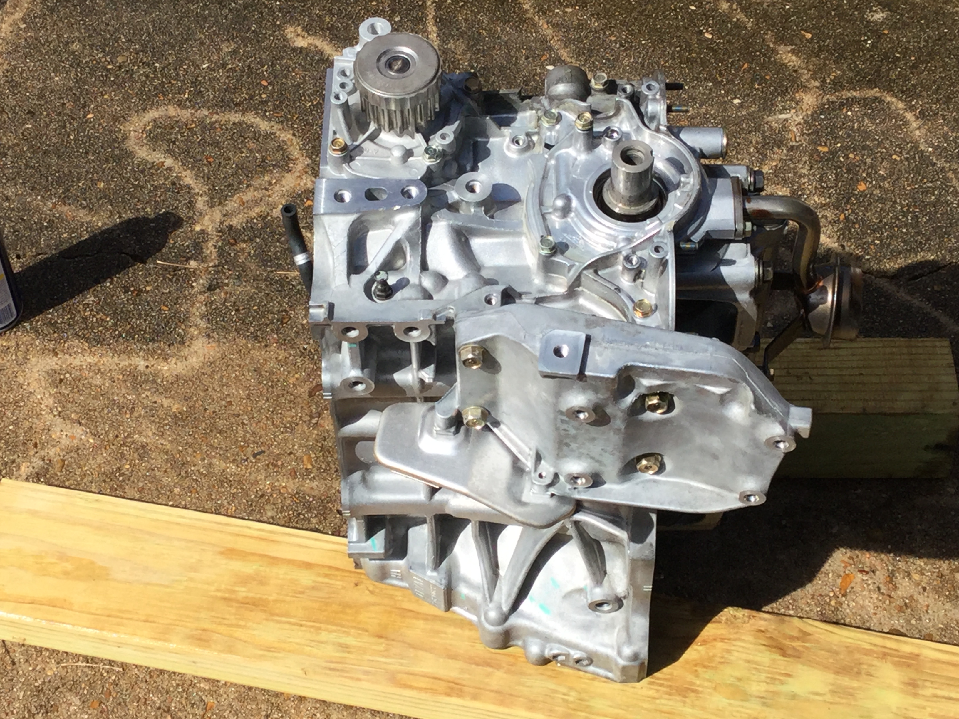

Plan to make this a work in progress thread as I slowly freshen up a used engine I bought to replace the one I have ruined due to poor oil change intervals.
I bought a donor car to replace the engine in my 2003 LX, it was a fresh and shiny (yes paint was in near new condition) 2002 LX that was listed on insurance auction. I saw it listed as 74k miles with rear end damage..
Won the auction for 650, insurance company had reserve of 900 but they met my counter offer of 750. By time fees and towing were tacked on I spent $1300 to get it on my driveway.
After pulling the engine out two weeks ago it mostly has just been sitting in my garage while parts I have ordered are in route. I received the new valve seals yesterday so today I decided to tear down the new engine a bit.

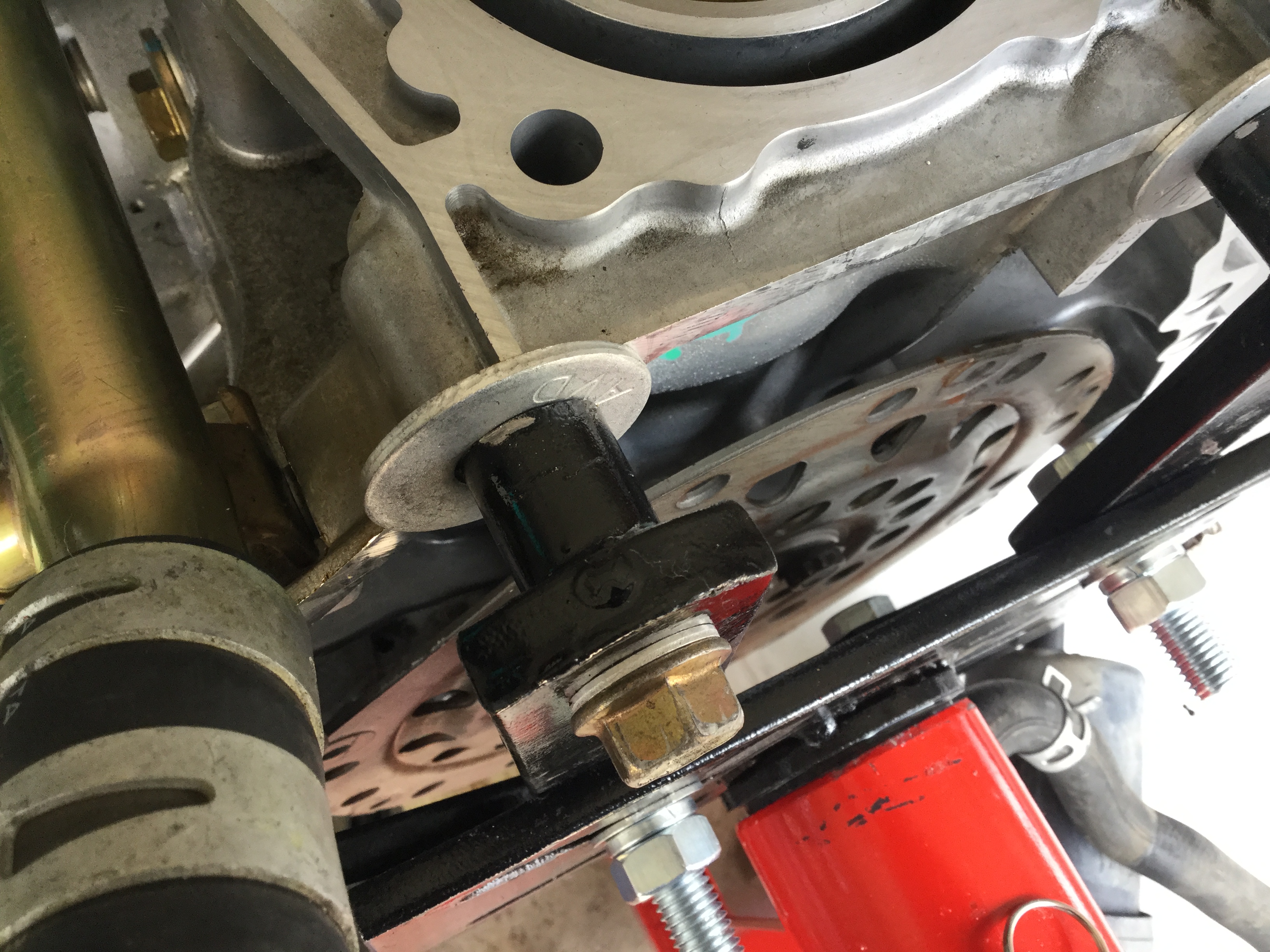

Located the pulley holder I bought like 7 years ago, regretted not loosening the crank bolt while the engine was still in the car. Got out my 2foot breaker bar, impact socket, 1foot breaker bar (old broken craftsman that is locked both ways) , wedged some wood as support and started to apply force and pop bolt came loose with virtually no force..
Now I have speculated in another thread that bolt does not really encounter much more than a minimal force due to keyway so I was not immediately concerned. Then I pulled pulley off very slowly and to my surprise... no key in the groove.....

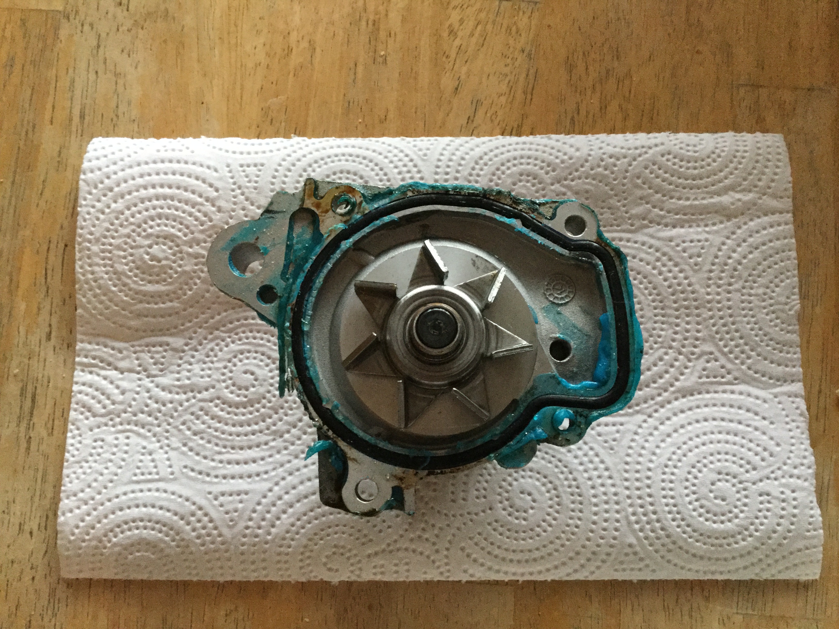

Once I got the covers off, I could see blue RTV on the waterpump... Only 3 bolts were in the water pump so I can only guess they left bolt out on a waterpump repair, customer drove away, had a leak maybe even overheated came back to same repair shop where they opened it back up, saw bolt was missing and just through ton rtv on it and slapped it back together..
Took valve cover all the way off and very pleased to see no signs of sludge, valve cover gasket has all kinds of debris on it so same mechanics prolly just set it down on shop floor and reinstalled it without even wiping it off. Yes there is oil seepage all along engine.
Now I need to consider this thing might need a new head gasket and head leveling..
For anyone thinking of just tossing in a used engine JDM or otherwise, stuff like this really happens at a lot of repair shops, hopefully I wont find anymore surprises...

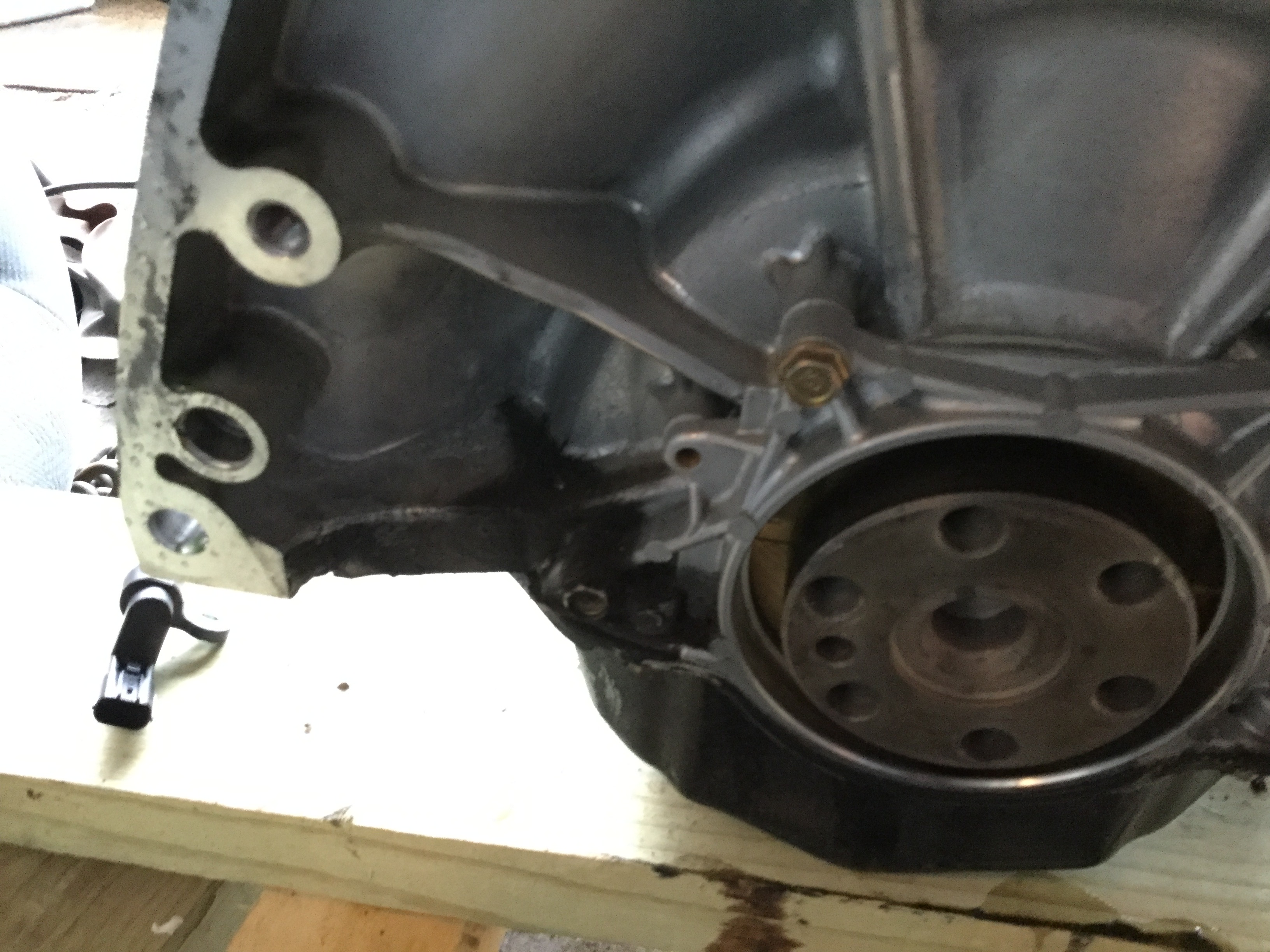

Pulled the rear main seal off, but noticed seepage on the bottom edge that goes up on the cover..
Is that cover normal to have minor leaks?
Don’t see a gasket as a replacement part so might just only be rtv’d in place?

Old Jan 19, 2018
Posts: 15,190
Likes: 1,609
Re: Trials of buying a used engine.
not sure, but i suspect mine is leaking...
good luck in there, buddy!
nice job so far
Old Jan 19, 2018
Blue and orange RTV screams "amateur", there are plenty of them even in shops
Lost key, pulley bolt not tight, etc.....plus the botched pump.....
Someone probably paid good money to have a hack mechanic do this to their engine.
I'd try a left hand drill bit on the broken bolt, maybe it snapped when someone overtightened it and it will back right out when a left hand drill takes a counterclockwise bite. If not, now is the time to fix the hole the right way.
As often as these engines blow the head gasket, it might behoove you to slap one in before you drop the engine in. You can have the head measured once it's off.
The dirt stain near the rear main....not a leak but just seep? It took 16 years to collect that much seepage and dirt?? Not sure if I would worry or not. What's the source, the rear seal, seal holder, or the pan? Flip the engine over and do it all now LOL

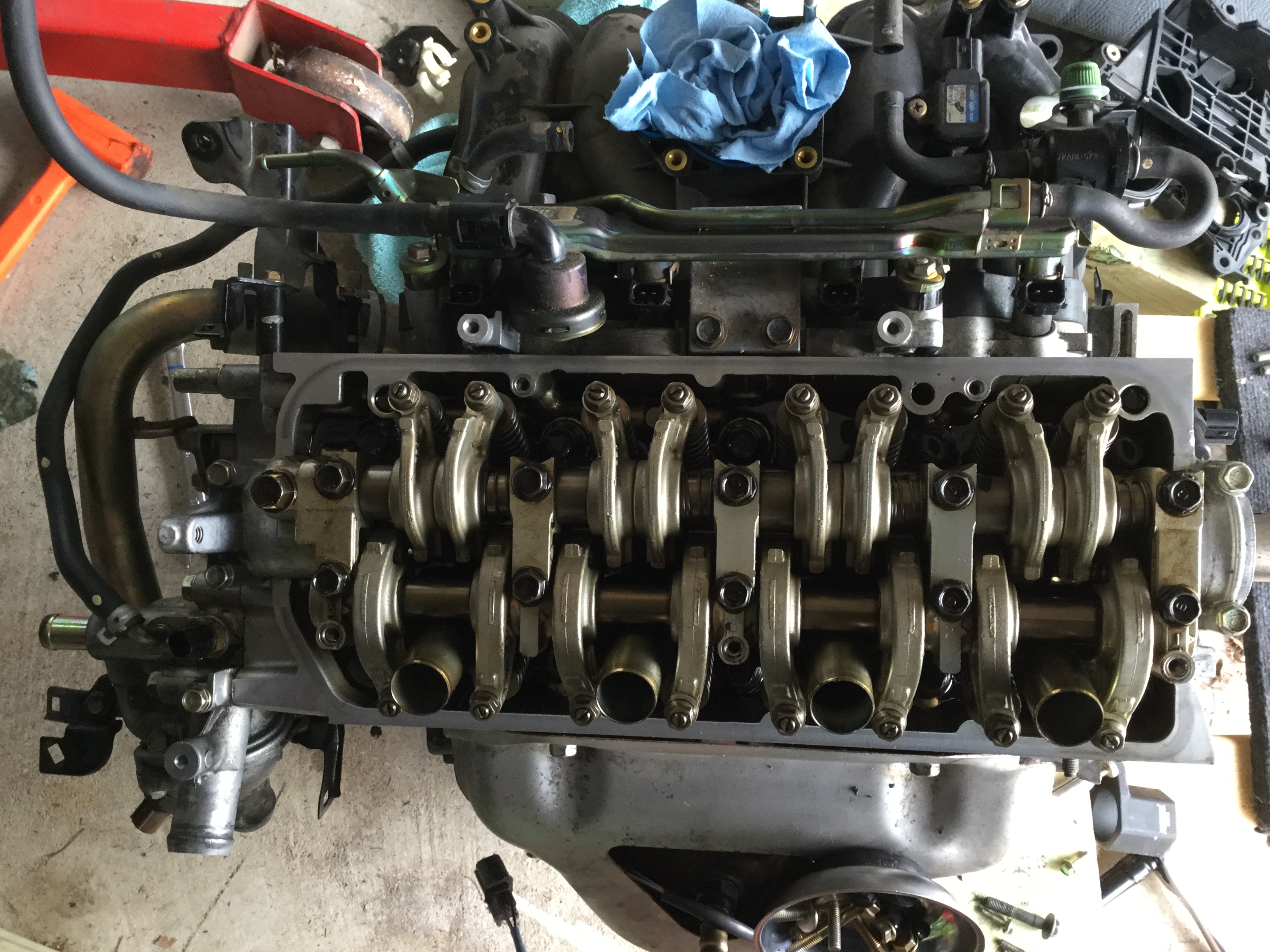

Pulled the camshaft out, valley was loaded with oil that seemed like it was on its way to becoming sludge but it was still liquid just a bit like syrup. Never realized just how bad that design in, oil stagnates in those compartments it seems.
Oil orfice was clear, camshaft seats have “polished” areas but no visible damage. No gouges on any of the lobes.
Pulled spark plugs and they look good and uniform in color.
Hate using broken screw extractor in a aluminum hole.. got lucky with drop of instant glue on tip screwdriver placed on broken bolt in the hole and puffed in some baking soda. Unscrewed right out.
Those little troughs keep the cam lobes lubed, and if there weren't the little troughs full of oil the cam lobes could be dry at startup.
More oil is always splashed into those troughs while the engine is running.

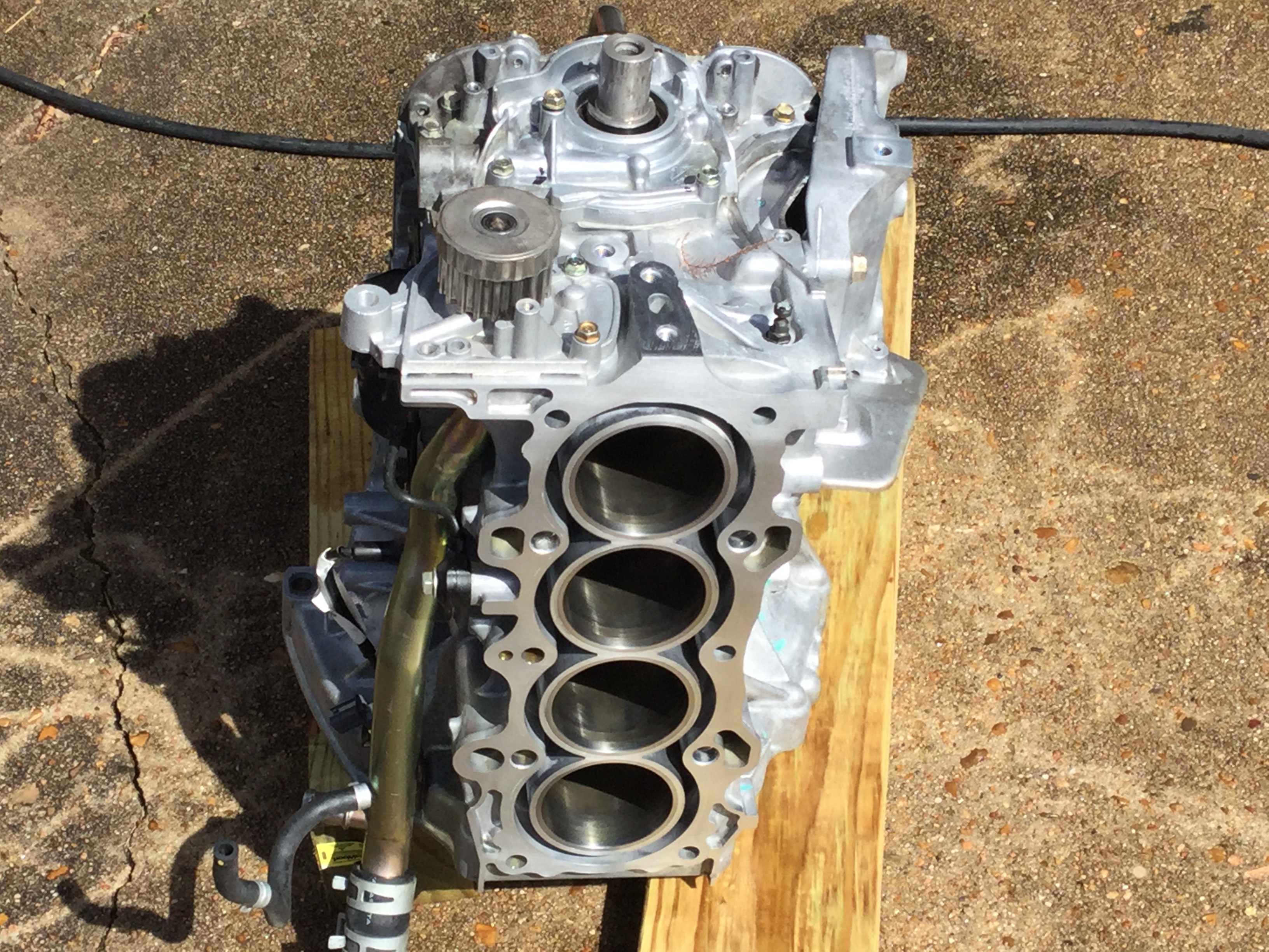

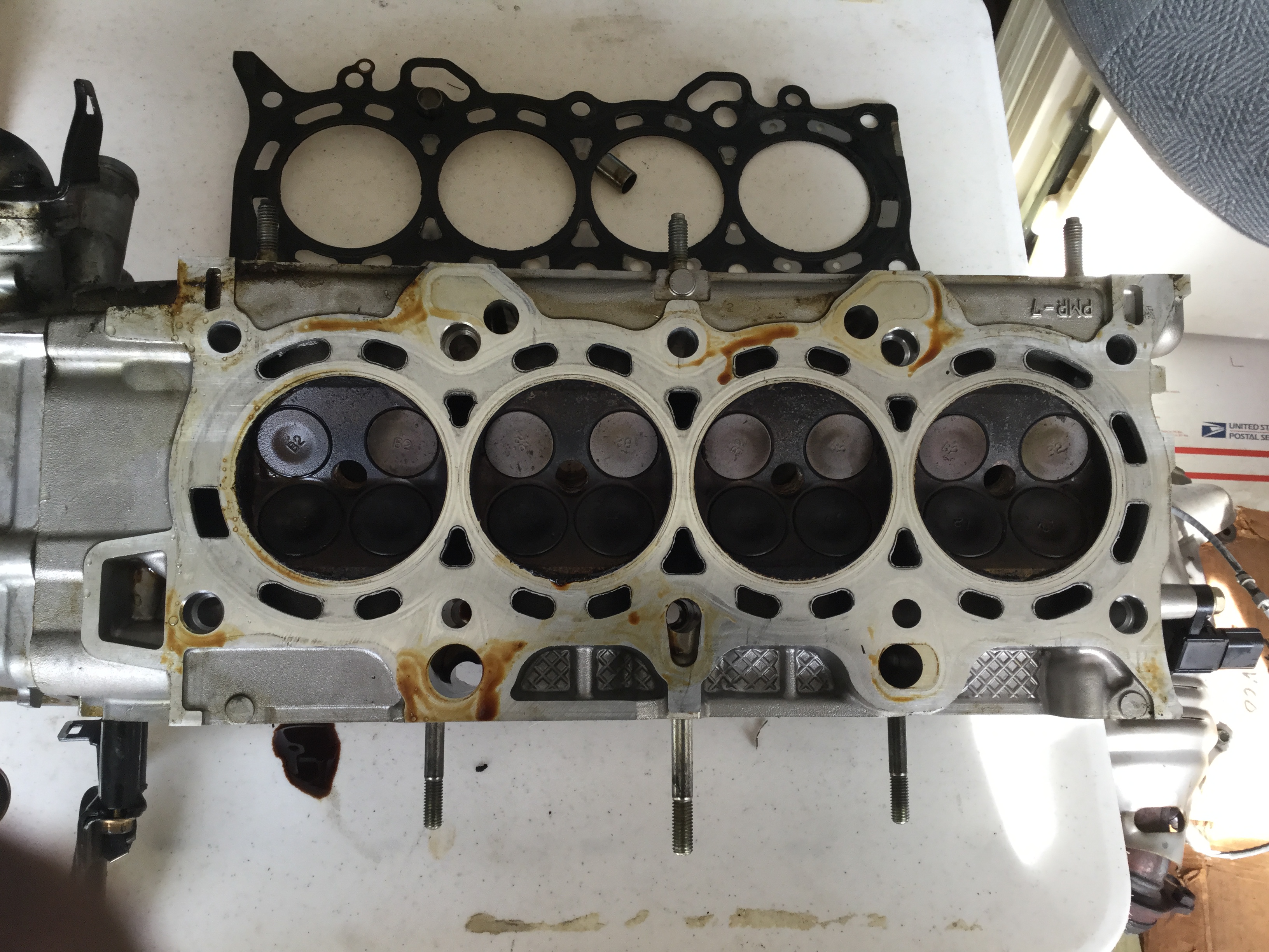

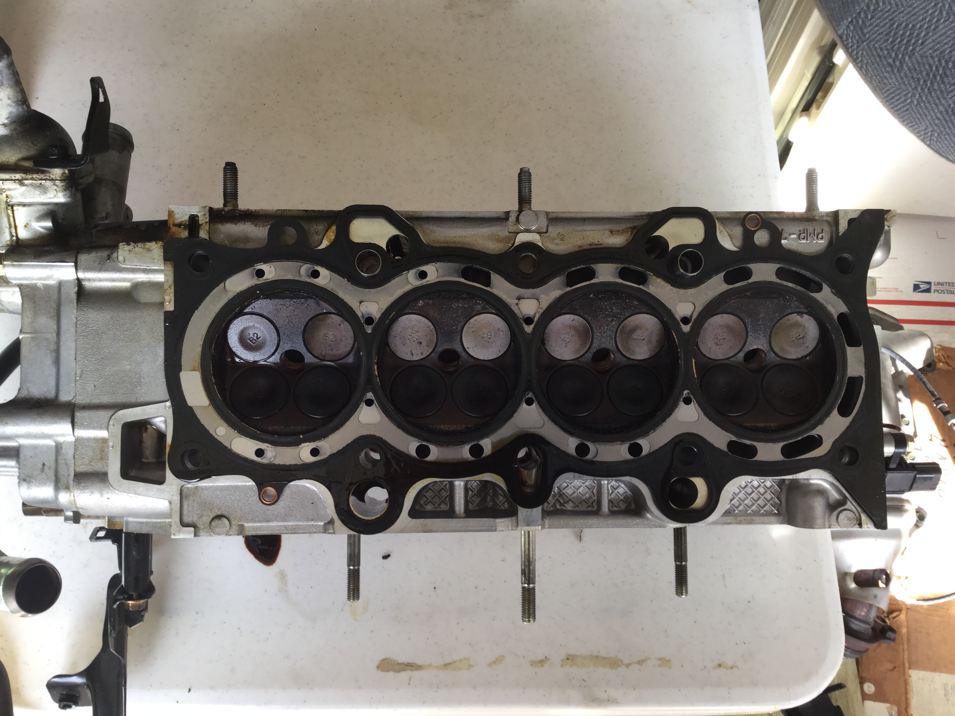

I ordered new head gasket and various intake exhaust fuel injector oring replacements and took the head off today.
shoulda ordered that short fat coolant hose.. hindsight..
head gasket looked perfct, didn’t even flake apart when I took it off except a little in one corner.
oil seepage in #4 I suspect is only is because of my unusual upright position, good little pool oil made its way past piston.
looking up at the bottom of the piston I can see burtn oil traces in the piston weep holes.. was not planning on taking pistons out but at this point it’s literally two nuts each to remove them and inspect / clean the oil rings..
By no means trying to be cheap at this point, but i do not plan to just replace the rings, just clean and inspect is the direction I am thinking as they only have 74k on them and oem set is almost $200

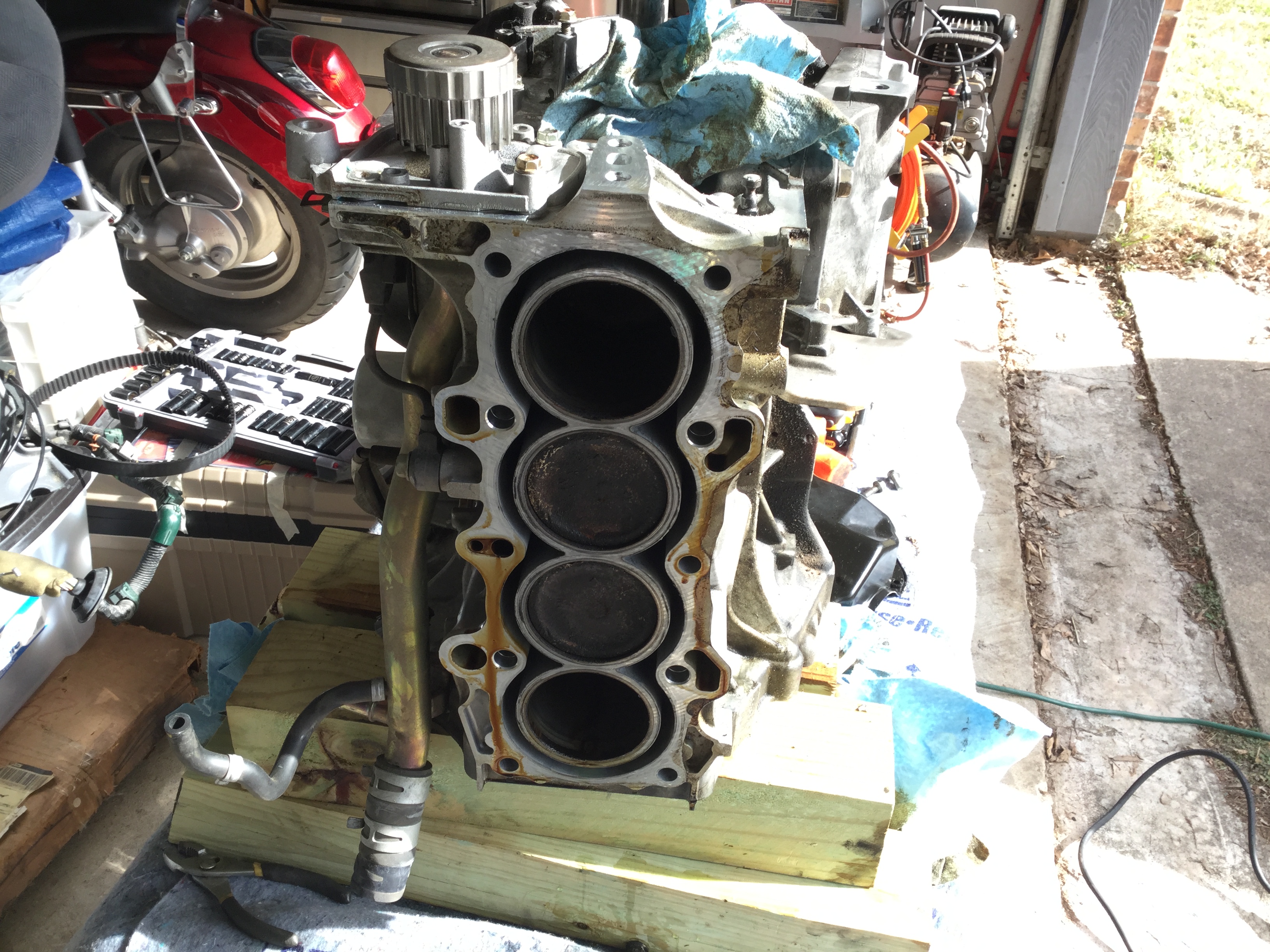

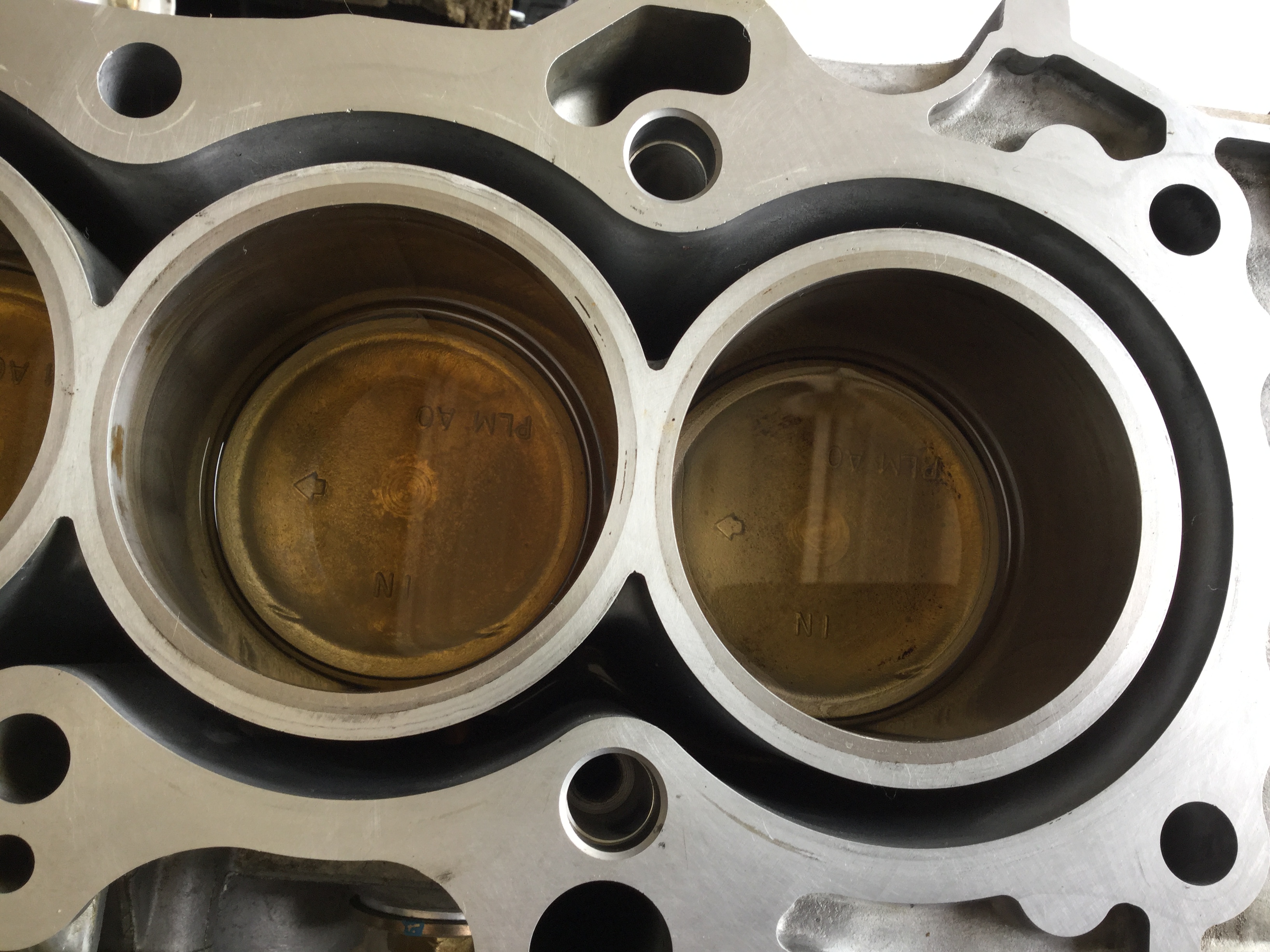

Head is flat measured like 20 different ways and could not see sunlight under the large framing square I used.

Old Jan 25, 2018
Looks like you've got it standing on end, so if it's been in that position for a while yea that's expected.
I'd do that too, as long as they don't get damaged in the process.
When I did my Fit engine I had the pistons soaking for like 3 days before the oil rings were free enough to rotate around their grooves. I had already planned to replace the rings, and only soaking in solvent didn't get the ring grooves clean.
.....the large framing square
is not a precision straightedge.....but if the black coating of the head gasket wasn't peeling off around any portion of the cylinders (the "fire rings") then it's probably ok.

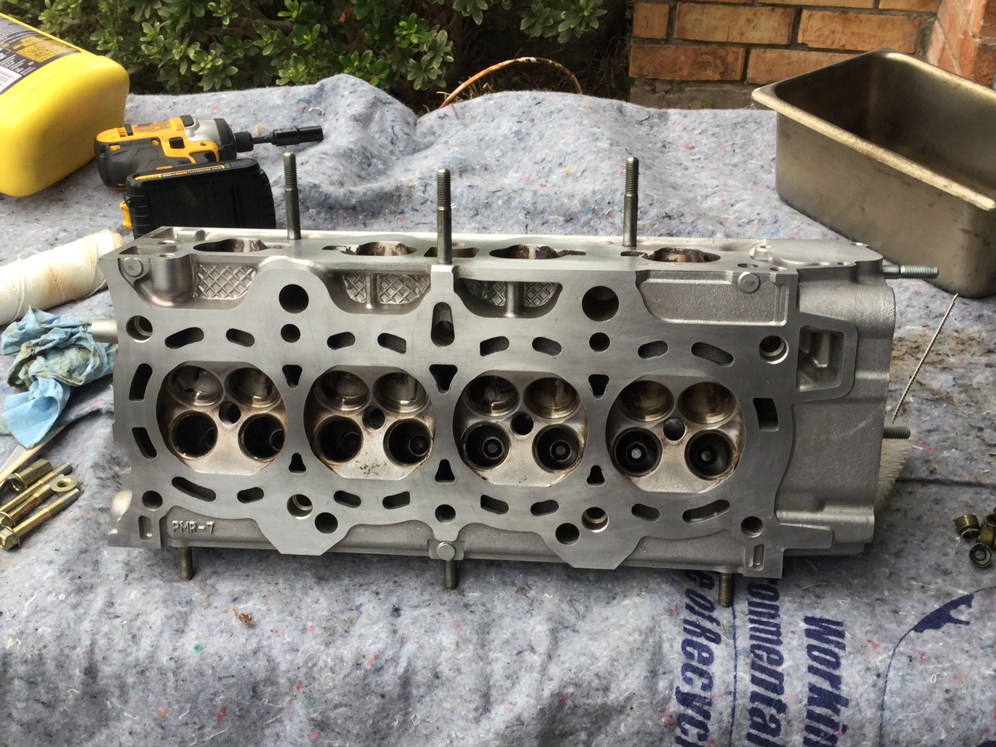

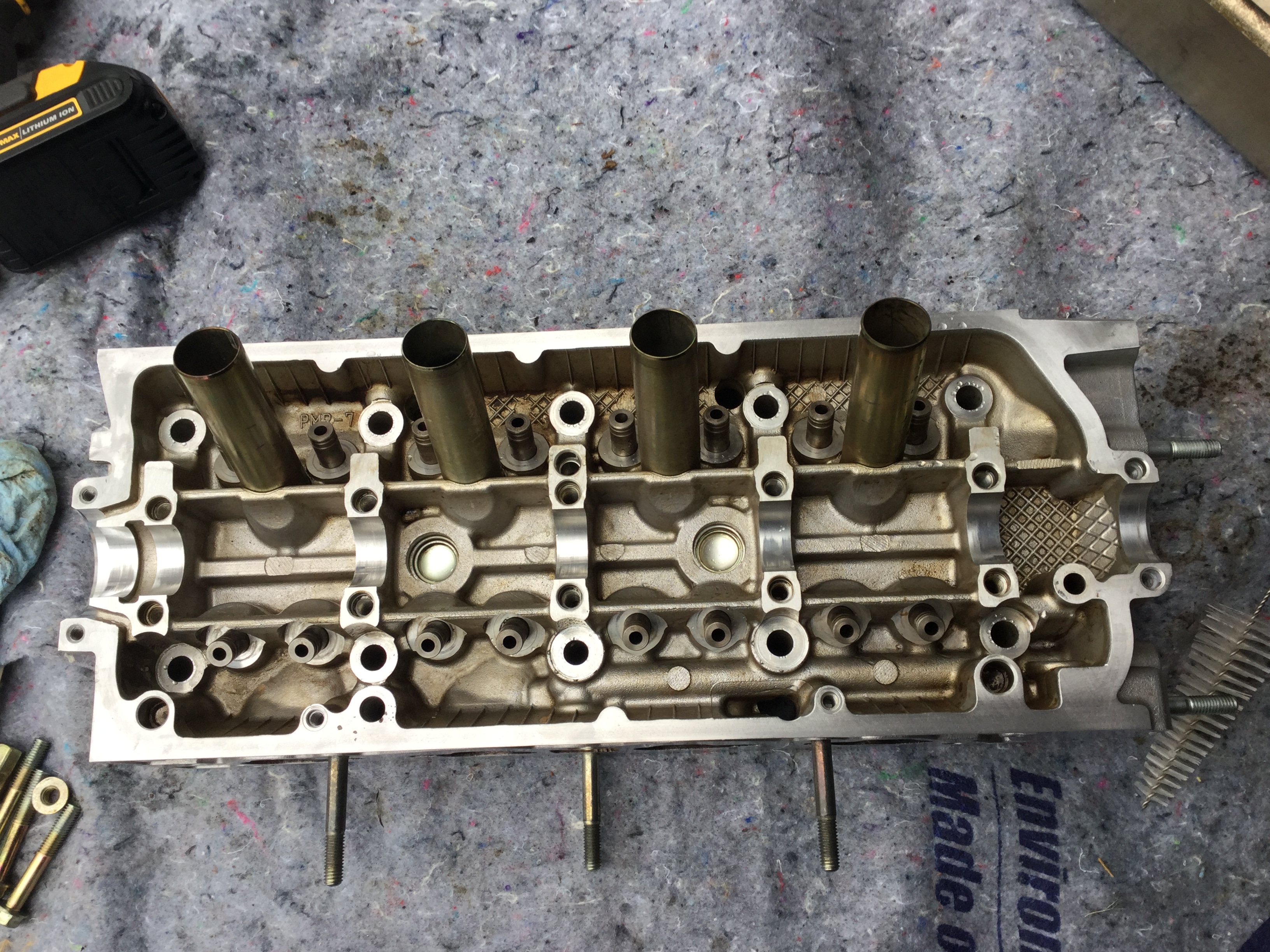

Surprise, took out the thermostat and found a string about two inches long of blue rtv stuck in the valve...
Cleaned, cleaned and cleaned some more on the cylinder head. Definately glad I bought the listed valve keeper tool. The smaller version fits way better for the exhaust valves.
Middle size of the harbor freight hook loop pliers made pulling the valve seals off pretty easy.
#1 and #4 intake valves had sizable deposits on them.

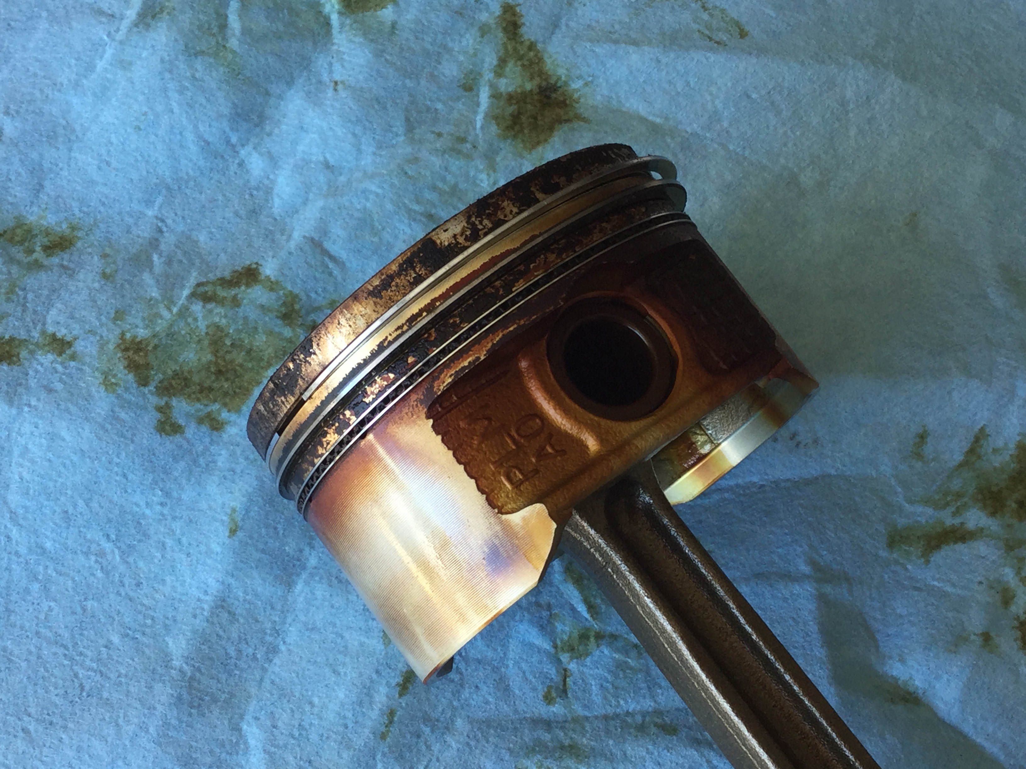

Decided to pull a piston to see how the rings look since the weep holes looked ominous.
Surpise surpirse, Oil control rings totally carboned up into a stuck mass.

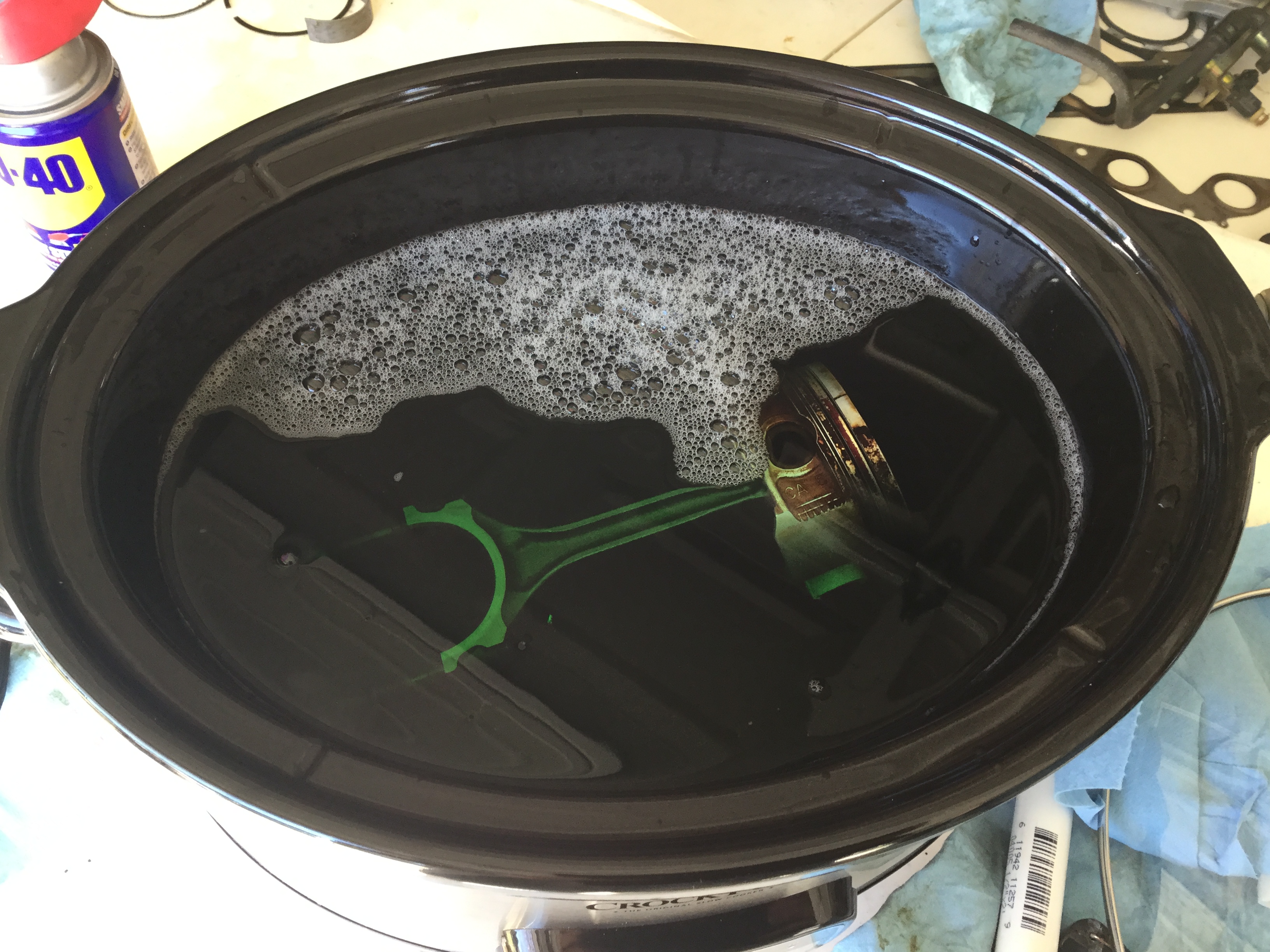

Honey, what’s for dinner? Why I just happen to be making Slow Cooked Piston soup..
Took off the bearing and compression rings off and tossed the whole assembly into the family crockpot with water and few ounces of simple green. No magic of TV here, next update will be in 24 hrs.

Old Jan 29, 2018
Tomorrow: Step it up to a pressure cooker?
Try come carb and throttle cleaner?
Gunk or Berrymans chem-dip bucket, I've wondered how well those would work on ring groove buildup
I did my Fit pistons by scraping carbon manually, and following up using a drill bit to clean out the holes through the oil ring grooves
Usually snap a cast ring in half and use the squared ends as the scrapers.
We do have a groove cleaning tool for some J engine pistons but it didn't fit my Fit..Haven't had opportunity to try it on a D17 piston since we got it.

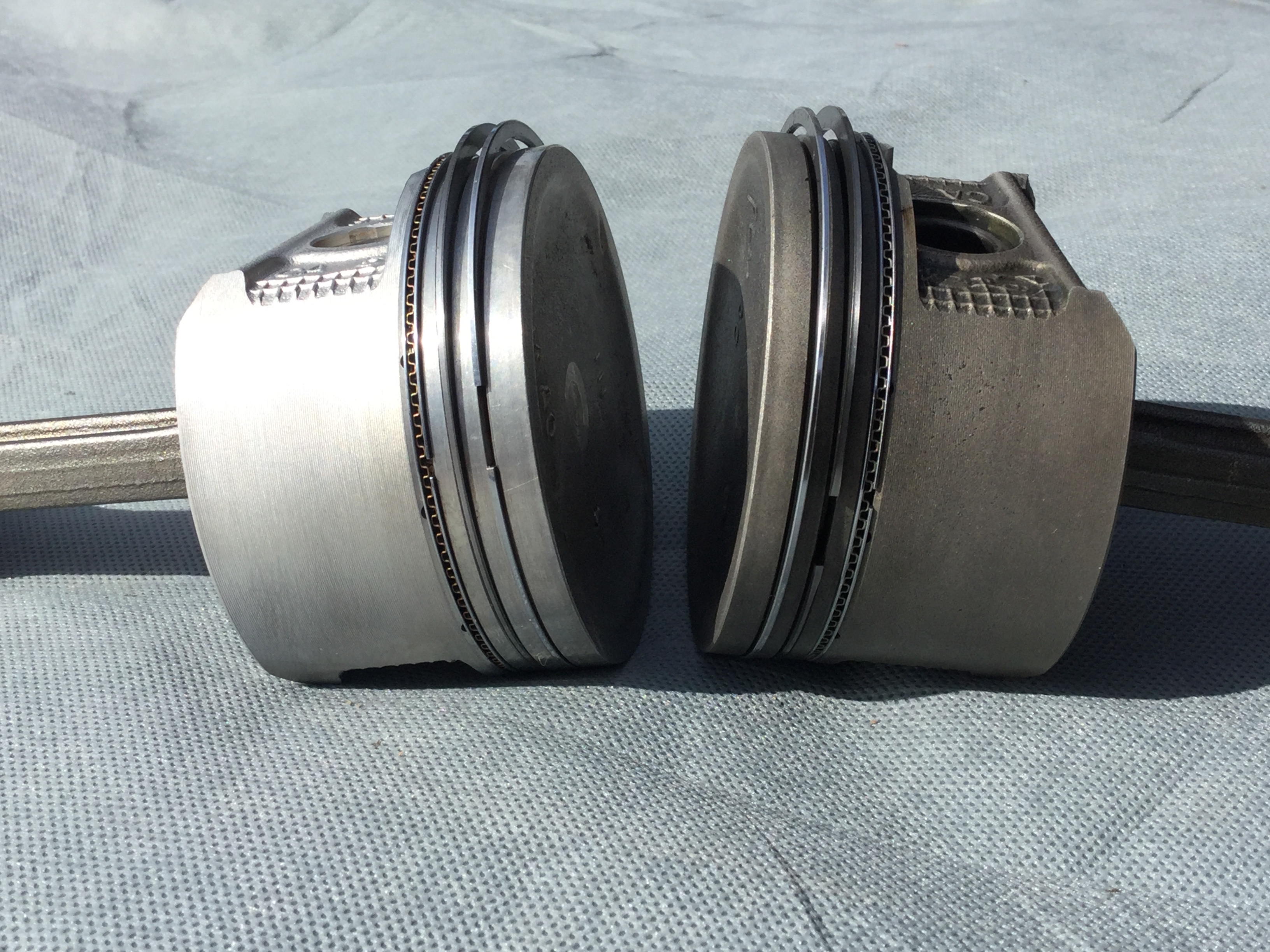

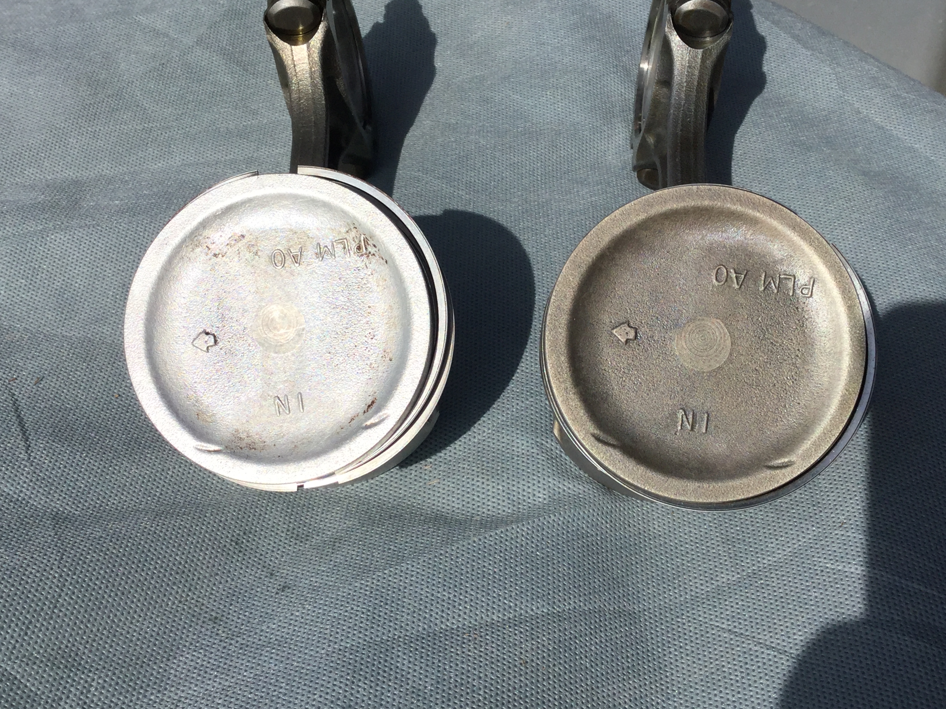

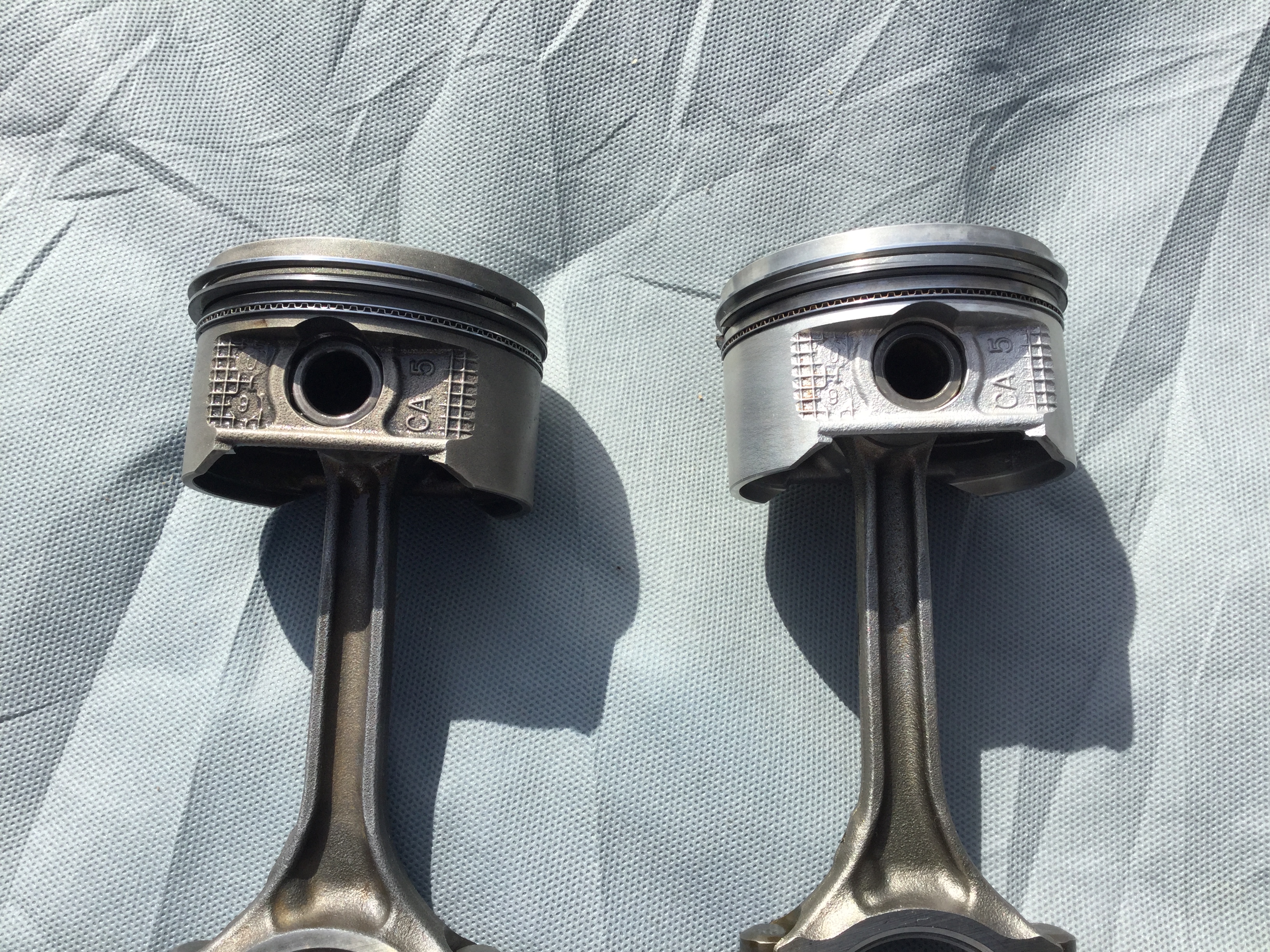

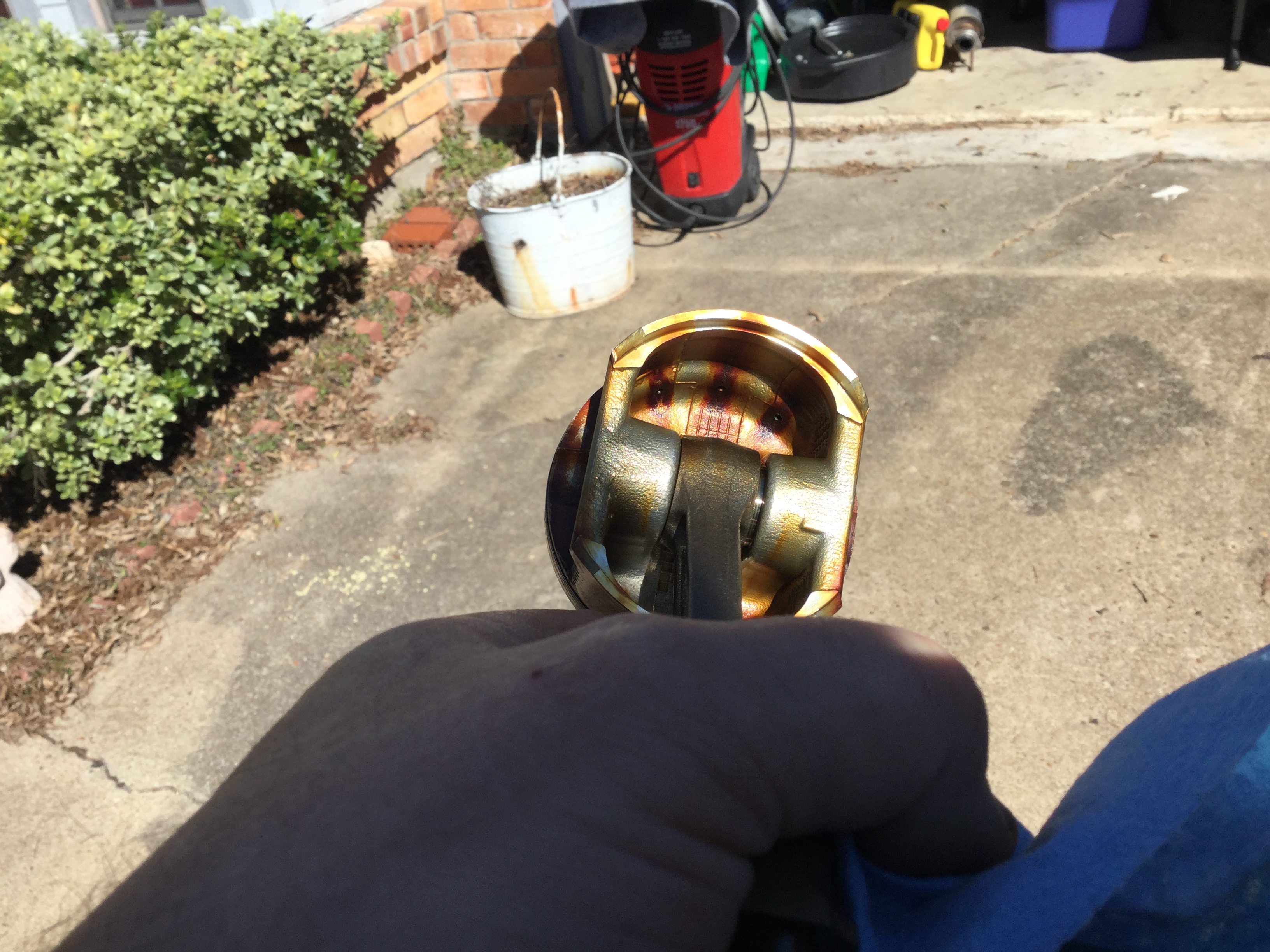

DO NOT COOK Aluminum in a mixture of Simple Green.
Seems I over cooked the piston etching away the polish. Kinda on the fence whether this is just a cosmetic issue as the crown will build up with carbon as normal and after that it just normal for the top.
Cleaned the second piston with elbow grease and WD40 / Grey scotchbrite and Dawnand brake cleaner. Zig zag oil ring spacer was not fun to clean..
When to autozone to get more brake cleaner and saw they had gallon pail of gunk carb cleaner on clearance for $10.
Side by side shots of my etched piston and normally cleaned one.
Judging by how perfectly two pistons fit in there and still able to get the lid back on, Honda mighta envisioned that as a cleaning method.

Old Jan 30, 2018
Etch? Polish?
Kinda just looks really clean and shiny to me. Not a problem?
Did those piston skirts have a black coating (teflon or some such) on them before cleaning?
Carbon will eventually build up on the piston top, that's normal for any gas engine
Don't forget to reset all of the ring gaps to their desired positions before installing, as per a service manual

Scrubbed the mating surfaces with grey scotchbrite and WD-40, liberal dose of Gunk citrus engine cleaner and my worn out pressure washer and this thing looks almost new.
Carb cleaner soak worked really well for the pistons, still had to scrape the grooves a bit but 5 minutes worth not a hour.
Time to start putting things back together.

Bought the el cheapo harbor freight 750lb engine stand for $39 after coupon.
hacksawed the built in spacers basically in half so I could use some bolts I already had. Used some those crazy fat washers on the ends so it would not dig into my block and now I have the engine all mounted properly.
Didnt want to try to put the head back on sideways and didn’t want to worry about it flopping over.
Seems I over estimated what a Honda Civic Shell with salvage title and rear end damage is worth. Started at $100 on Craigslist with daily reposts, then went to $50.. thing but I will send you a check scammers so I gave up trying to sell it and hauled it to the scrap center.
Seems one bare Civic Shell, windshield and 4 tires is 960 pounds...
Poured some oil on top of the pistons, two days later and oil is still there so rings must be sealing at least decently..

You sound like me, hard to not over react when we know something might not be right..
Totally agree you don’t want residue floating around your engine, my situation was different as I had the whole engine opened up and I pressure washed it inside and outside after.
Old Feb 8, 2018
Scotchbrite is bad, especially the Roloc discs that mechanics use on a die grinder to remove gaskets quickly.
It can remove metal that shouldn't be removed, and it can leave abrasive grit behind which can end up in the oil and wreak havoc on bearings.

Reassembled the valve train and installed the head.
Left the crankshaft clocked at 90 so all the pistons are half way up/down. Spun the timing sprocket with my torque wrench.
25foot pounds seems to be force needed to spin it. Surprised how clunky it is, once it get past a set lobes it will snap to a netrual tension position.
Glad I changed the o rings in the coolant hard lines, they were pretty cooked and stayed flat on the outside. Those pipes got jostled quite a bit during my tear down.
Only thing I have left to do is adjust the valves, after that next will be to swap the engines...
