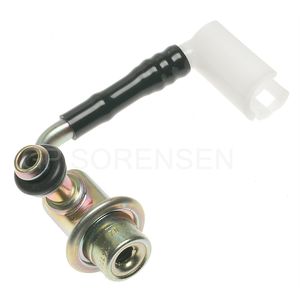

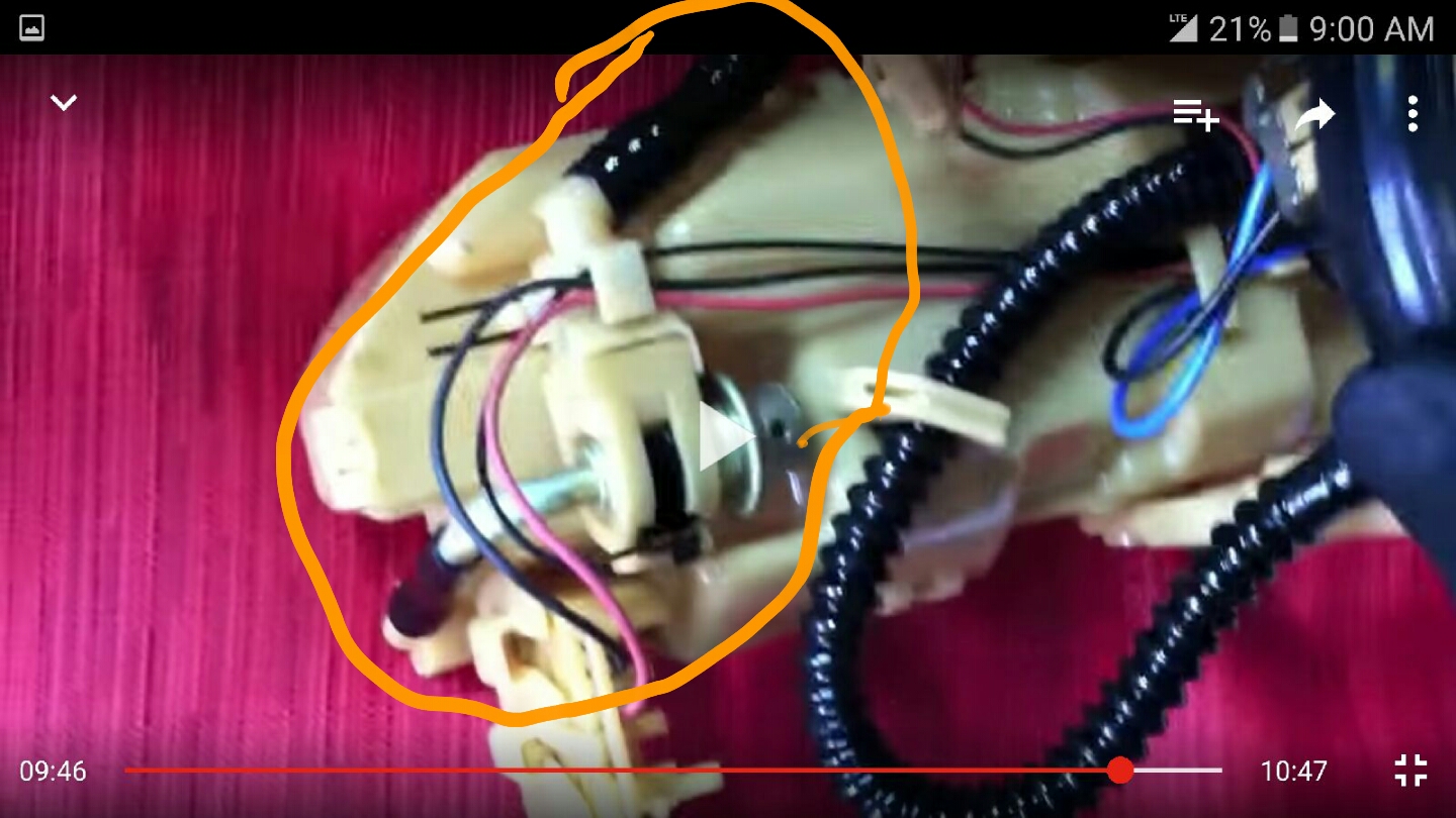

Slumper, thank you for your reply and the pictures. I saw that on my fuel rail, but am confused. When I look for the fuel pressure regulator at the parts store, I find the part in the second picture below, and from my research I find that part on the fuel pump, as in the second picture below. Are there 2 pressure regulators? Do I have to get a new fuel rail if the pressure regulator goes bad? Does anyone have any guidance on any of the issues presented here?
The lack of heat is an entirely separate issue. I believe it is coming from a clogged heater core, but have not had the time or warm enough weather to be able to flush it out. The car runs well, when I can get it to start, other than running rich and a bit rough at idle. The car did not die and not restart. The reason I believe that the issue is with the pressure regulator is that I can usually get the car to start by holding down the gas pedal and cranking the car, however if using that procedure it doesn't start and I pull the plugs, they are wet with gas. I figured that the pressure regulator would go out before the injectors would go out, all 4 at once, or the regulator would be pushing to much pressure causing the injectors to leak, even when doing the "flood start" procedure. I figured that if there is to much pressure, that would also cause it to run rich and idle rough. If there is a flaw in my reasoning or something I'm missing, please chime in and educate me as I welcome the input and know that I can be wrong. After all, this is my only Honda, all the rest of the cars I own are Fords and 1 Dodge! LOL! Thanks again for everyone's input!

Yep your right, that’s not a regulator on the fuel rail it’s a dampener. Suppose that gives a little to normalize pressure waves in the system.
I would have expected you to have seen all kinds of driveabilty issues if your fuel regulator failed.

2001 and newer Civic uses returnless fuel system.....the regulator is in the tank with the pump. Fuel pressure check should confirm if pressure is in or out of spec......and a test is a hell of a lot cheaper than needlessly replacing a damn reliable Honda fuel pump.
