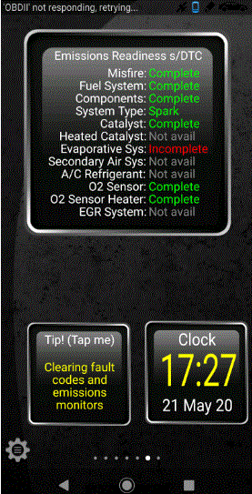

I thought I'd post this in case it helps. We have a 2002 civic and a 2002 cr-v, both had the p1457 code preventing them
from passing Connecticut emissions. I use the Torque app to access/clear codes but clearing doesn't really do anything if
there's an underlying problem. P1457 indicates a problem with the EVAP system. Having this check engine light (CEL) on
causes you to fail emissions testing... my mechanic said don't bother trying.
When you clear the p1457 with Torque, all your emissions "monitors" become INCOMPLETE (also know as NOT READY
on the internet). You have to go thru a number of driving cycles to make the monitors become COMPLETE. In my case
below, the EVAP is the last one to become COMPLETE. I'm pretty sure that when it becomes complete, a new P1457 will
get logged, and my CEL will come on. In Connecticut and some other states, you can pass emissions as long as you only
have one monitor INCOMPLETE. So this car will pass emissions, as long as I don't wait too long for EVAP to become COMPLETE.
I'll fix it on my own time during this plague, but at least I can get thru emissions testing .
