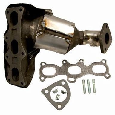

I hope this pic isn't what they actually sent.
How long before their cheapie pops a P0420 code?
Old Aug 25, 2013
clinton_hedrick's Avatar
Joined: Dec 2012
Posts: 107
From: Ohio
clinton_hedrick is an unknown quantity at this point
Re: Standard Cracked manifold in '03 LX- Need a bit of advice
^^ That one may have a little problem with, oh maybe the wrong amount of cylinders
