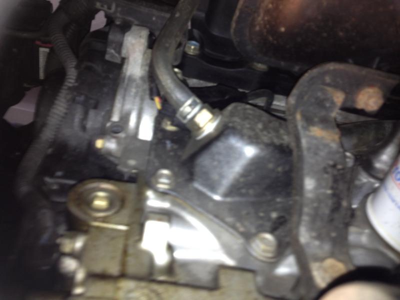

I don't see it. This is what I see front underneath

I could see the black wire sheath, just above the breather cover.
