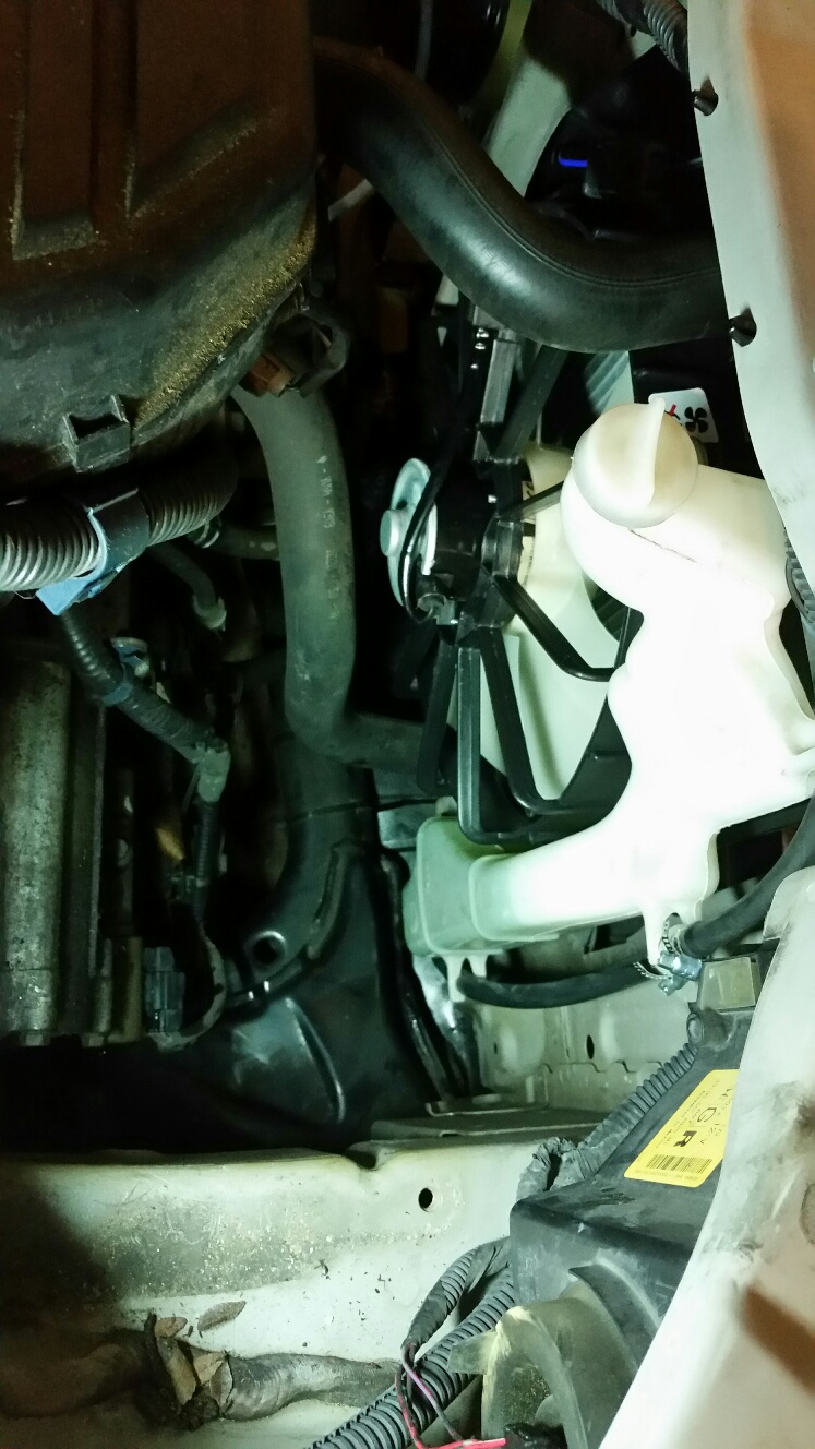

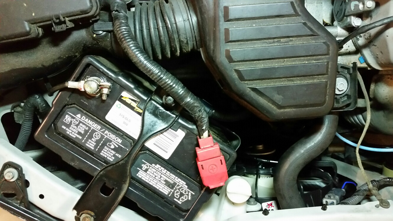

FYI...It is possible to remove the radiator fan with only removing the battery, battery support, coolant reservoir and the upper radiator hose. I think there was a ground wire as well.
This was done on my 02 civic EX with a short ram installed. I can't remember if the resonator box would be in the way or not. I don't think it would be.

I am new here, but wanted to share my fan experience with you. I was able to change my 2003 Civic LX 1.7L radiator fan without draining the coolant or doing any major work. Hope this helps someone. See below:
Changing the radiator fan on 2003 Honda Civic LX 1.7 ltr auto
Disconnect the battery (both terminals)
Remove the battery cover
Remove bracket and remove the battery
Remove the plastic tray for battery
Disconnect the ground wire from the engine that goes to the front frame
Tie back the upper radiator hose with tie wraps (to the right side facing the engine)
Disconnect the harness for the battery from the metal tang on the battery metal tray
Remove the 12mm bolts (2) that hold down the metal battery tray
Reach under and loosen the two 12mm bolts that hold the battery tray lower mount
Pull battery tray out
Tie wiring harness for battery cables to throttle cable with tie wraps if needed
Remove upper bolt for coolant reservoir (leave hose connected)
Slide it out of the slot in fan lower bracket and set aside (hose will need to be pulled out of the plastic brackets on the side)
Remove the two 10mm bolts that hold fan in at top
Disconnect fan quick disconnect plug
Slide fan up and out of the holes at bottom mount
Carefully move fan to the left and out of engine compartment area while moving the upper and lower radiator hoses and wiring harnesses as needed
Installation is basically the reverse of the removal steps. Start the engine and run the AC to full cold. The fan should automatically run when the AC is engaged. If the small hose was disconnected for the reservoir, then do a leak check of the hose.

Lol I didn't read much of this thread but saw people talking about dismantling the front end. It only requires removal of the battery and coolant reservoir to slip the guy out of there and replace.

Bringing back thread because I can't get driver side radiator fan out using the steps mentioned above. What is the trick?
Re: 02 Civic EX 1.7l radiator cooling fan replacement steps?
Pull the rad? Not necessary at all. I did figure out if you remove bumper cover, radiator + a/c condenser support brackets, you can tilt the condenser + radiator forward enough so there's clearance for driver side fan to come out. But that's a pita way to do it so wondering if anybody has an easier method.. Btw passenger side radiator comes out with only removing battery + upper radiator hose so that one does come out fairly easy.
