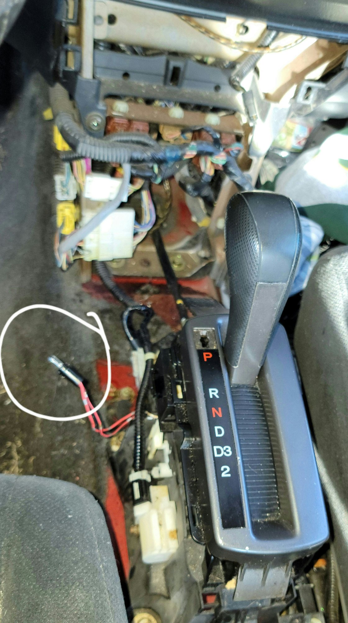

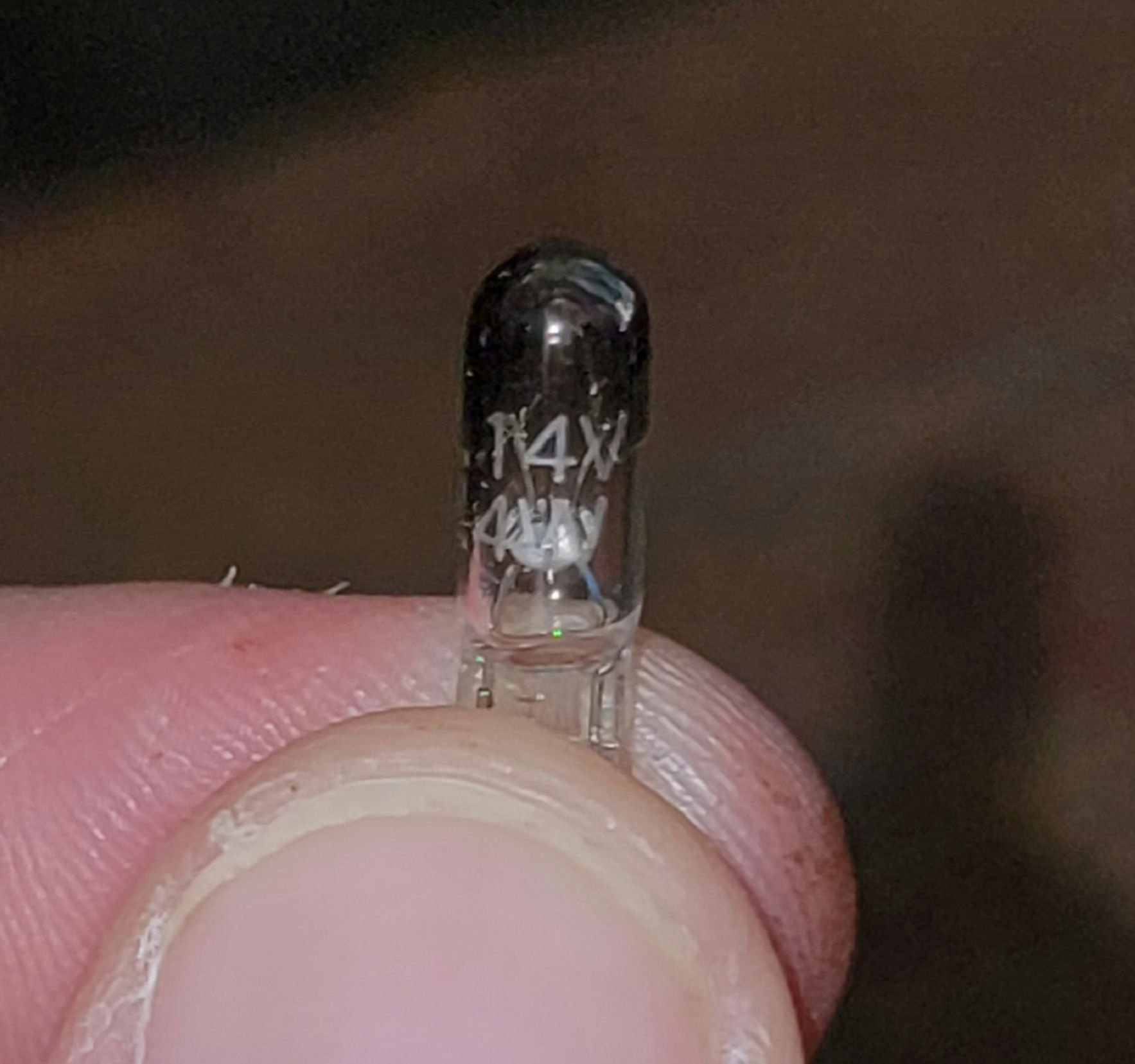

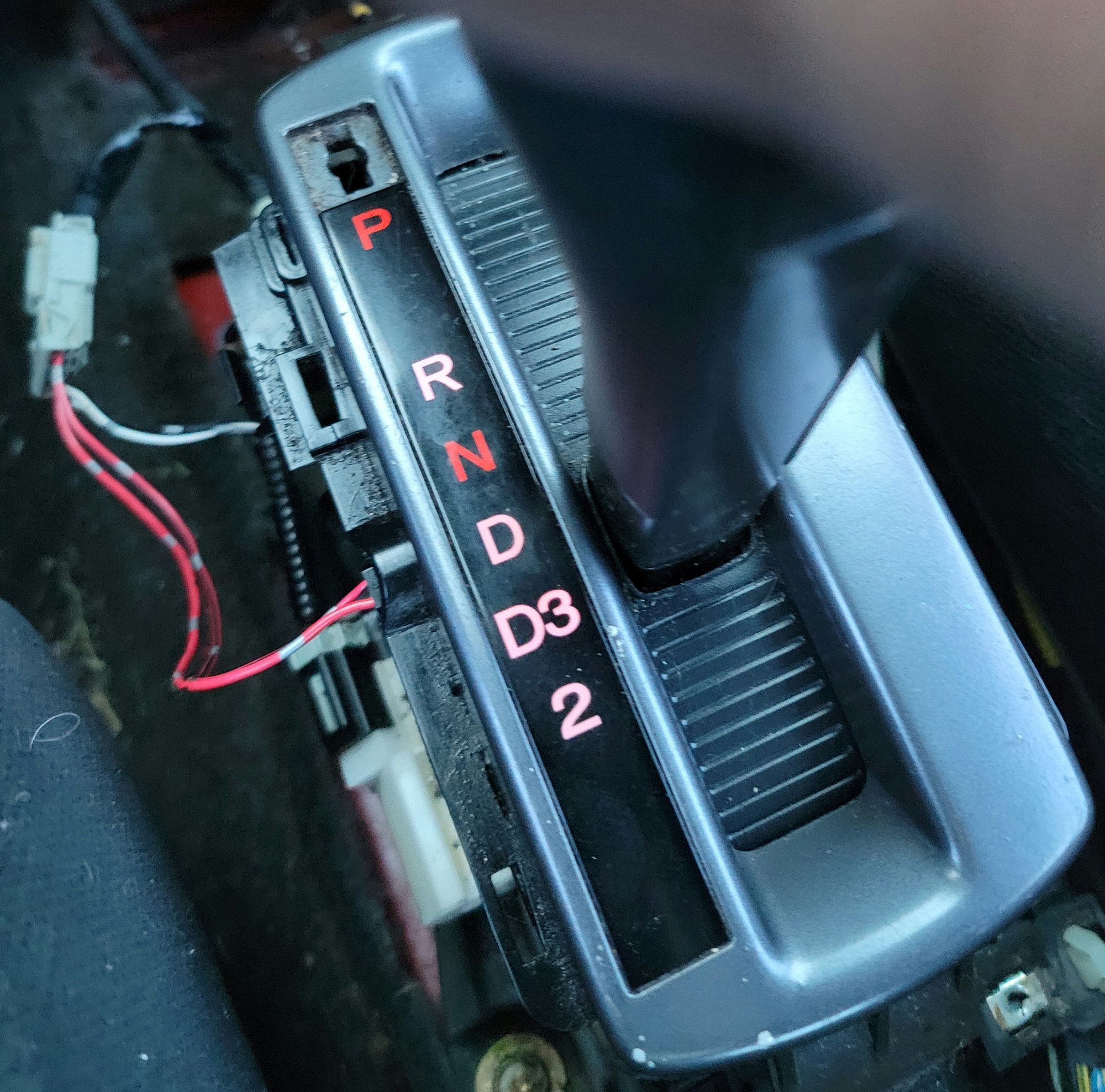

Hi I have a 2003 civic & my shift column light (P R N collumn) in the console hasn't worked for years. Took apart the console & replaced the bulb but it still doesn't work & I haven't checked the fuse yet cause I'm not sure which one inside it is. Does anyone know which fuse it might be or anything else I could try

Should be the same as the rest of the interior lights. Checked for power and ground at the bulb socket?

I have to appologize. I've actually never done that kinda stuff. Is it fairly straight forward if I were to get the electric tool?

Very easy, you can get a cheap multimeter for under $20 and there's lots of YouTube videos to show you how to use it

or a test light (don't forget to turn lights on when testing...)

I'm such a doofis checked the wires, they were good, I was gonna check the fuse the next day. Decided to go to the store to get a soda that night, turned the lights on & it was working 😄 it's been not working for so many years I forgot it turns on when you flick the lights on... oh my...
