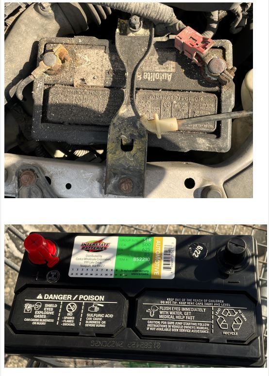

costco only have 51R, and when I bring back home. I notice the terminal post is switched compared with my current battery.
Should I return and get a 51?

return and get the right one

Yes you should return it. If you flip it around to try and use it the hood prop will hit the battery terminal causing a larger issue so get the correct one.
Exactly this, seen cars burnt up from that happening
