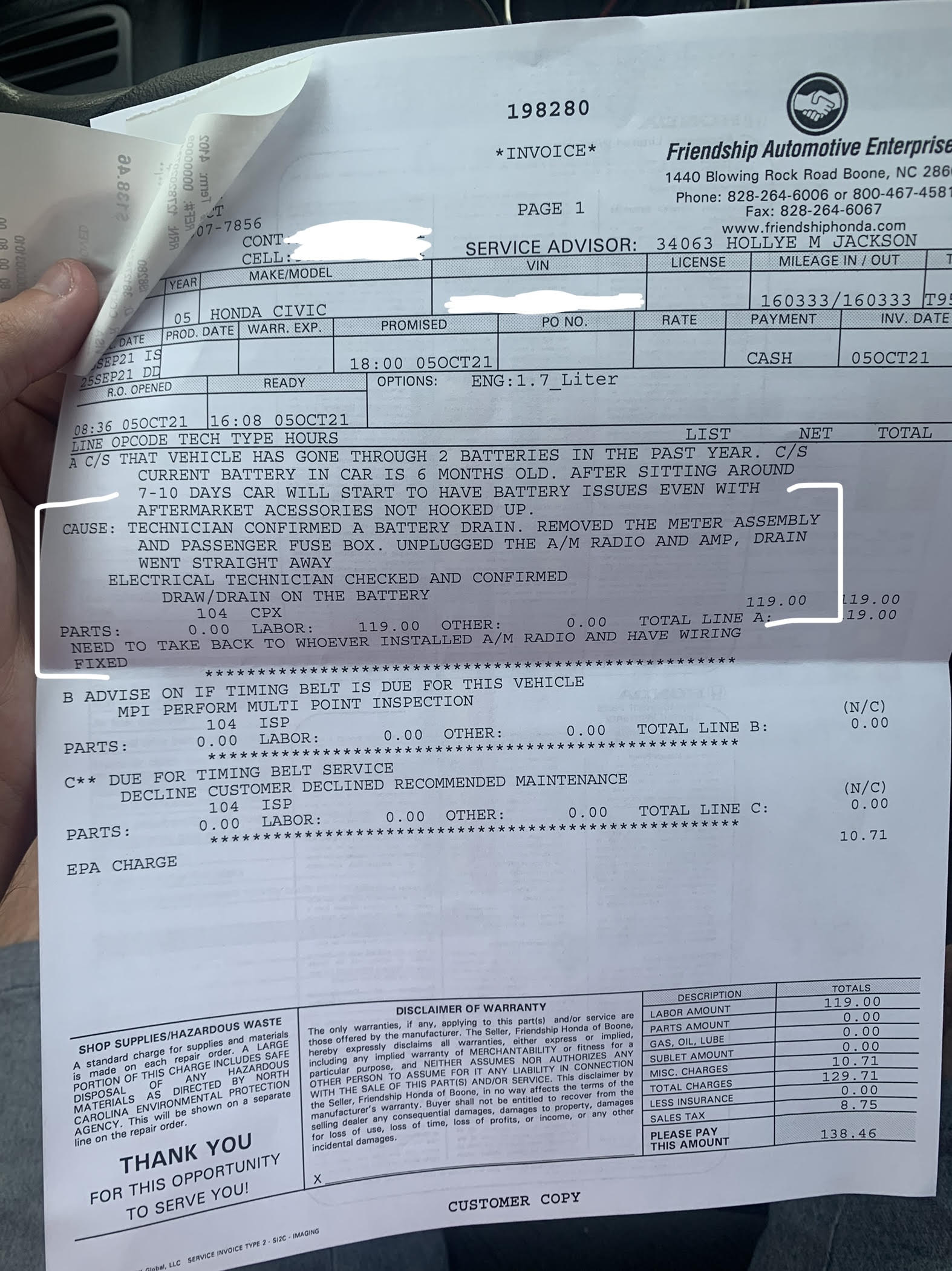

Hey y'all. So I ended up taking it to the dealership and this is what they had to say. When I asked the technician to show me what they meant, they refused and said they didn't feel comfortable messing with aftermarket stereos. Which is crazy because I just paid $130 for him to tell me something I don't understand.
This isn't something I had an issue with with my last aftermarket stereo. The fuse in the back of both is the same (10A), so I honestly can't understand why this radio is a new issue.
The only reason I changed the stereos was because the volume **** on the previous one was giving me issues. When I turned it too fast it would kick back down to 10, and anything above 25 would cause it to kick back down to 10. For reference, the highest setting for both radios is 35. Also, for some odd reason, this new stereos actually louder than the last one. Again, don't understand why. If it helps, this is the new and old stereo models: (new) JVC KD-T91MBS ; (old) JVC KD-R97MBS. They're both advertised as marine stereos, and I used them because I can't see LED backlit stereos in my car, in the sunlight.
Also, here's the diagnostic report from the dealership.
Thoughts? Thanks.

Old Oct 13, 2021
Colin42's Avatar
Posts: 9,646
Likes: 1,283
From: Barrie, ON Canada
Rep Power: 223
Re: 2005 Civic - Battery Drain
Do you have just an aftermarket deck? Or an amp and subs?
Old Oct 13, 2021
Posts: 15,181
Likes: 1,607
they don't want to deal with mess ups from other people. If whoever installed the deck damaged the wiring... Did it start after you installed the deck?

You should be able to prove the technicians diagnostic by unplugging the Head Unit and Subwoofer. one at e atime.
Just a guess if the sub-woofer has its own amp, what turns on this amp ? What Powered Sub are you using ?
Amps usually require a power feed and also a power-on signal. Is it possible the sub-amp is powered on all the time even when the car/radio is turned off ?

When I tried to do that though the battery still drained, that’s why I was confused he said that was the issue. The drain wasn’t much, but it still existed.
The subwoofer does have its own amp, yes. The sub has direct power to the battery, and is also plugged into the back of the radio. It’s my assumption that the sub and it’s amp don’t turn on unless the car and the radio are on, but I’m not sure how to check if it’s pulling direct power while everything else is off. The sub is a JBL GT-BassPro12.
When the key is out of the ignition and the car is off, I can’t turn on the radio so that’s what initially led me to believe it wasn’t draining power. That is, until I checked the battery voltage daily.
