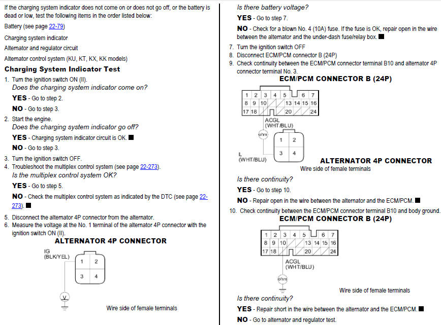

Hey guys need some help/advice please and thank you. 05 civic D17A1 engine. Battery stays on constantly, I have checked alternator both at the battery and the alternator itself both outputs read 14.2. Battery at rest overnight reads 12.6. Any thoughts ideas or solutions would be greatly appreciated.

Run through the troubleshooting, see where it points you.

Did you put in a crappy parts store alternator?
