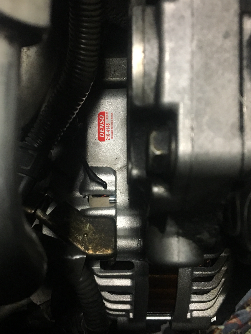

The cause was a bad unit. Replaced it the 2nd time with the same Denso alternator. The battery light is gone. We'll see how long this one last.

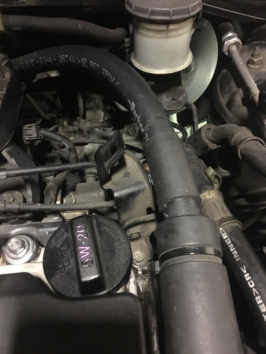

Does this matter? I just noticed this after i was done installing the alternator

Not really. Follow that line towards the firewall. My bet is whoever installed stuff (you perhaps? I've done it before) forgot to clip that bracket back on and it drifted towards the firewall.
