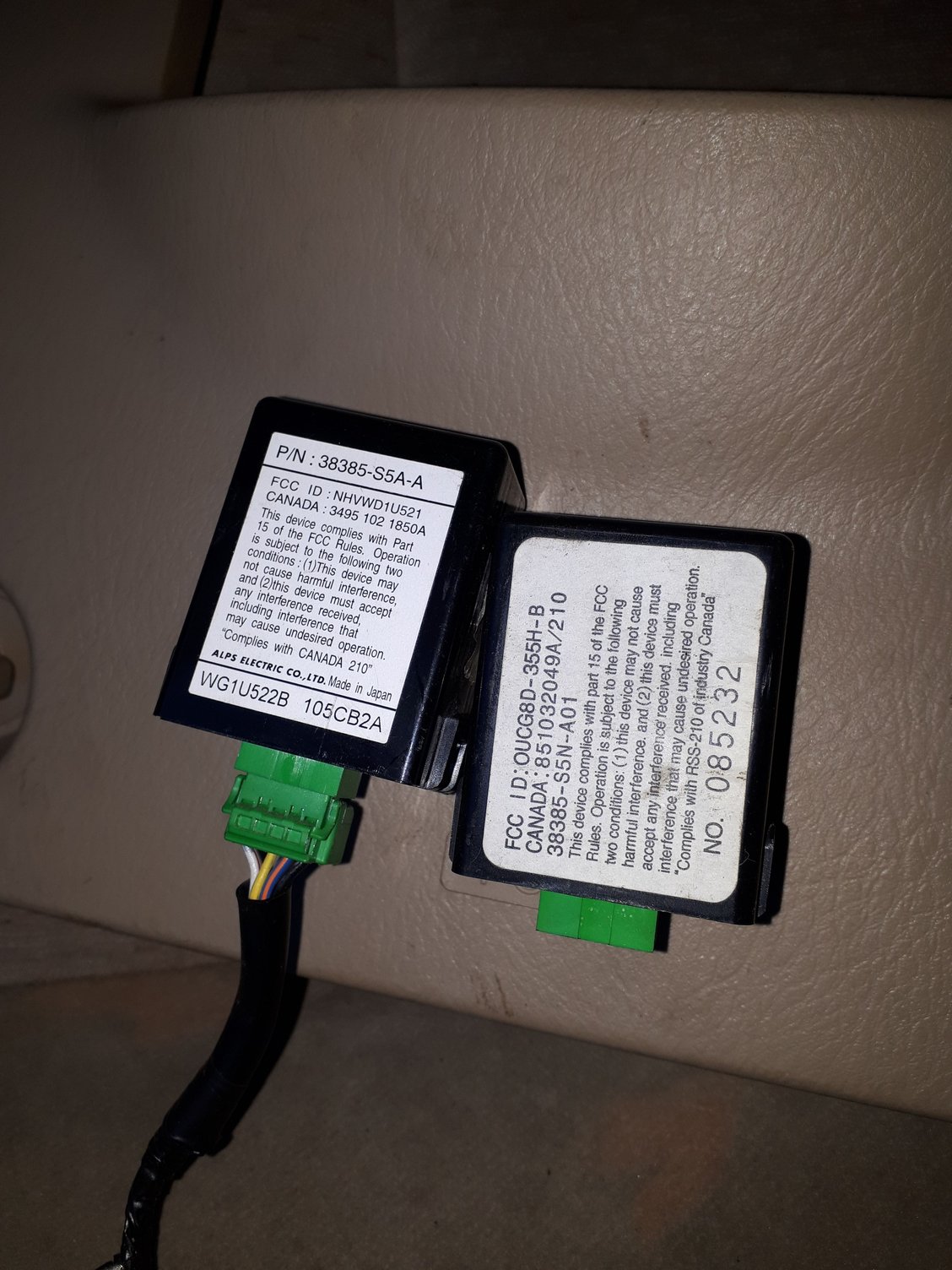

So i already got this one
Old Sep 2, 2018
Re: Key fob wont program in my honda civic
Did you get the remote fobs that match that unit?
Time for some creative wiring. Be safe about it though, don't want to burn the car to the ground
The green connector has 5 cavities but 4 wires.
Black wire #1 is ground
Blue/orange #2 goes to the single wire in the 2 cavity connector behind the power outlet panel. (also blue/orange)
Yellow/green #3 goes to power with key on and in start (originally was to fuse #20 in dash box)
White/red #5 goes to constant power (originally fuse #2 in the engine compartment but you should be able to find a constant power elsewhere in the car, the radio has a wire with constant power)
Old Sep 2, 2018
No i did not as i just get it from the junkyard. But i got a new remote that i got online and 2 old ones that my friend give me. Will it work.?

So i found the wire at the stereo. Just the wire at the on and start one
Old Sep 2, 2018
Justin04's Avatar
Joined: Dec 2017
Posts: 29
Justin04 is an unknown quantity at this point
Left one is from on line 2 with honda are from a friend but both are from different cars
Ezone got it working now. I just used one remote all 3 remote can be program . Thanks to you. It was not that hard to do it.
