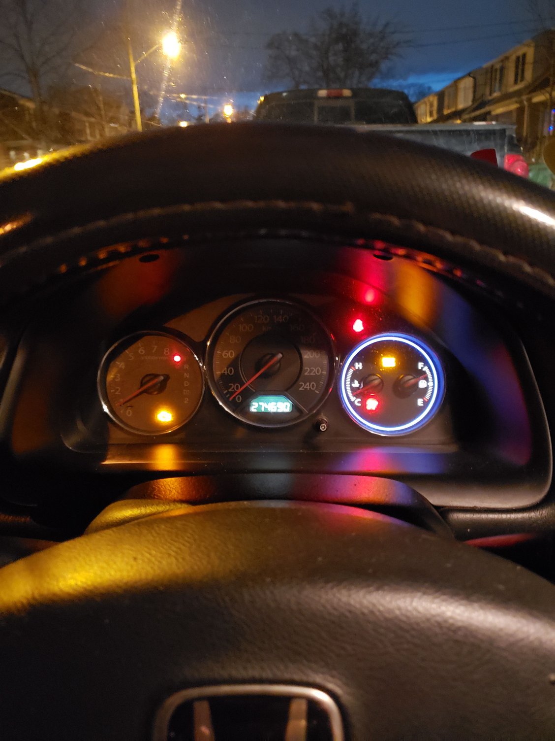

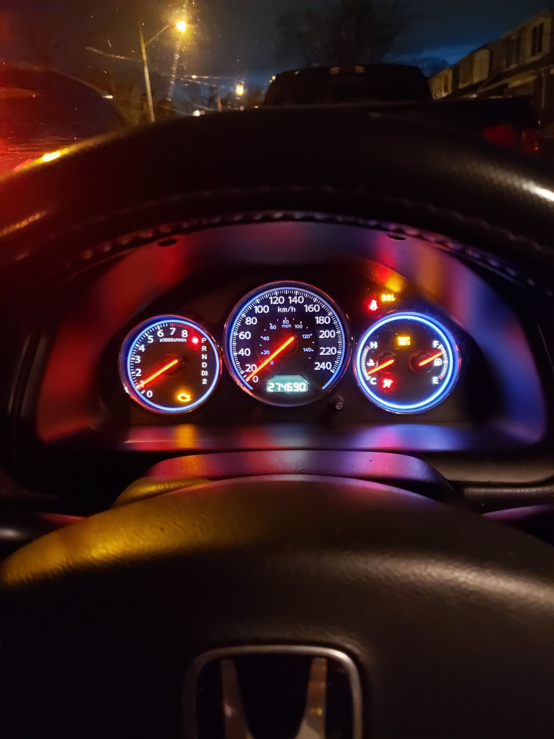

How can I fix it I got a new harness for the wires that run to the dash lights color to color all look good the fuse is good I put them pics that's how it is run with headlights on then off the aftermarket stereo was working just fine took it out nice an easy to put another one in and that's what happen my fob for my doors dont work the dome light dosent work unless the car is on help me please thanks

How would I fix that what would I need an also dose it make since cause if they where damaged why would they work when headlights are out then headlights turned on they go out

Yes I'm 98 % sure yes they are no power for the stereo an no dash lights once headlights turned on dm me I can show you pics step by step that I did
Old Apr 2, 2019
Justinp's Avatar
Joined: Apr 2019
Posts: 28
Justinp is an unknown quantity at this point
Re: 03 civic dx sport question
I need it fixed cause at night can not see my speed or rpms when the headlights are on

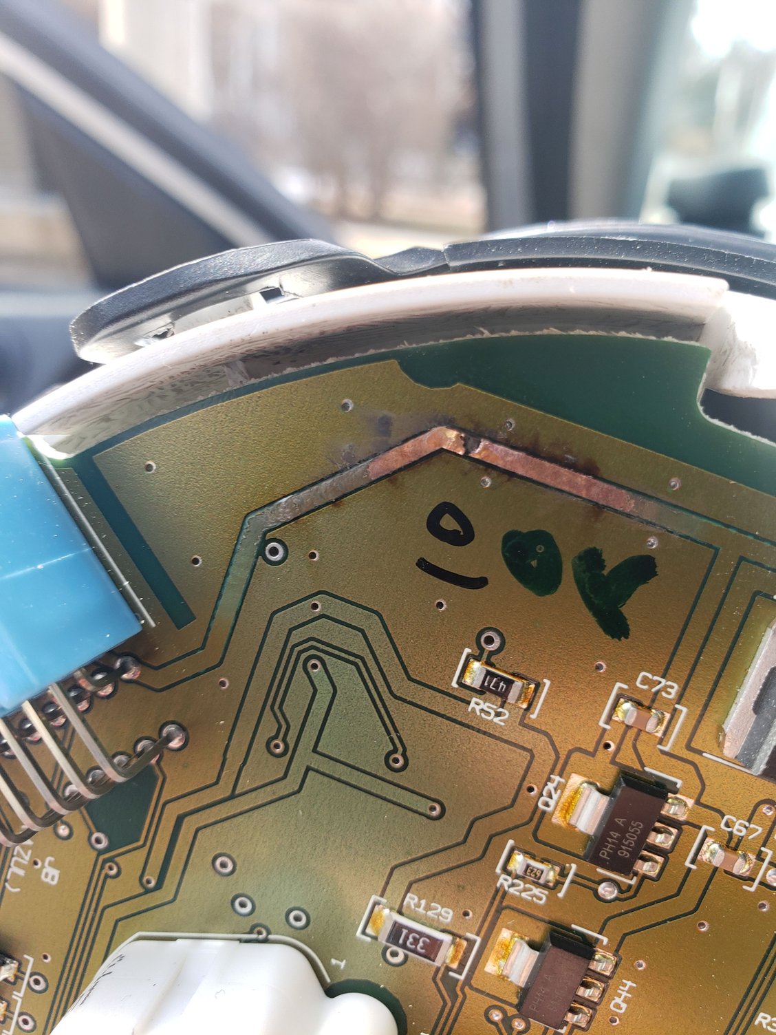

Thats that back where i dash speed and everything is behind the gauges could that burn spot be whats making everything not work an it smells burned as well ? If so then why dose some of it work
Old Apr 2, 2019
CraigW's Avatar
Joined: Mar 2005
Posts: 4,904
Likes: 14
Rep Power: 309
CraigW is a glorious beacon of lightCraigW is a glorious beacon of lightCraigW is a glorious beacon of lightCraigW is a glorious beacon of lightCraigW is a glorious beacon of lightCraigW is a glorious beacon of lightCraigW is a glorious beacon of light
That top wide trace looks like it's open.
It can be fixed with a jumper wire or solder wick if you have it. Solder it over the open trace.
That damage is from improper lighting connections made to stereo.
yeah that's clearly damaged, there may be other damaged areas as well

Dash cluster has a dimmer circuit that it switches too when the headlights are on.
Clearly that circuit is damaged, that’s why it’s changing state when you turn the lights on and off.
Is it repairable, yes, is it replaceable , yes, can you mount a led to shine on the instruments at night, yes.
You have made good progress, just decide if you want to eBay/Junkyard dive one or attempt to fix what you have.
What is a jumper wire ? Any wire I can use and solder it and so that's most likely what the problem is right I fix it everything should work ? And I'm pretty sure that's the only damaged thing on the back of that
You need a wire across open, something that solder will bond with.... and be easy, and quick with the solder iron.
Do you have a Radio Shack left nearby ( grab some resistors, and cut off the lead to use as patch)
