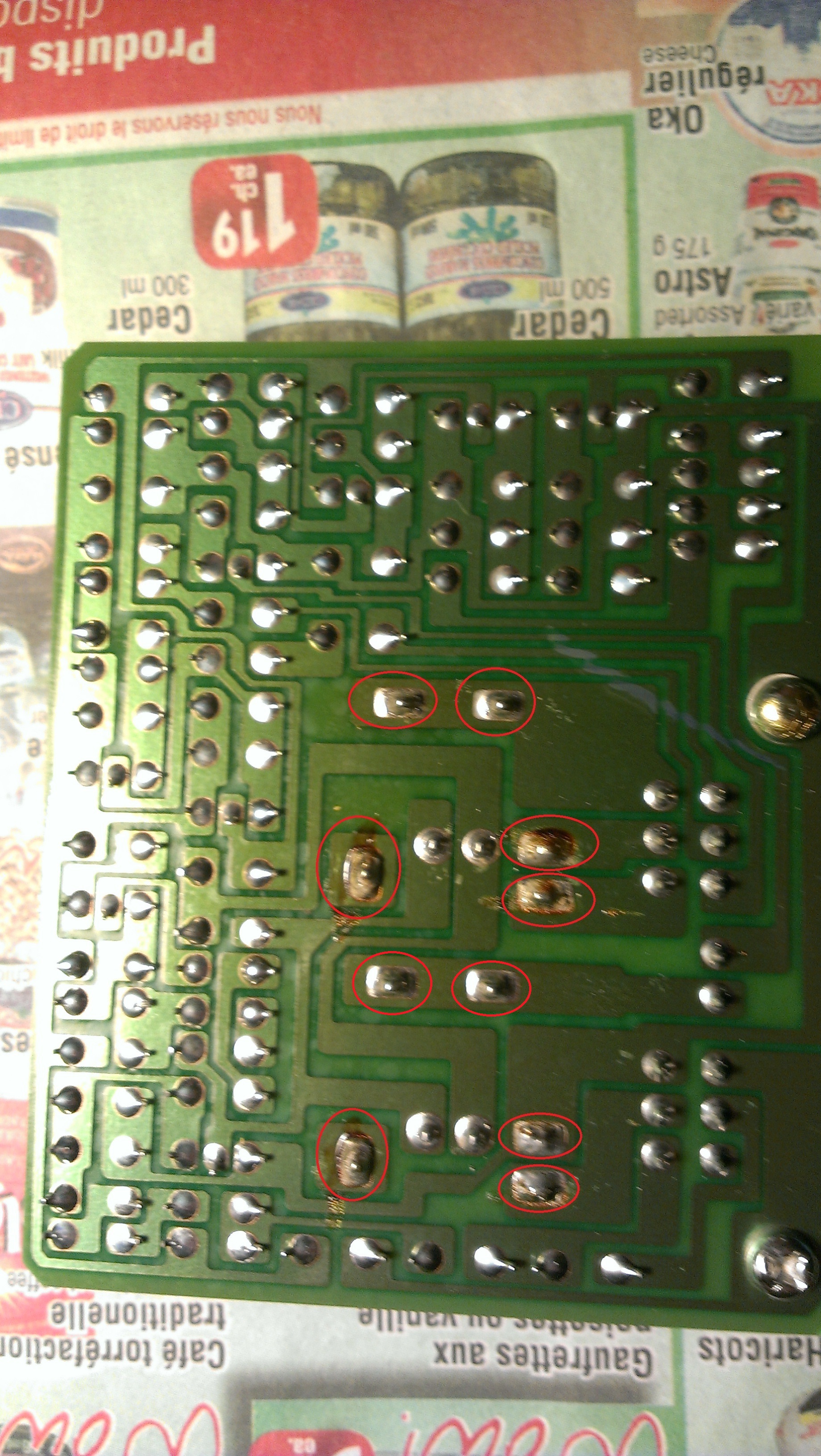

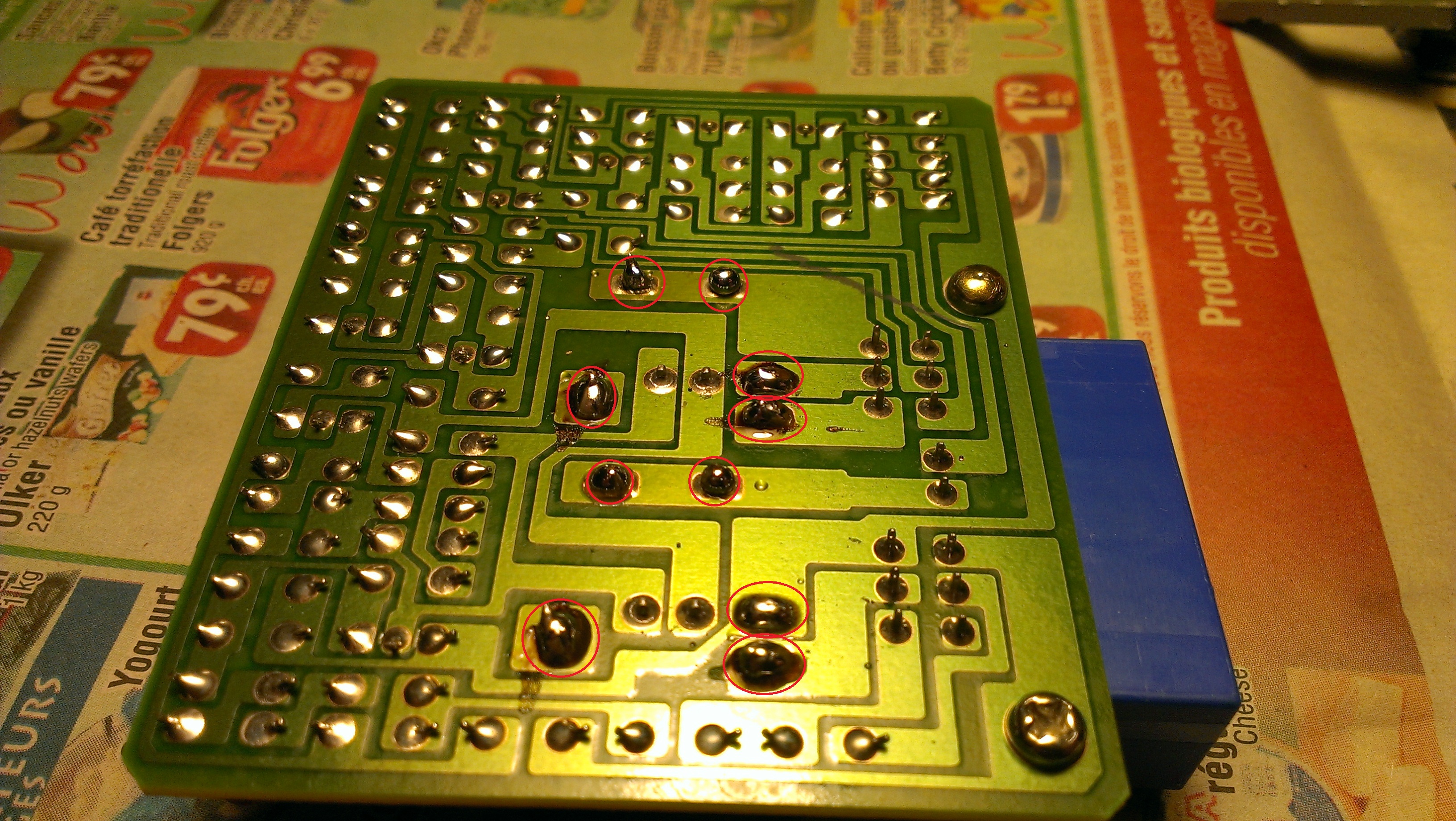

**solved** drl relay corroded solder joint
Here are some pictures, btw, how do you display the picture directly here instead of as an attachment?
I thought it would be a difficult job but it wasn't that hard, thanks to my recently acquired soldering skills.
